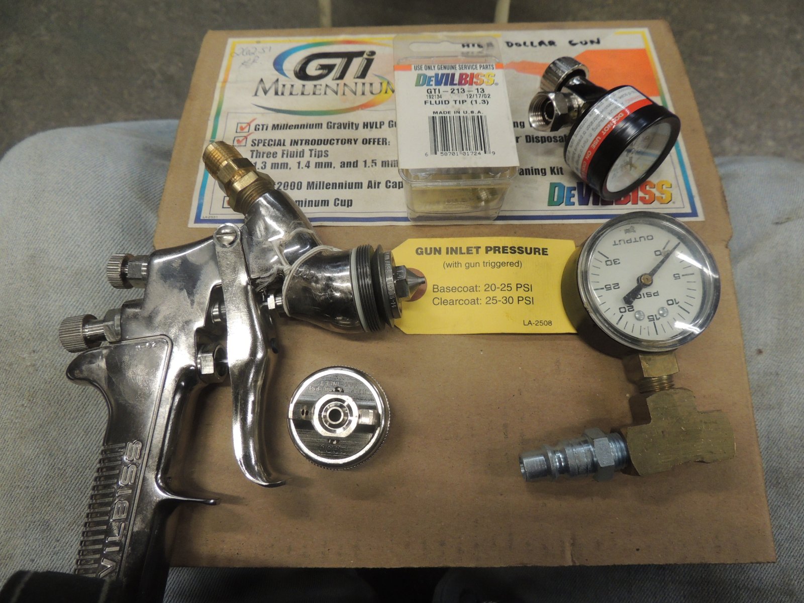

    I'd love to take you up on that. If you have a small job you plan to do sometime, maybe I can come and watch. The gun I have was bought quite a while back, when an expensive gun was $200-$300. I'm not above buying a better gun if I know how to use it somewhat.

  9. Yes Sir!
    That gun should do everything you would ever need when it comes to color or clear, because of the tip selection. It is a good gun that was just made quite a while back!
    You cannot shoot high build primer with those smaller tips, but honestly most of us that paint a lot don't ever use our good guns for primer anyway. The Tamco or Orion high build primers I use call for a 2.0-2.5 tip. I tried using a 1.8 in a pinch but had to reduce it a bit which kind of negates some of the build! You can shoot sealer & epoxy primers with the smaller tips as they are not meant for build.
    I bought a cheap gun off Amazon($39.00-49.00 I believe) after reading several good reviews on one of my paint forums strictly for my high build primers with a 2.3 tip. It works great for that, but it has no name on it & I can't remember what it was called in the ad so I cannot even tell others to buy it! LOL
