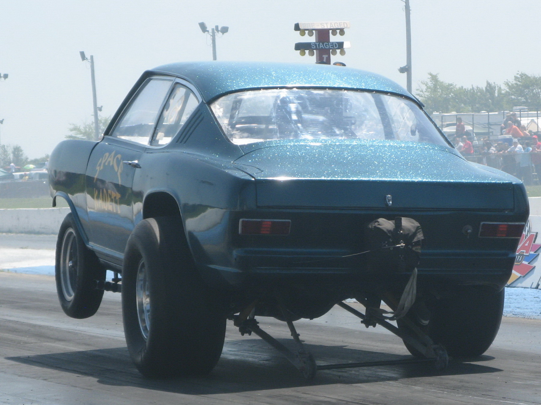

    i used paint with pearls flake on my car.they are pretty small{.004}but they were real easy to spray and cover with clear.after i did my car i looked at a friends car that he used HOC .015 flake and they looked the same but he had to do alot more coats of clear and alot of sanding in between.

    flat black base.3 tablespoons of flake in one quart of clear.4 total coats of flake with some crushed glass in the last coat{one teaspoon and the glass was .050}then three coats of clear overtop everything.one gallon of clear for flake and one overtop the flake

    i used paint with pearls flake.and the crushed glass was from my friend don moyer.im sure its really old but im sure there are people still selling it.

    no you cant sand between flake coats because you will sand the flake.the only thing you can sand is the clear after a couple of coats.then if you want to build it up more you can put acouple more coats of clear on it.

    I recieved my paint with perals flake, .004, man that sure looks small :D Was your Opel poppin before you sprayed on the crushed glass?

    Could you please post bigger pics of your car?
    Thanks.
