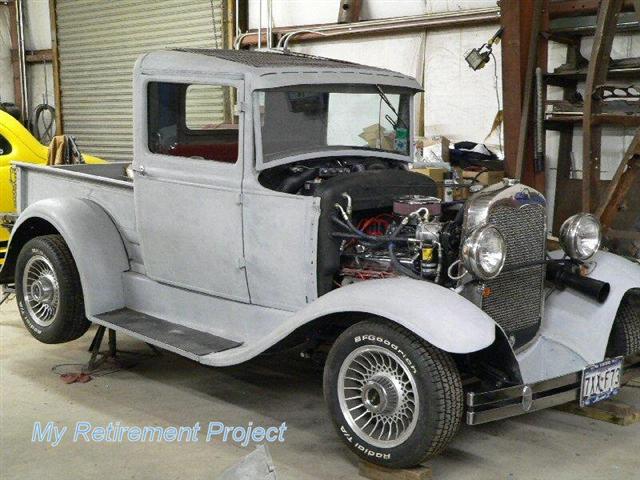

    I have a 1973 Camaro 350/TH350 with Edelbrock street/strip cam, Mallory Unilite Distributor, hot coil, hugger headers, and Demon 650 carb. I may need to replace my intake manifold. It is an Edelbrock, but not sure which one. What is your advice as to the best street intake for this beast? Maybe and Edelbrock Torquer or Edelbrock Victor, Jr.

    The engine is in a 1930 Ford Model a closed cab pickup. Isn't that tradional enough?

    ok back on subjec....how are you planing on driving the truck? stock engine? are you changing the carberation? trow us some more info.

    Rebuilt 1973 Chevy 350 V8 bored .030 over
    TH350 automatic trans
    Mallory Unilite Distributer and Power Filter
    High powered Summit Racing Coil and Ballast Resistor
    Summit Racing Ignition Wires
    High flow Summit water pump
    Mr. Gasket fuel pump
    Edelbrock Manifold with extra 1" spacer
    Demon 650 carburetor with K&N filter setup
    Its A Snap wiring harness
    Edelbrock Street/Strip cam
    Hugger headers with Thrush Cherry Bomb mufflers
    Fully boxed frame with engineer designed k-member - frame extended in the rear
    Front and Rear bumpers
    BF Goodrich radials all the way around
    4" dropped tubular front axle
    1" dropped front cross member
    Vega steering box with cross steering
    1990 Chevy S10 steering column and wooden steering wheel
    MP Power Brake Booster with Corvette Master Cylinder
    Power disk brakes in front and power disk brakes in rear
    Tubular shocks in front and coil over shocks in rear
    Genie floor shifter and emergency brake
    9" Ford rear end (2.91 to 1 ratio)
    Triangulated four bars in rear and hair pins in the front
    Walker Cobra AC radiator (with condensor)
    Electric fan with Vintage Air Trinary switch and adjustable fan temp switch in radiator
    Vintage Air heating and air conditioning
    Lincoln mag wheels
    '32 style gas tank under bed
    All steel - all original except side aprons.
    Will have the original type black top and black rubber on the running boards.
    Original headlight buckets with modern sealed beam bulbs (hi/low)
    Front and rear turn signals
    Original headlight bar and horn (6 volt with reducer)
    Recessed firewall
    Wooden ammunition box in bed for battery, tools.
    Model A seat done in red plush
    Overhead console inside with Blaupunct AF/FM radio and cd with two five inch speakers, also has overhead lights
    Electric windshield wiper on drivers side
    Classic Instruments gauges using the original Model A dash bezel
    What else turns you off? I know, the A/C. Well when you live in central Texas and are 64 and the wife says she won't go unless there is A/C ...

    after looking at all that, i'd really recommend the performer RPM for that. with that combo you really don't wanna go with an open plenum manifold, dual plane will do you much better. since it's a relatively light car, the 2k and up power range of the RPM will really wake that baby up though that does depend on your rear end ratio. i'm guessing that you're probably around 9.5:1 compression which is good for that cam and oughta make good vacuum to run those accessories. since that is a demon carb though you'll wanna be careful if you go with the air gap because as was mentioned before, they can hurt atomization and it's easy to go overboard with those carbs. other than that, it seems like a well thought out build and who cares about the AC. i'd have it too if i lived there.

    Thanks for the compliment. I have been working on her for three years. A couple more months and she will be road worthy. I think you are right, the Edelbrock Performer RPM looks like the best choice. Now to find a used one. I am working on a shoe-string like many others. Thanks again.

    you need to ask yourself how you want to drive the truck. be honest. are you going to keep the rpm up high enough to take advantage of a single plane intake? (hint...the answer is no...especially with 2.91 gearing). you want a dual plane manifold that makes low end torque, good off idle throttle response. you don't want a 400 hp high revving engine. i doubt if any mill in that light truck will ever wind above 4500. especially at your age. build a torquey little motor and have fun ripping around town.
