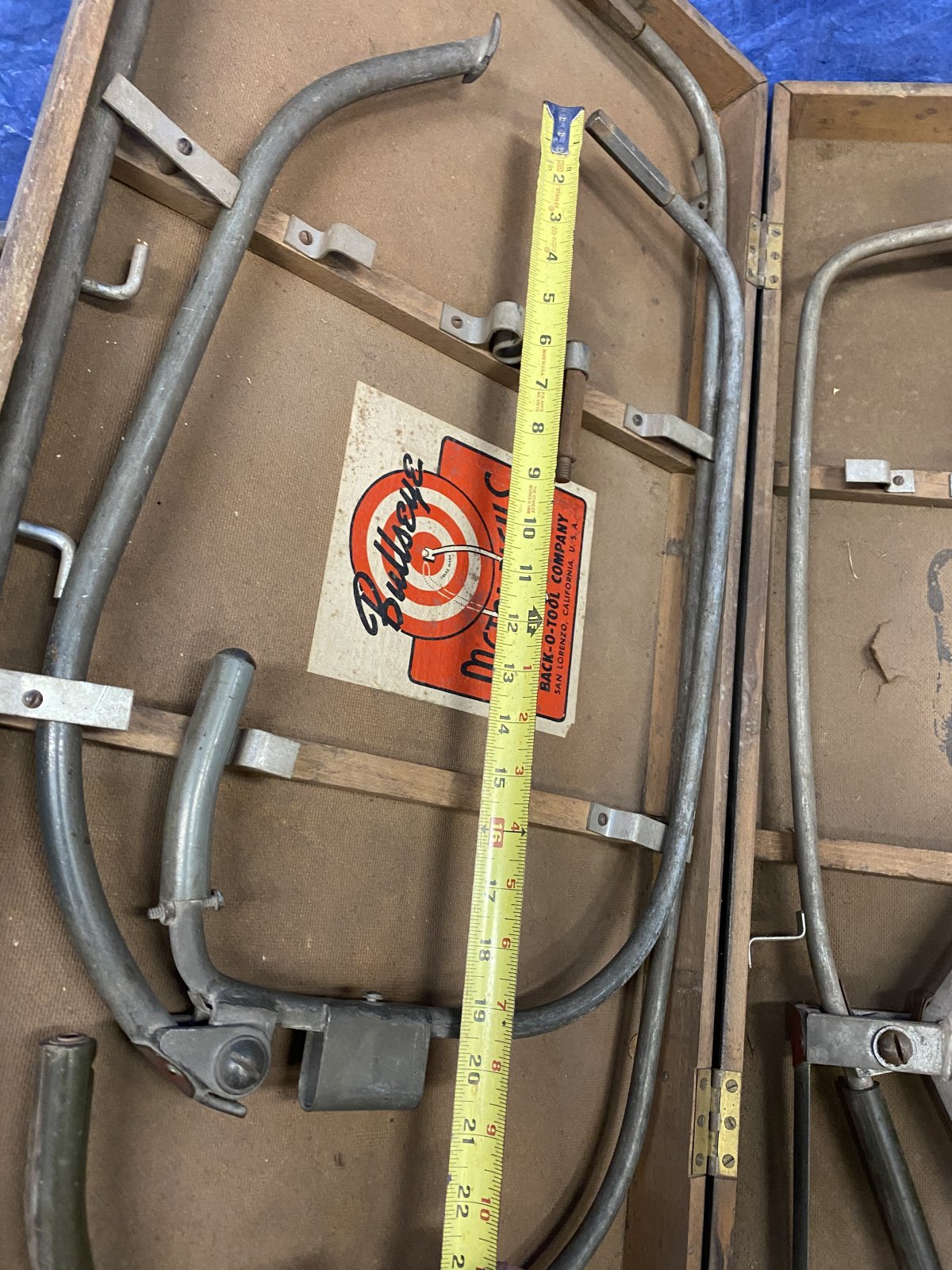

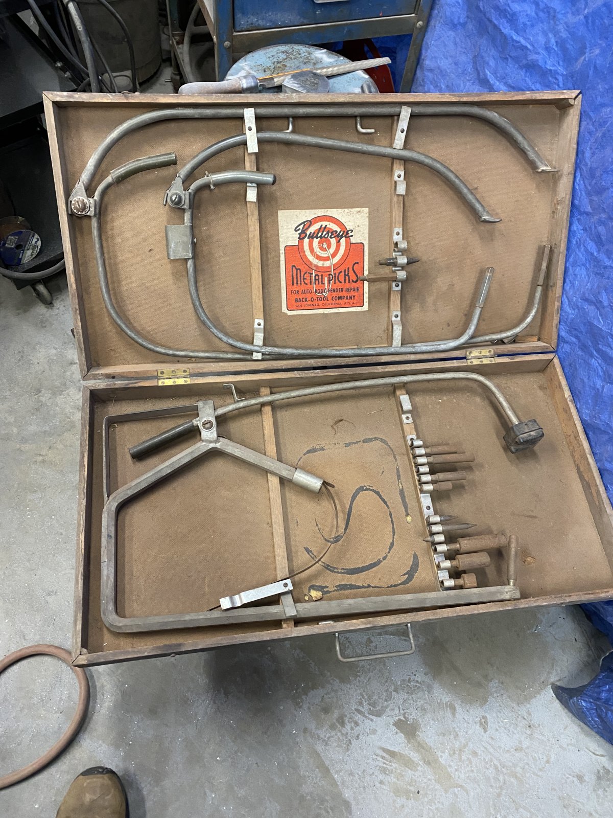

    Here’s my set in the original case. I’ve only ever used the smaller hammer, about 18” deep. It’s a very handy hammer to bring up small spots, especially after welding a joint. Not for major metal moving, just for fine tuning.

    @alchemy
    What are they made out of? 1/2" tube ?
    Always thought about building one.

  24. Yup, just tubing

    Mine is made of 1/2" solid rod, not a lot of weight behind tubing.

    Mine are light weight. I’ve never measured the tubing size but I know the arms are hollow. The umph is all in the head. As I said above, they are not for moving big dents, but more for fine finessing.

    What do the different heads and tips look like?

    A variety of longer and shorter, with pointy or blunt, and medium width or wide.
