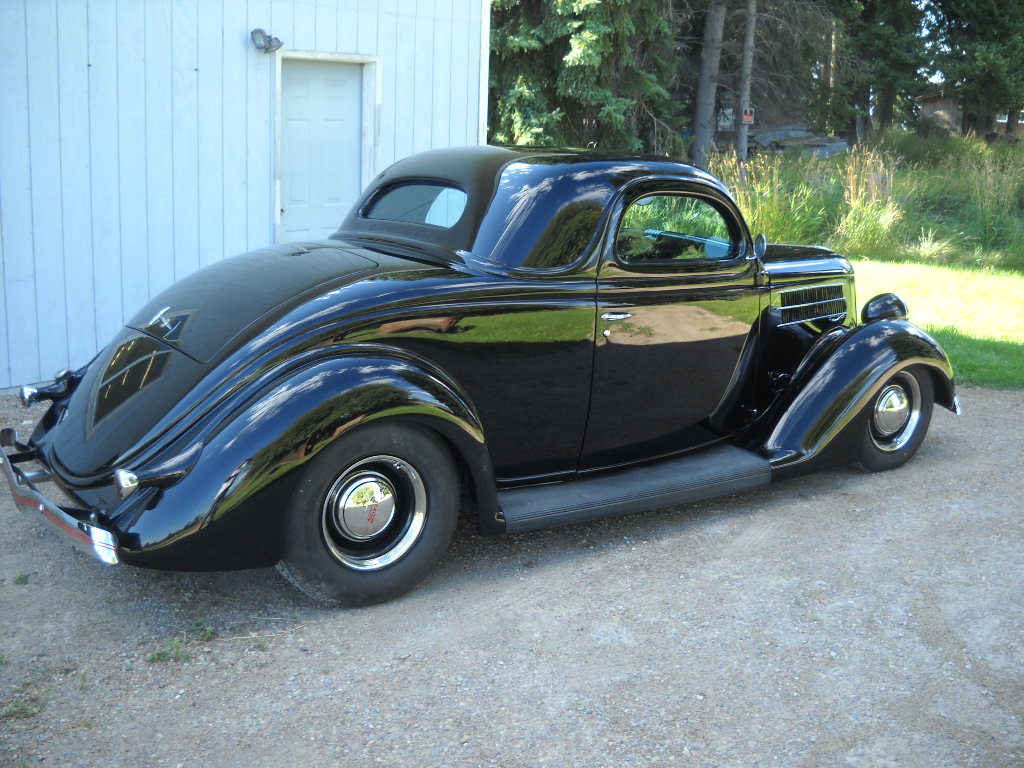

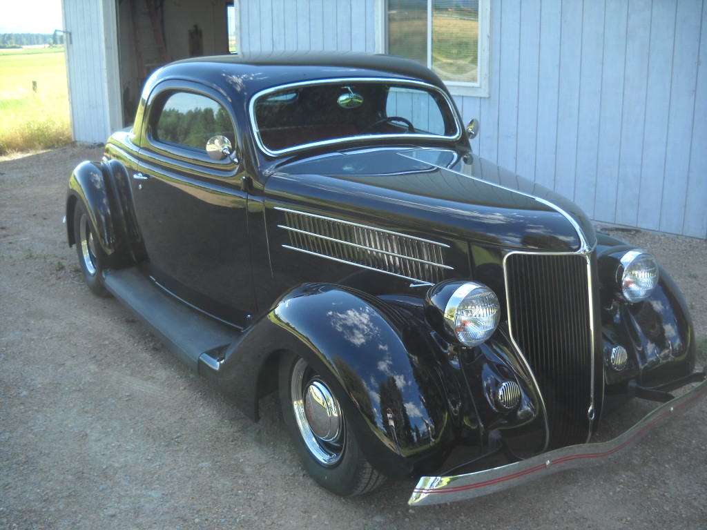

    Definitely! Thanks for your input. I've seen some nice chops that sit way too high, and some ugly chops with a perfect stance.
    Hopefully I've got all the other factors covered, just need to get the chop spot on now...

  10. [​IMG]
    Man I really like this. A bit of a haircut and it’s perfect

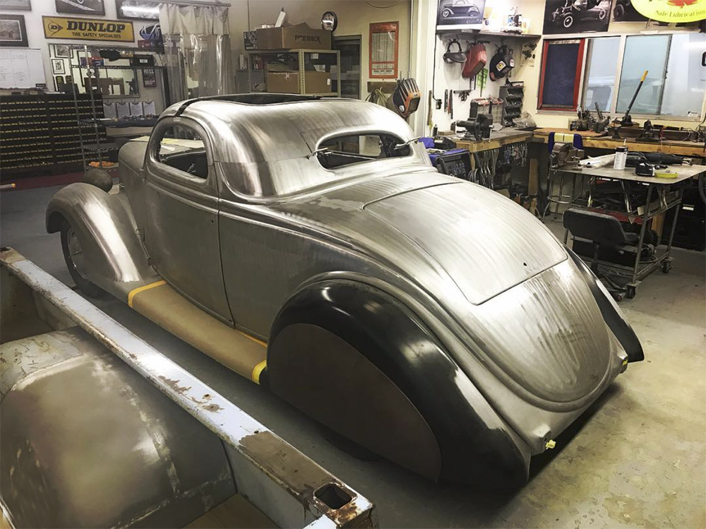

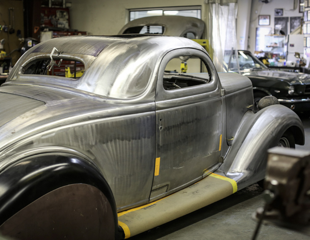

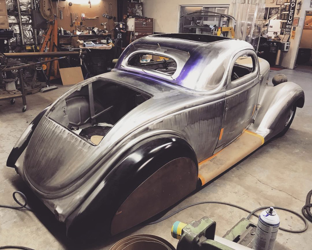

    Bryan Rusk's being chopped at East Bay Speed and Custom 2v2JcH5kqx2Kus1.jpg 2v2JB58WNx2Kus1.jpg 2v2JB58Grx2Kus1.jpg 2v2JB58njx2Kus1.jpg

    Nice!!! Was this cut low on the rear pillar or half way up? Has the back window had a full 2 1/2" cut too?
    Bear:)
  16. RMR&C
    Joined: Dec 26, 2009
    Posts: 4,940
    RMR&C
    from NW Montana
    It was cut half way up, real similar to the coupe in K13's post above. Yes, cut through the rear window.

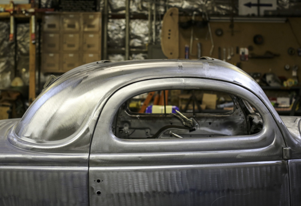

    This is getting pretty close to perfect! I read somewhere that it's cut 2 3/4" front and 3 3/4" rear, and what looks to be a little bit less out of the rear window. Looks like the cut line halfway up the rear pillar. That one inch differential from front to rear seems to neutralize the taper in the side window.
    I've had mine marked out at 2 1/2" front and 3 1/2" rear for a couple of weeks now and this one makes me feel like I'm on the right track.
