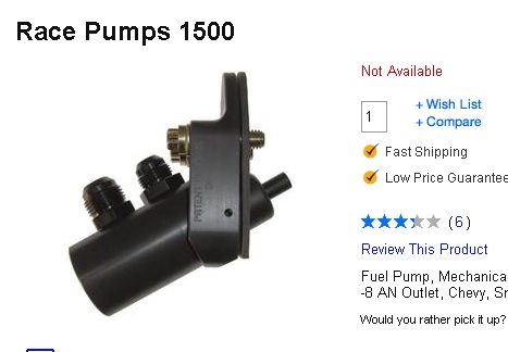

  9. squirrel
    Joined: Sep 23, 2004
    Posts: 59,206
    squirrel
    that's a transfer pump for a Cummins diesel, isn't it?
  10. squirrel
    Posts: 59,206
    squirrel
    that one is also not available
  11. CARQUEST says its for SBC
  12. It is if you call or they will tell you who handles them.
  13. squirrel
    Posts: 59,206
    squirrel
    huh, it looks just like the pump for a Dodge diesel.
  14. OK Jim ( @squirrel ) called CARQUEST first and they confirmed that while their site showed it for SBC is indeed for Cummins diesel and do not know why it came up on a search for SBC.
    Also called Summit they said that they no longer handle the pump but that Race Pumps no longer manufactured it and it was a quick fuel product. They referred me to Jegs who said that it is no longer available.
  15. Anyway sorry for the confusion. :oops:
