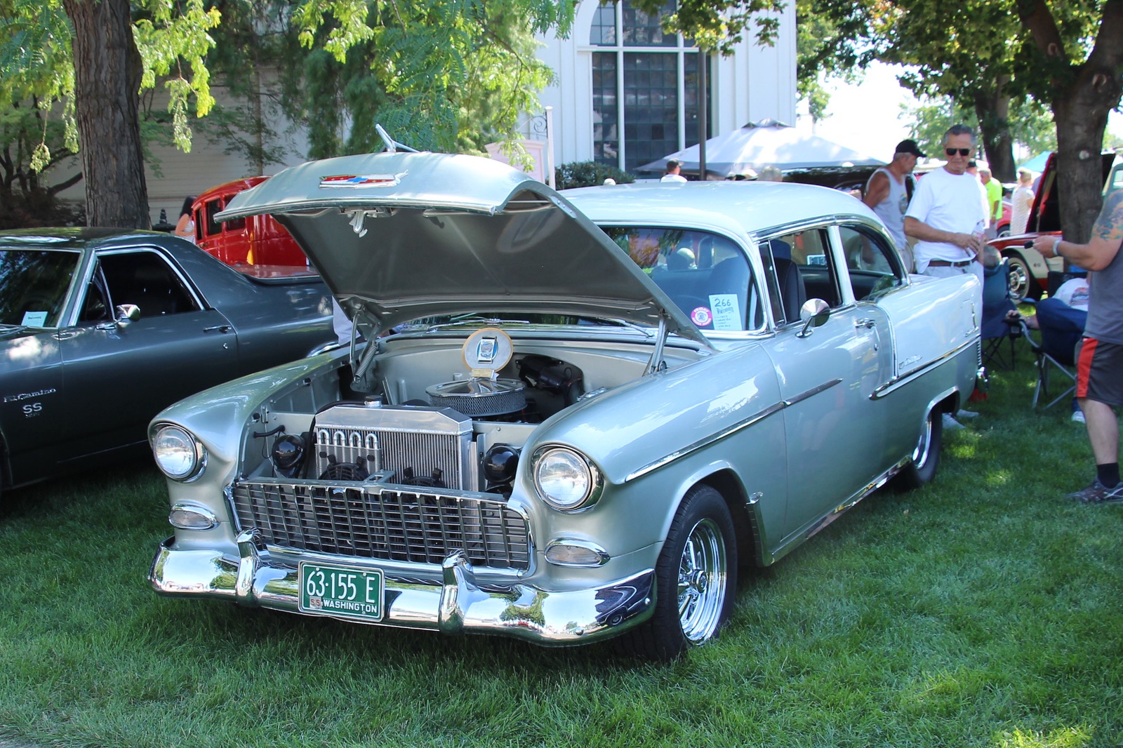

    Mr48chev
    I don't know if his daughter will have Phil's 55 at Vintiques this weekend or if she still has it but it has the widest tires I have seen on a 55 that I don't believe is tubbed. Built from a hulk that he pulled out of TeePee auto wrecking a number of years back and as nice a 55 as you will find. He p***ed away a few months after I took the photo. Phil Raspberry 55.jpg

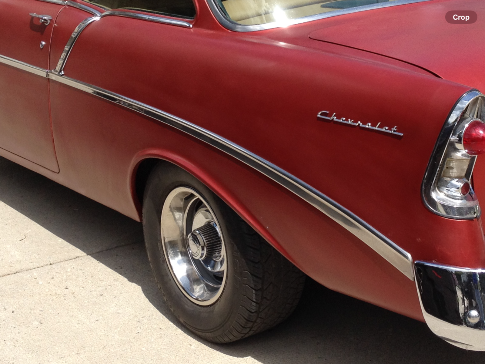

    lumpy 63
    20240802_151454.jpg my 56 I had when I was 19. 15x8 corvette rallys with L60 15s
