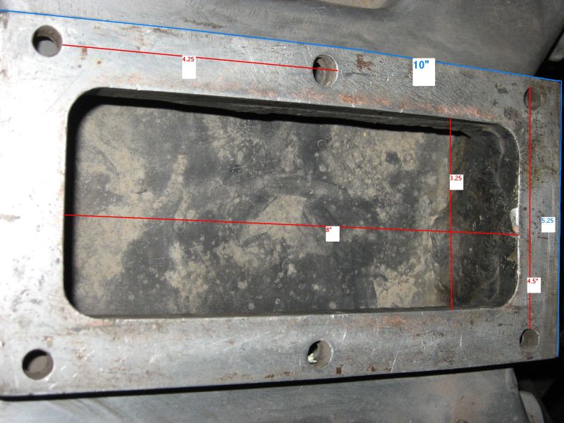

    Here is a blower flange that I am trying to ID. I think that it may be for a S.C.o.T. supercharger, but I can not find any flange dimensions. Maybe for a pruned 4-71? This flange looks bigger to me than the S.C.o.T. flathead setups. The flange is 5.25"x10" on the outside. 1" flange, 3.25"x8" inside. Vertical holes are 4.5" center to center and horizontal are 4.25" center to center. Anybody with an S.C.o.T. base gasket that they can check?

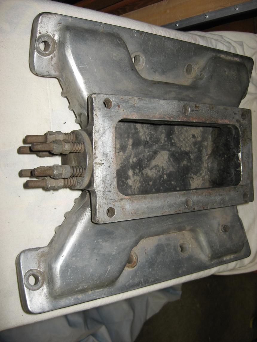

    This is a picture of the manifold, where the blower base would sit and be bolted down.
  4. I realise that. I also realise that some manufacturers did that. Without seeing the intake as a whole, no way to tell how modern or old it is.
    Was just offering up a suggestion ;-)

    There were different size SCoTs, for different size engines.
  6. Looks simular to the one on the S.C.oT. I have on my 331 Caddy in my 40 coupe. Just got back last night from Alaska. Have an original S. C. oT. top plate for 2 Strombergs that came with my setup, will go out this morning and get it out and measure it, post a pic if I can figure out how.
    I fabricated a top plate to mount a Crager dual 4s to a 471 adaptor, used 3/8 alum. Milled the Crager about a 1/4 in on the top and bottom for hood clearance. Still running that setup today. The one you show looks the top of mine, base was a little smaller.
    Hope to have the 40 at the CHRR in Bakersfield next month. You going down for it?
    Am going to be home for awhile now, so go ahead and ship all the stuff back when you get a chance. Later Davey
  7. My S.C.oT. base bolts are: 6in c/c f to r (center bolts are on 3in c/c) and 3in c/c side to side. Measurements are aproximent as its tough to get to them.

    That's really close to what a pruned 4-71 case would be. Bottom flange is roughly 9.5 x 5.25 outside, and 7.5 x 4 inside. And you would be drilling your own holes in the blower case so... it's really close. I could give you better dimensions if I had a gasket close, but I'm just pulling these numbers from a quick sketch I did so I could search through the s**** pile for aluminum plate.

    Thanks for checking that. I figured that this was larger than a S.C.o.T. and your dimensions confirm that. I believe alchemy to be correct in that there were different sizes, but I thought the largest ones went on flatheads? I think that there was a Rodder's Journal artical a year or so back that covered the Italmeccia (sp?) S.C.o.T., Pepco, etc superchargers that we available in the early 50's. Anybody know off hand what issue that was?

    Thanks Kevin & CW- that was great info! I would have to say that this is probably for a pruned 4-71 based on those dimensions. The spacing on mine is almost identical to yours CW, with the exception on you having 8 mount points vs 6 on the picture I posted. Seeing as the case has to be drilled for the studs anyway I can see how there would be variences. Looks like it is time to find a 4-71 to start cutting on. I'll have to reread all your posts Kevin. ;)

    Not the best of pictures, but you get the idea. It s going to need some work to clean it up a bit, but these don't come along that often. It was polished at one point in its life and the "Tom Beatty" name was removed. That is OK though, it matches the Beatty snout I have, its had a hard life too.
    Now I have to find another 4-71 supercharger so I can prune it!
