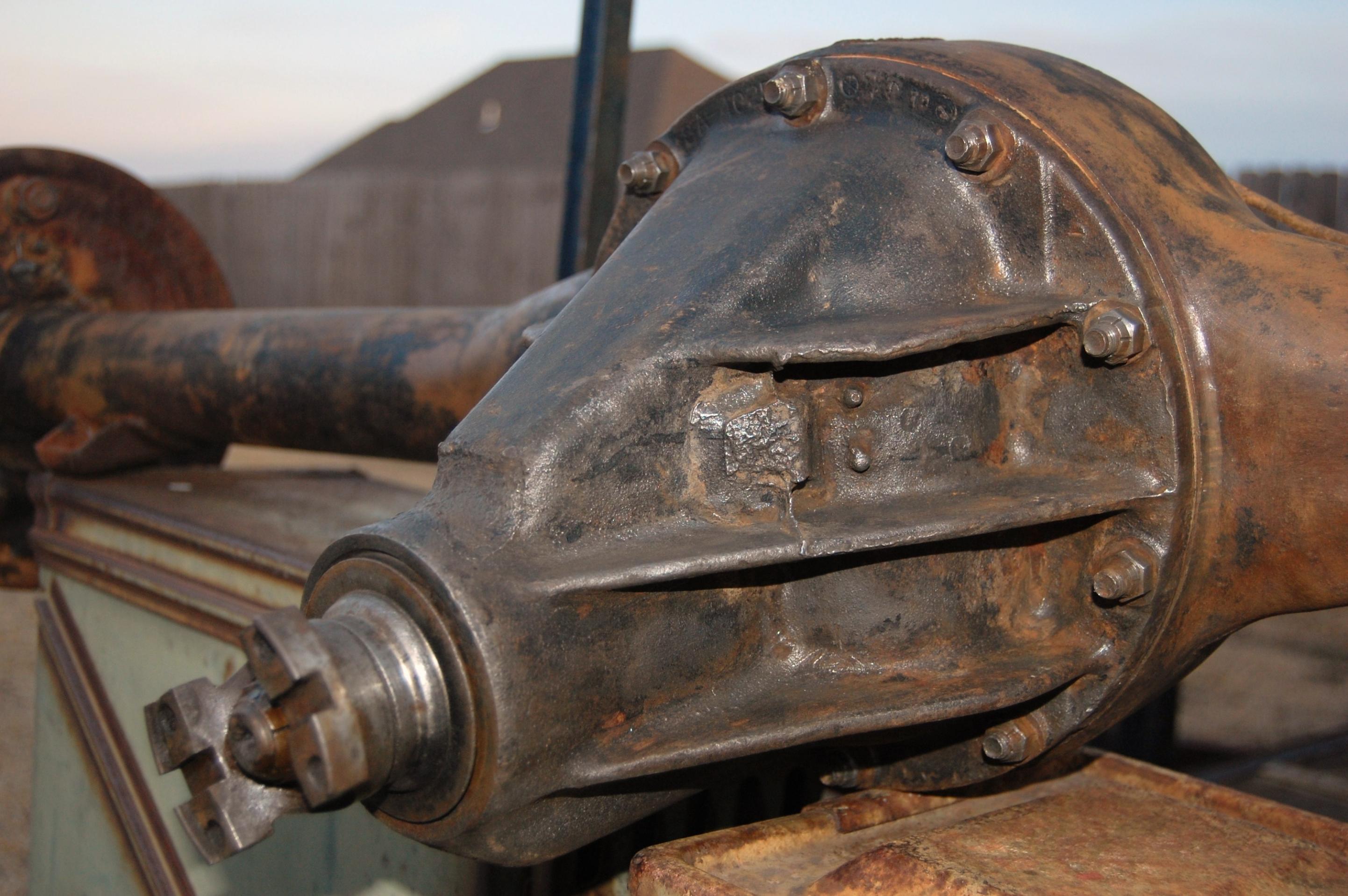

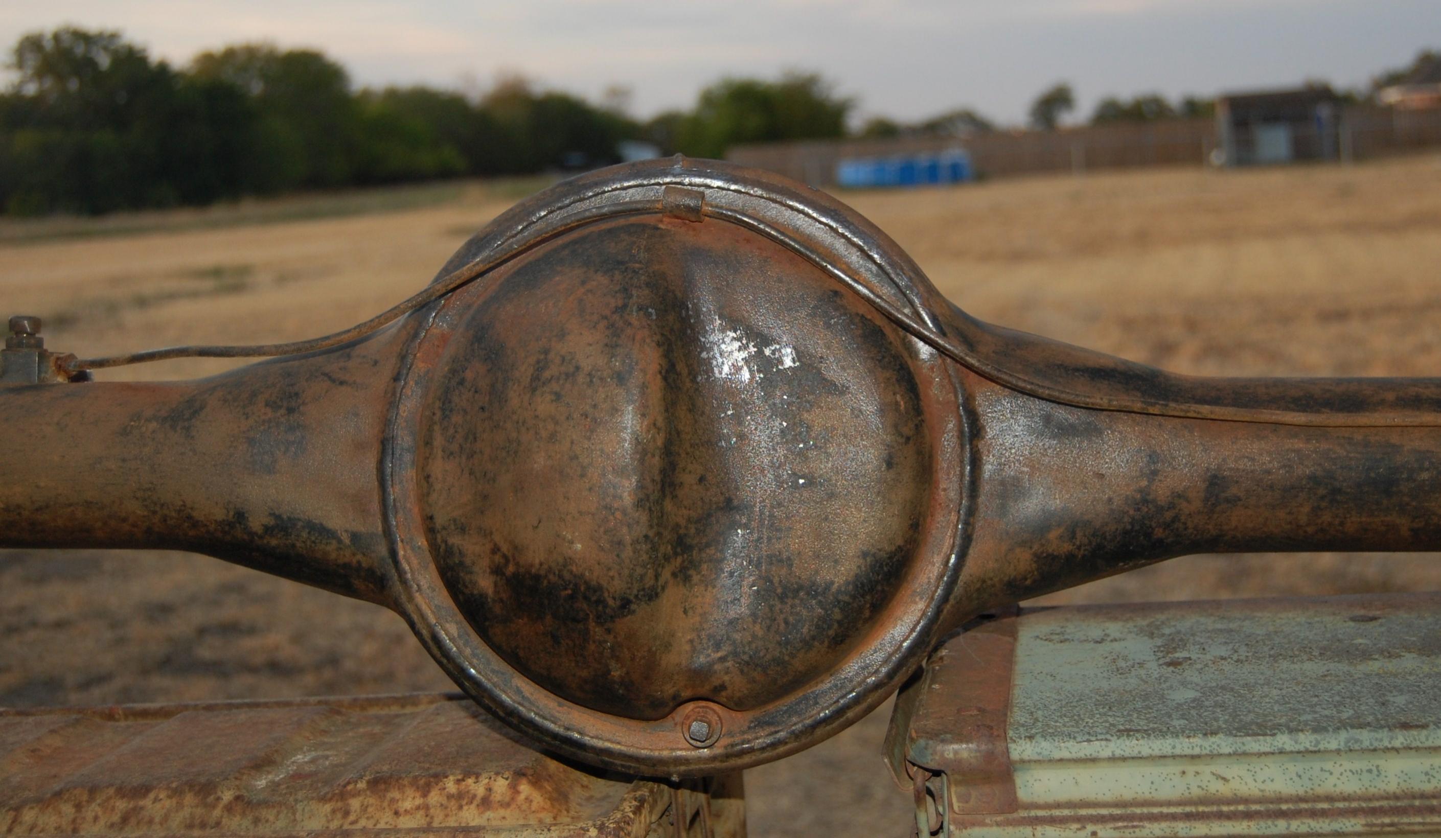

Ive tried to look in the Tech archive and searched "Ford Rearend" on here and no real answer. I think its a 8" Ford. I was told it came off a '50 Ford sedan. I want to know if it's worth using or should I junk it. It was a freebee. It has 10 bolts,52" from brake flange to brake flange,and 8A-4025 on the top of the pumpkin,and 10-41 430 on the bottom of the pumpkin. Any ideas??
It's a 49-51 Ford. Not an 8 or 9 inch. Just a rear end, nothing special or desirable. Unless you get rid of it, then you'll need it all of a sudden. I think, THINK that 8A decodes 1949.
yup, that's the Ford rear that they made before they invented the 9" in 57. 49-56 ford rears are mostly similar. although they used some Dana rears in trucks and wagons.
While not known to be really stout, it was adequate for all the Fordilacs, all the Fords up thru the '56 292s, and a whole lot of other engine conversions thru the '50s. If you try hard enough, you can tear up anything. Likewise, you can avoid shelling transmissions and rearends by prudent driving.

I had a lot of Fords that used this rear and now have a '54 Ford with this rear hooked up to a 302 & AOD I never lost one and beat on a lot of them pretty hard,sorry no posi was ever made for them.

The weak point on these rear ends is the u-joint (pinion) yoke. Ask me how I know???? 800 miles from home........
Thanks for your input guys, and for the knowledge on the posi. I plan on driving it more than really ragging on it, but I'd like to step on the gas from a standstill once in a while. I guess if I decide to rebuild it, I'll just have to make sure I'm only a brute when I'm close to home... Sorry to hear about your bad luck! You're the second guy to warn me about the pinion yoke on these. If I look into rebuilding, I'll have to see if there's a way to beef it up. Just out of curiosity, when you broke, did you replace the rear with something else altogether? As in, do you still have the same style rear, or something new?
I broke mine 48 years ago. When the yoke broke, I lost the driveshaft and the aluminum case of my new T-10 (an expenssive loss at 17). Before that I lost a couple axles....I 'd say the weakest element. My opinion is its not worth thinking about with Ford 8's or 9's and good axles so easy to come by. Good luck
