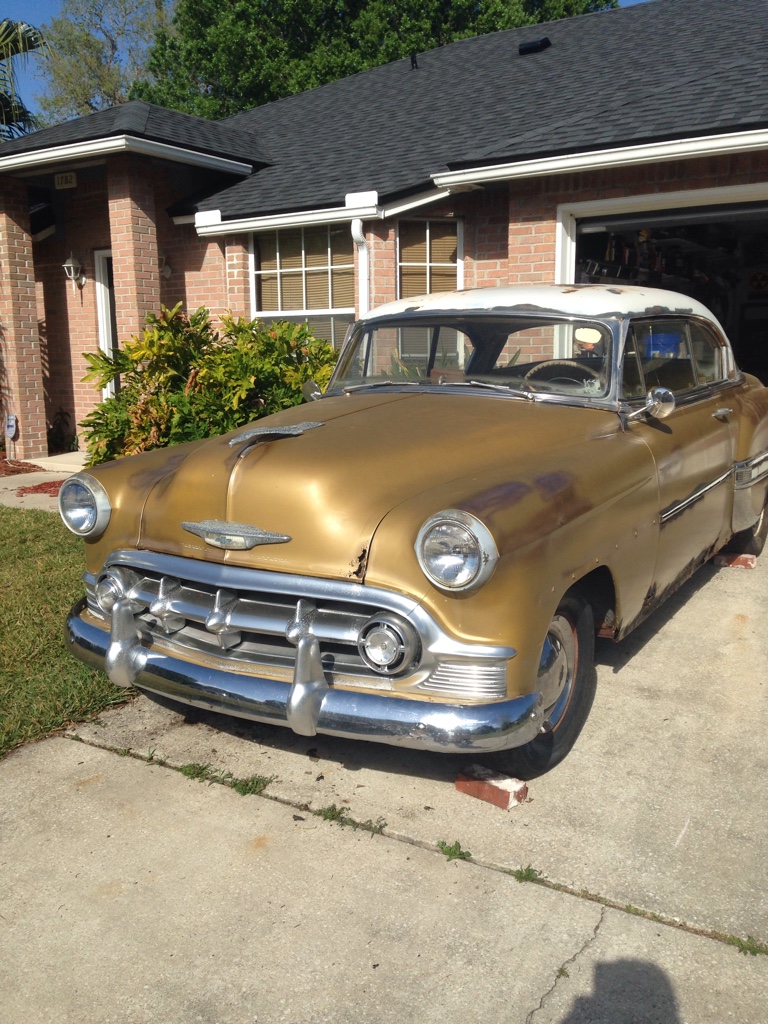

    I bought this 53 Belair that has not ran in quite a few years. Today I began pulling plugs to clean them and put some marvels in each cylinder. All the plugs looked the same, black like it was running a little rich except for the #2 cylinder that was pretty clean. The plugs looked fairly new, the oil looks new, and it appears someone took care of this car. Any ideas what is going on in the #2 cylinder? I have not tried to fire it yet, just cleaning all the systems before I try. [​IMG]
