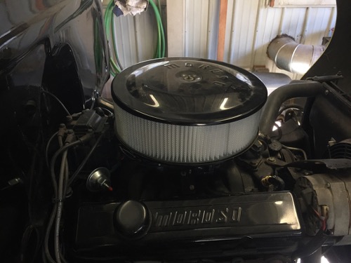

    Like the title says What is your experience with Holley Sniper TBI? I put one on my 49 Buick with a 472 Cad motor. Haven't run it much yet to let it learn, so just wondering what others outcomes were.

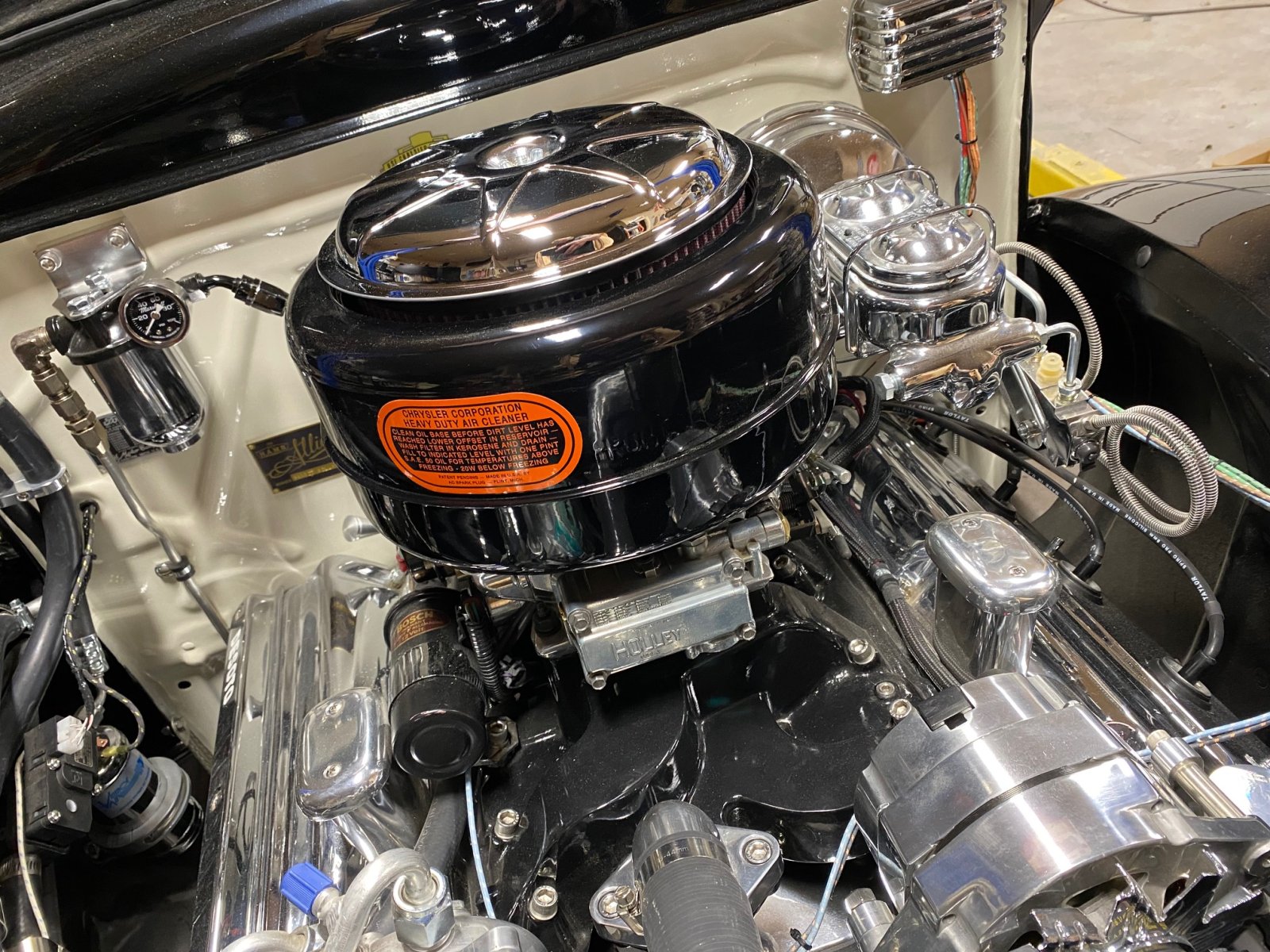

    I installed Series 1 Sniper on the wife's PU. That's it hiding behind that fuel bowl I added. It is possibly the finest piece of engineering I have ever played with. Being built by Holley, it talks to the MSD (plug-n-play) distributor, tuning both as I drive once the engine hits 185 degrees. Throttle response is FAST! It started on the first crank (new engine, new everything) and did the 20 minute burn without blinking. I drove the truck yesterday again and is so effortless. No pedal to start, no cranking, no exhaust smell, no hesitation, tidy 700 RPM idle...seriously why not?
    Holley tech was outstanding! I had incorrectly entered "engine with coil" in the startup wizard, since it has a damn coil. The truck would not start at all. It tried but would not stay running. The tech figured out that the setting needs to be "timing box" so it would talk to the distributor, and it has been perfect ever since.
    Series 2 uses your smart phone to tune rather than the handheld LCD screen that I mounted on the custom dash I built. I worked hard to hide the wiring harness and the ugly TBI, but in the end I am quite pleased with the install.
    Would I install it in an open fender Hot Rod? Nope. But the PU? It is nearly invisible.

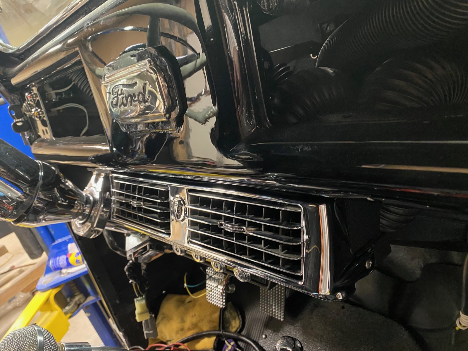

    This is the dash I built hide my electronics
    This is the Holley LCD panel and the electric vent switch. Hee hee.

    That looks great with that big ol breather and that fake fuel bowl on there. No one would probably ever know it was efi if you didn't bring it to their attention.

    Only a couple guys on here saw that over the last few years and asked "what the hell carb is that?"
    I don't like showing off the new stuff. But I'll use it and bury it. I just don't want to look at it. Hiding tech is an art form. It even has a "choke" as this side was butt ugly! This pic has the ground lead, I added the red power lead as well. Clearly a Sniper when I zoom in (throttle sensor harness). You can see the aluminum bracket under the front carb studs securing the fake fuel bowl. The "choke" is mounted with 3M double sided tape.
    "The eye sees what it wants to see" (scotoma). Not a new art form. Centuries old actually. I just adapted it to classic cars.
    And the coil? MSD red coil, painted black and a Bosch sticker I found on the internet, mounted to hide the TBI.

    Very clever.
