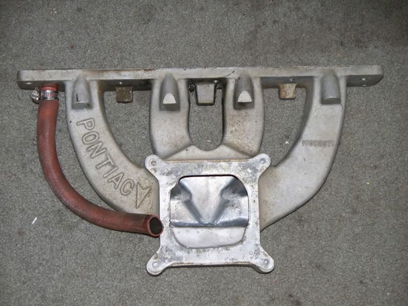

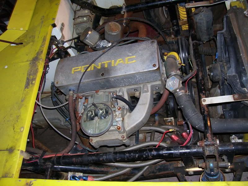

    I'm new here but I love inline engines. I read thru this entire thread and no one has mentioned my favorite. The Pontiac Super Duty 4 cylinder. Basically the racing version of the Iron Duke. They have a bunch of different cylinder heads. A couple cast iron ones, I think 3 aluminum ones and a DOHC version if you could ever find one, but they are out there. You can get all kinds of intakes as well. From a 2 barrel to a 4 barrel, Side draft, ITB FI, even a dual quad set-up. The blocks are much more robust. There are 3 basic cranks. A 2.5L, 2.7L and 3.0L but if you bore the engine out 3.3L is possible. And the beauty of this engine is taht all the parts interchange with the Duke. The engine was made to race in the Fiero In IMSA and the rules stated it had to be production based. Pontiac made it so you could get them right from the dealer. These were also used in Midget racing, In race trim they could put out around 450hp and rev to 8500rpm all day long. Here is some of my parts.

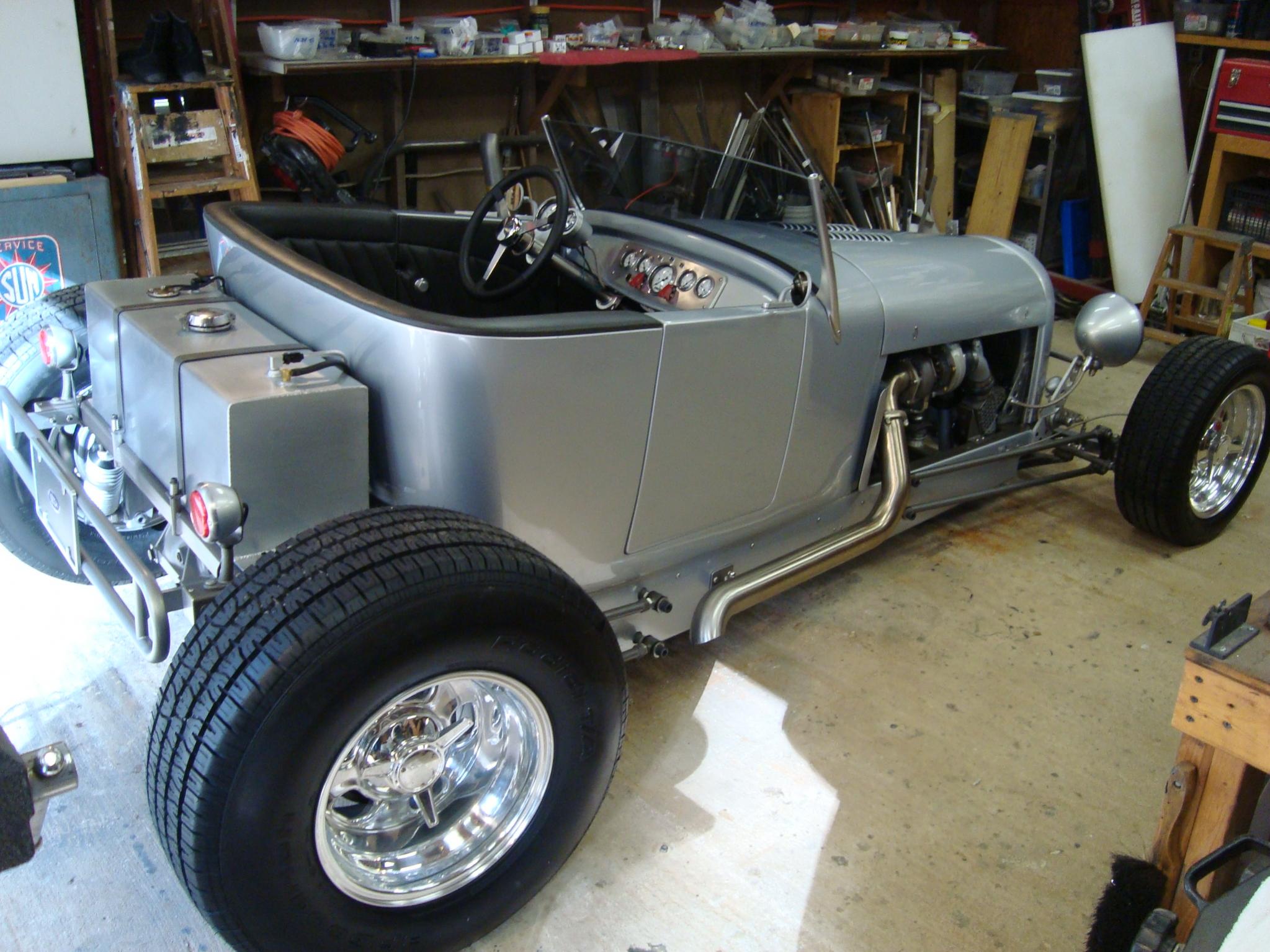

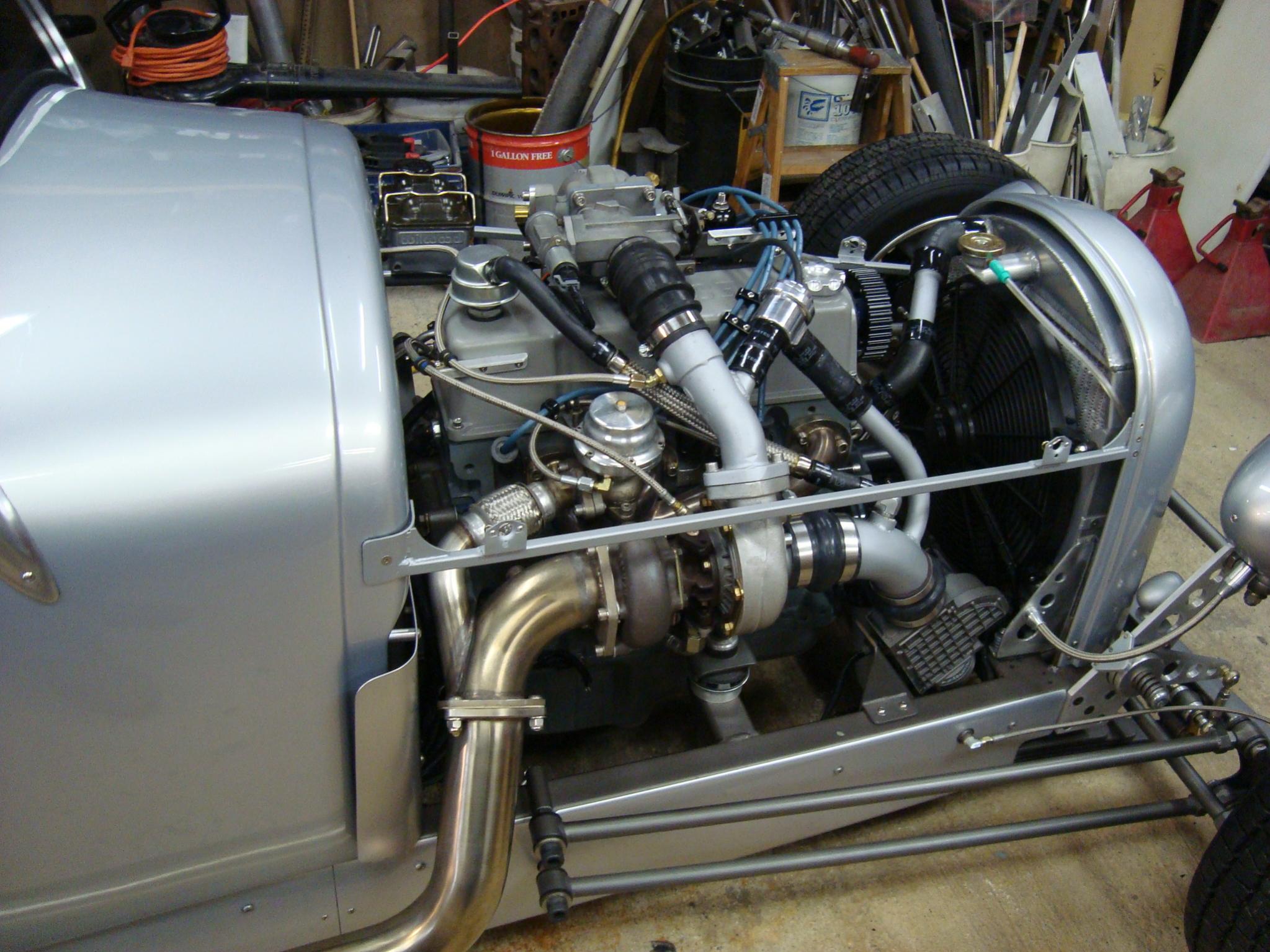

    Here's the roadster I just "finished" Nov '11 Can't believe I posted on this thread (Post#26) ,way back in '04...
    Anyway , here's the latest...Just got it registered/***led ,so can't wait to get it out and do some mileage checks...
    2.3 Ford TurboCoupe eng/trans/rear axle
    Stan
    Update: As of 4/15/13 I'm getting 26 MPG !! Still sorting out some small driveability issues ( running too cool !!! )

    Sweet! Very clean.
