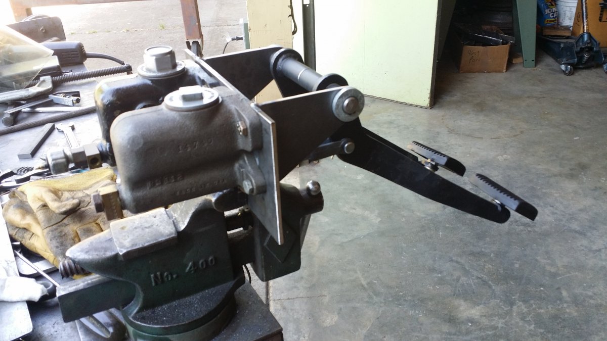

    here's a picture of that one coming together, I used pedals from an Ansen Chevy truck style knock off and built the bracket to work with the Ford masters..
    don colaps and squirrel like this.

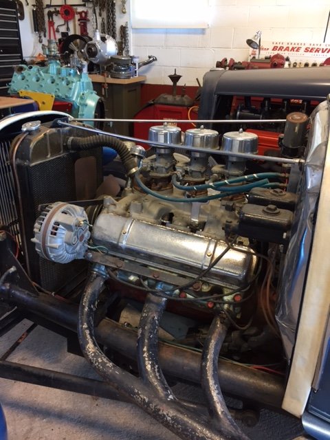

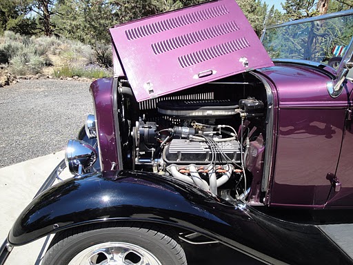

    '57 or so Ford masters, GM truck masters, early Ford masters will all work with the GM truck slave as of course, you need the proper pedal ratio. Couple pics showing the previously mentioned masters; my old T, an old Chevy we worked on, and my kid's '34 coupe. first t (Medium).jpeg dual master chev (Medium).jpg dual master early ford (Medium).jpg
