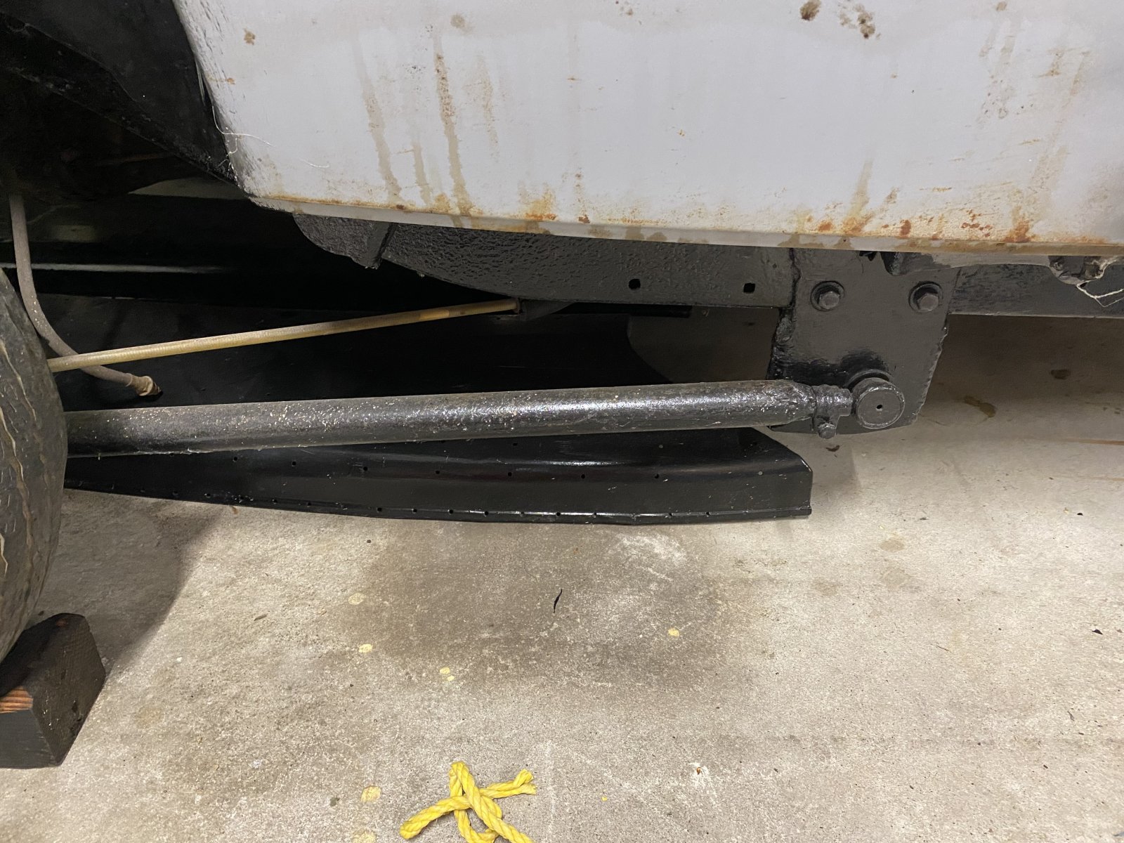

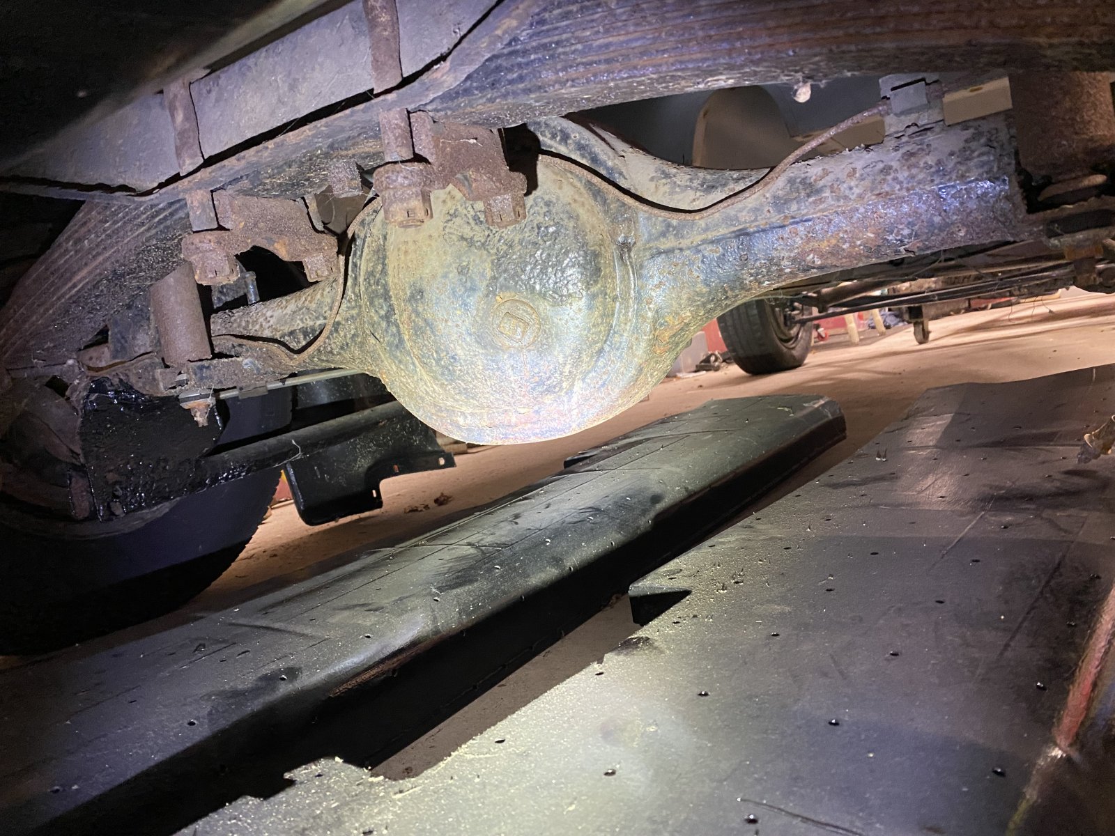

    I wasn’t looking for another project I swear but after freeing up an empty spot in my garage I stumbled on a 1939 Deluxe Coupe. Sometimes they just find me, at least that’s what I told the Mrs. All the 85 year old owner could tell me was that it was an old hot rod out of Alabama that he purchased ten years ago to restore/refurbish and he never got around to it. It had a 14” Oldsmobile Cutlass rim on one of the rear tires so I figure it’s some kind of GM rear, also some homemade ladder bars and other cool stuff.

    No expert but looks like 55-64 chevy 8.20 rear
    Very common in fat ford's.. have a 56 in mine

    tomcat11
    This is what I'm thinking to. 55-64 chevy. Casting number may reveal more. Probably a date code on there too.

    It appears to not have a drain on the underside of housing. If so, 55 or 56 would be the case.

    57 had a drain plug on the bottom.
    I re did mine a few years ago, you can find all new bearings seals etc on eBay or Ecklers.... check the number on the front that will tell you what you need

    Great info fellas much appreciated! I checked the gear ratio it’s a 3.50 (if I counted properly) and the number on the front reads 3707306.

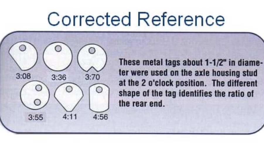

  14. Johnny Gee
    Joined: Dec 3, 2009
    Posts: 14,231
    Johnny Gee
    from Downey, Ca
    Maybe this one Lloyd because letter codes came after Tri Fives. IMG_2089.jpeg
