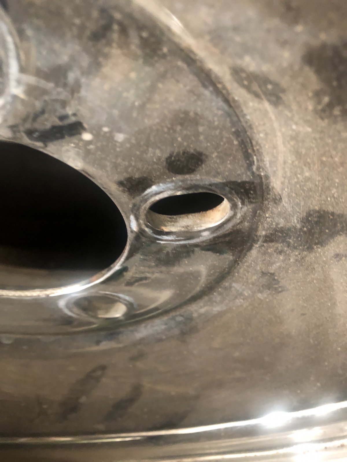

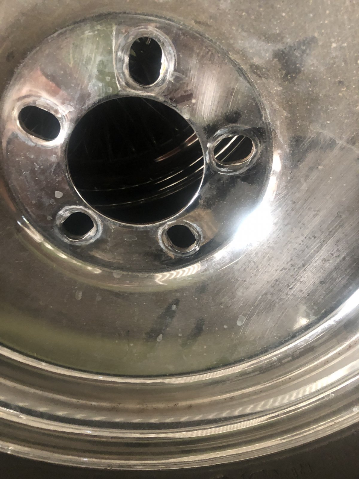

    140240BD-ECF7-41B5-AAFD-BBEED1205BA6.jpeg A793C011-165F-451B-9747-BCFFA3D891E9.jpeg Ok stupid question time! Anybody know what lug nuts to use with these? And where to find them? They are superior wire basket wheels. I know they are shank lug nuts or at least I ***ume they are, but the wheel is only about a quarter inch thick so even with the washer a 1/2” long shank it still is deeper then the wheel.

    They are 1/2” Lloyd. The 5/8” diameter shank fits perfectly they are just too long…

  6. Could be the Cragar-style 'unifit' set up. The nut shank diameter matches the width of the hole, the washer has no 'seat', it's just flat. The hole may be offset depending on the bolt pattern. Could use a ET-type nut/washer also, but I wonder if those would be thick enough. This design looks a little sketchy with that thin of a flange.
    ET patented their design, all the others had to come up with something that didn't infringe on their patent. None of these 'others' worked as well...

    Are you sure they're Superior? Appliance made wire basket wheels that used a seperate ring with the actual lug pattern. Here is a pic of a 4 lug one...but you get the idea. The center hole on those is a little big too.. the retaining ring has a register that centers in the hole in the wheel. Screenshot_20210911-151310_Chrome.jpg

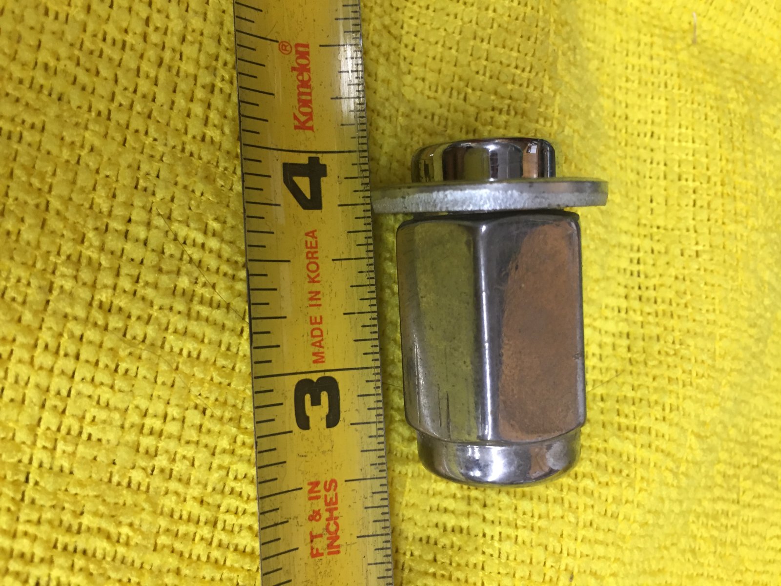

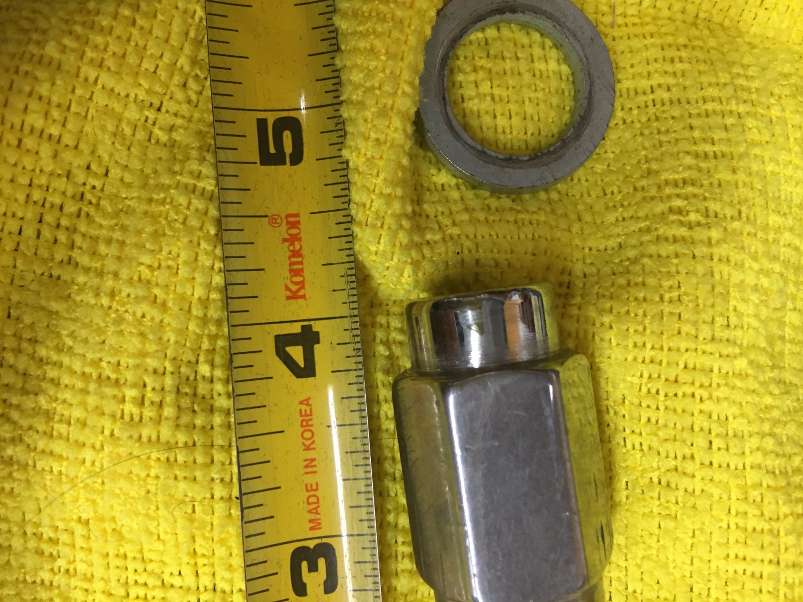

    Found this in my lugnut drawer. There is 1/4” of shank after the washer. I can’t tell you where to get them. This is just my opinion so take it for what it is worth. Why in the hell would you want to run those **** ugly wheels anyway? There I said it....

    Moriarty has the right lug. most wire basket wheels mounted that way. You can buy nice thick washers and cut the lugs if you need to. Good washers and keep them tight and they work fine.

    if you decide to shorten the shanks on lug nuts, make sure they are threaded deep enough so there is room for the stud to thread all the way......

    There's a chance those wheels have a "hub hole" that is the largest size for all the applications. I had a recollection of reading somewhere that rings are available as spacers for hub and wheel mismatches. I did a "custom hub centric rings" search and found more than one seller. Here's one example........
    https://www.uswheeladapters.com/hub-centric-rings/
    Maybe aren't needed in this instance but I thought I'd post it here in case someone does.
