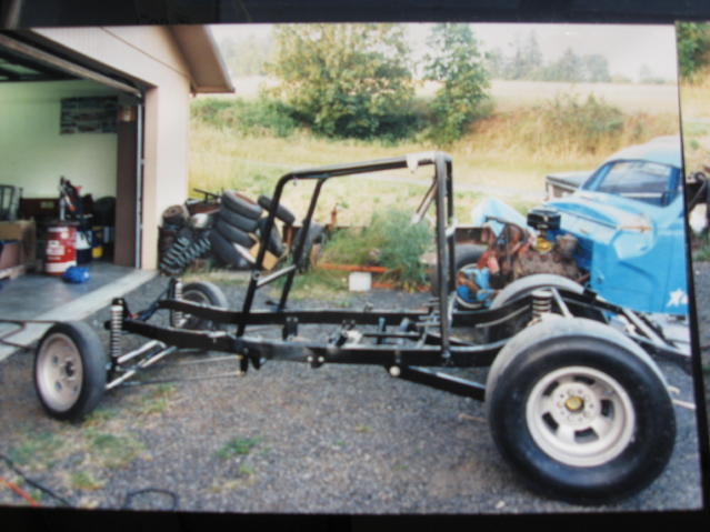

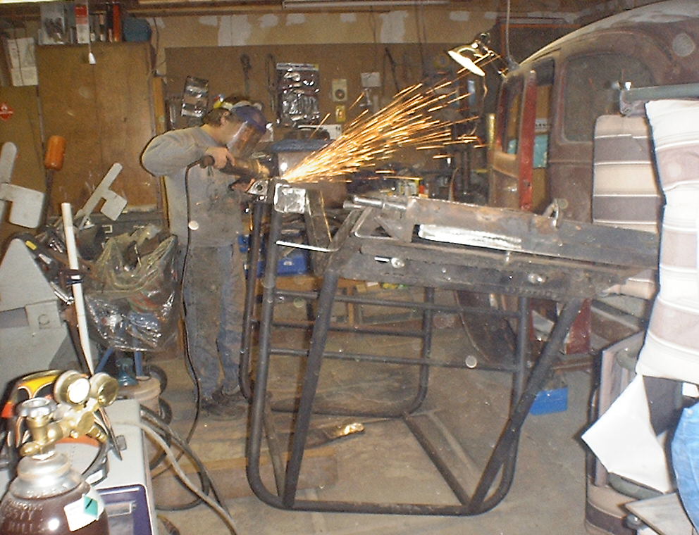

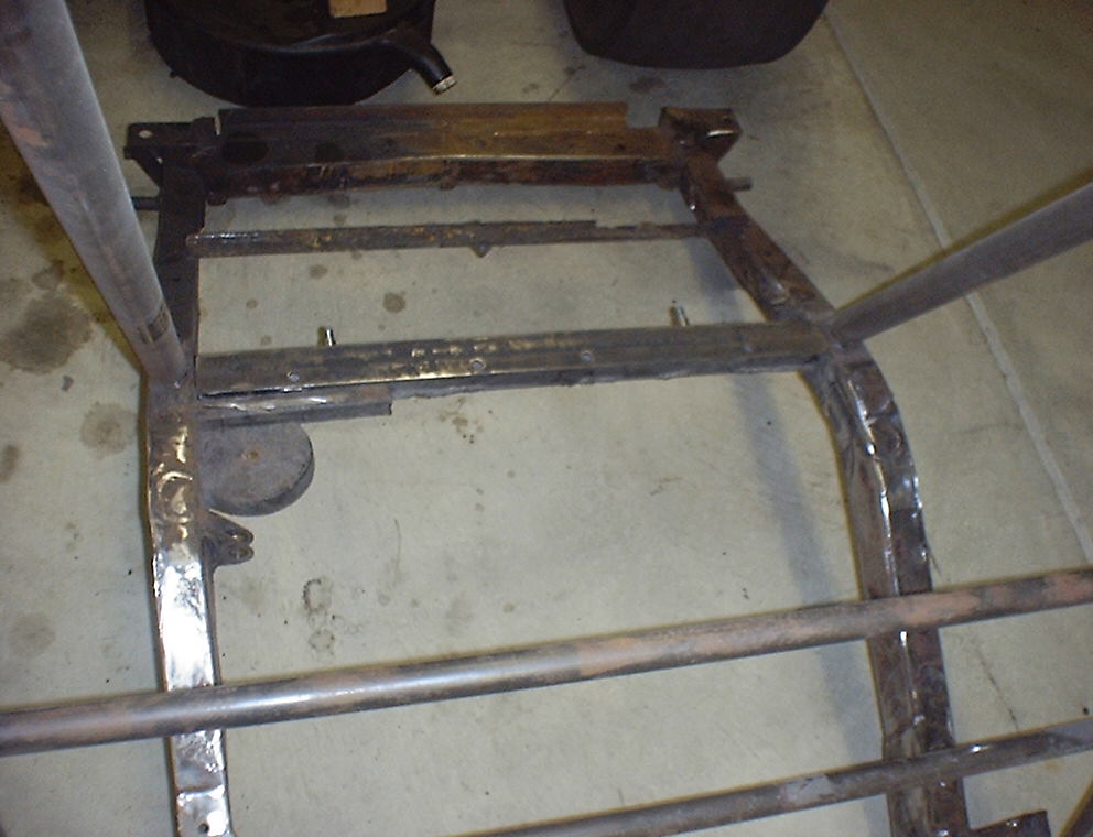

    Here is a Few pics of the Oddy Austin frame Jimmy' "Engish Wheel Bob" & I going over what had to get put back after 40+ years for different owners
    :eek:

    Here are those pics, on the subject of weight, when Tom brought the truck to me for restoration, the 4-bar front links had 3/8" rod ends and 3/4" cm tube, along with "single shear" brackets on the axle and frame. Steve Plueger had installed the "lightweight" stuff in about 1967. It held up, but I talked Tom, into the 7/16" ends and 7/8" tube and "double shear" brackets on both ends, all chromoly.
  6. It's amazing as well as scarry to think this car went that fast with that ch***is.
    Some folks may piss & moan about the NHRA and others rules but looking at this, it's really for our own good as well as the guy's in the other lane.
    Hey thanks a lot Marty!
