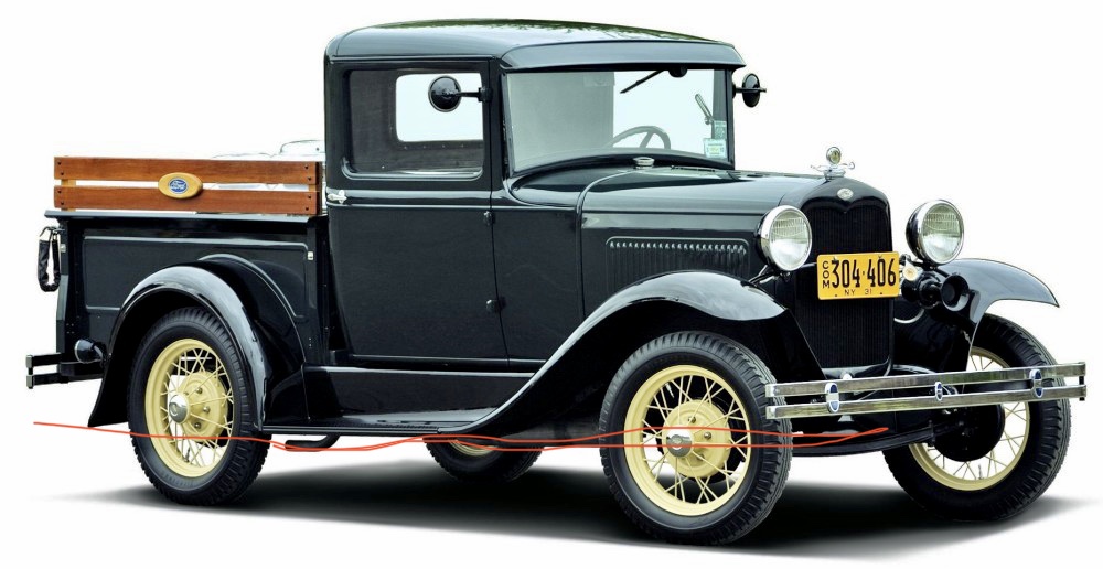

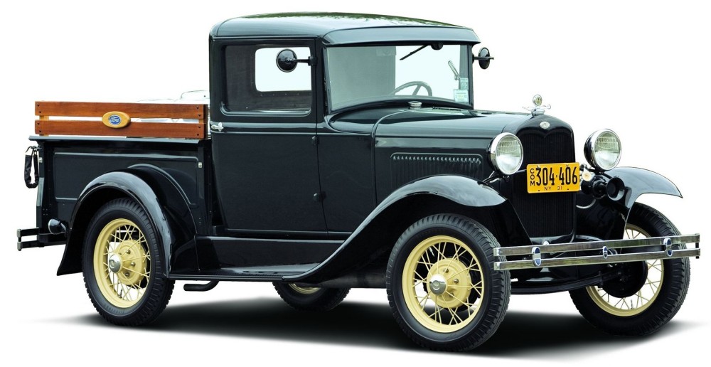

  3. so here’s a stock truck
    See the red line,
    That’s going to be your ride height.
    The running board line is really damn close to center of the front spindle. So your truck will set almost exactly 1/2 the tire diameter off the ground. 26” tire you have 13” ground clearance.
    Most guys like about 8” of ground clearance or a whole lot less.

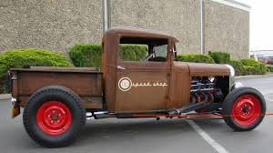

    Now we're getting somewhere, thanks. The pics are great too. The Coupe is closer to what i want in stance. Looking for a rake, so close to stock rear height, if not stock. I'm building from the frame up, so no it doesn't run. I am using transverse springs front and rear, nothing hi-tech looking. Rear is a Ford 8". No fenders . .something that looks like the pic posted here. [​IMG]

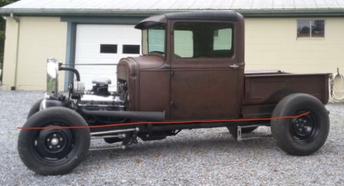

    while you’re figuring what you want,
    Get used to looking at that lowest body line related the axle center . The pic you posted without running board aprons they are 9” tall
    So the line is the bottom of cab door.
    It crosses far below the dust cap
    For comparison in one post.
    Stock
    And now chech the yellow line, door line to spindle
    Ok quiz time.
    rougly how much lower is the one you posted vs stock?

    I would guess the one I posted is about 5" lower than stock.
