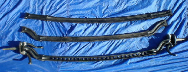

    Lowering too much via spring, or crossmember, or both, puts the center of the beam axle ever closer to the frame, limiting your suspension travel. I am not a fan of this. Axles, springs, etc. hitting frames are bad, on all counts.
    This where a drop-axle has advantages. The center of the beam axle stays in relationship to the frame, and the ends move up
    It's the semi-prehistoric version of a drop spindle.
    The one at the top is a stock 1928-1931 A beam axle:
    The next two down from that have been heated and stretched. The bottom one is shown ***embled, and the web of the i-beam has been drilled, for style.
    You can see that the location of the kingpin has moved up, in relation to the rest of the axle, while the rest of the axle has remained in the same location.
    A dropped spindle moves the spindle snout up, via a new steering knuckle, where it has been made higher up.
    A dropped axle moves the spindle snout up, via moving the attachment point up.
    town sedan likes this.
