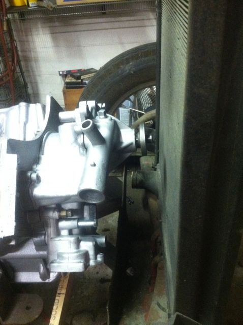

    Here's proof that a small block Buick or Rover V8 wil fit in a Model A without chopping the firewall. One key is using a 1964 300 Buick short waterpump. All that's needed is a little bump for bell housing. 200+ ready HP - no chop!
