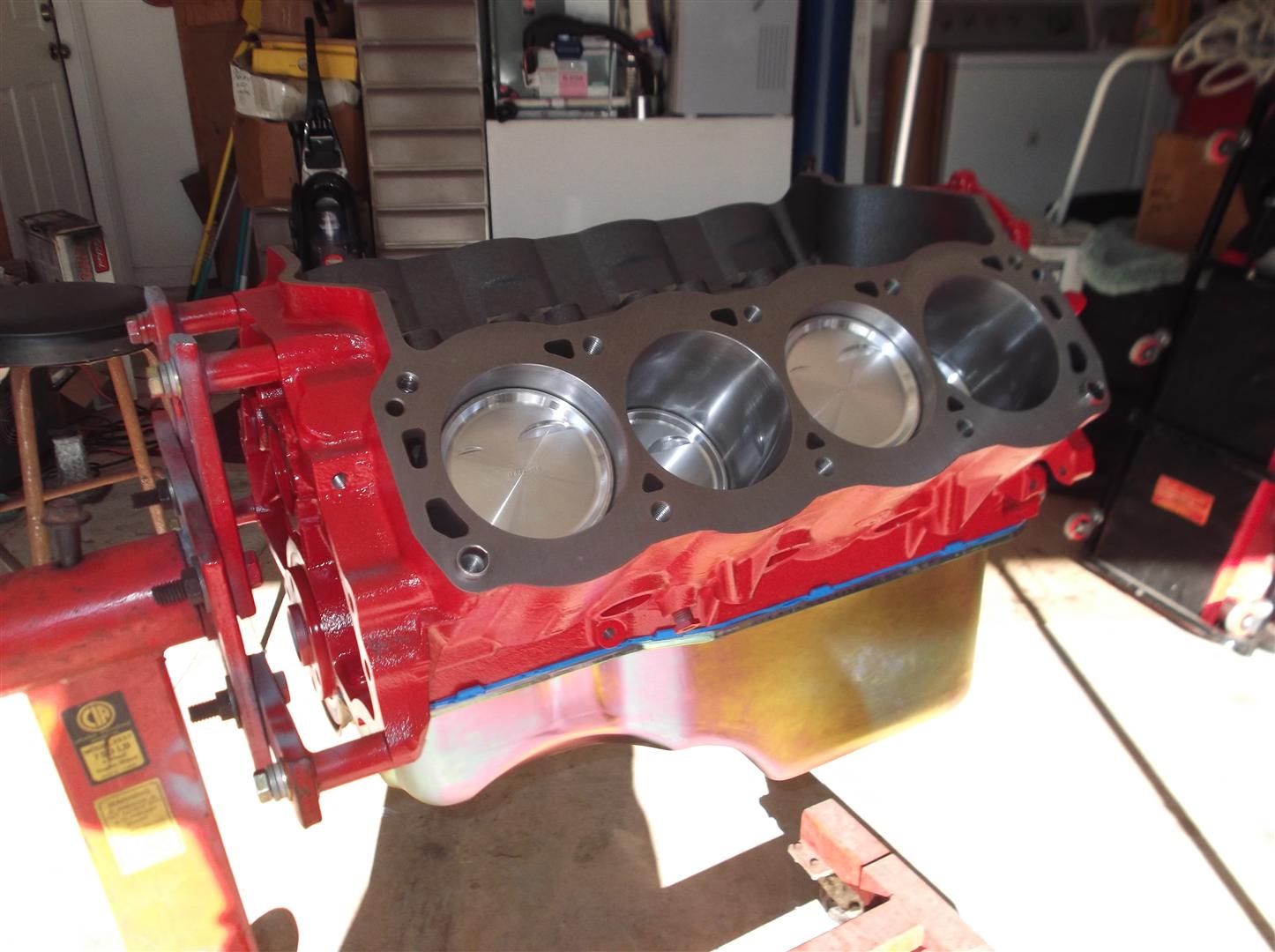

  2. 65 Hemi Coronet
    Joined: Feb 9, 2011
    Posts: 98
    65 Hemi Coronet
    from Florida
    I'm building a Dart block windsor based 454 for my 64 Fairlane......one of those would go very nice in a falcon/comet.....

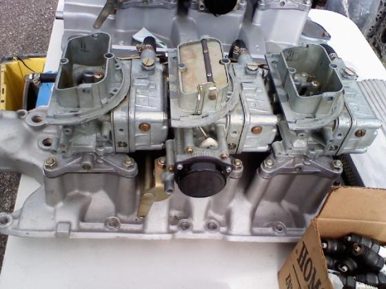

  26. Deuces
    Joined: Nov 3, 2009
    Posts: 26,693
    Deuces
    This is in a Falcon.....;)

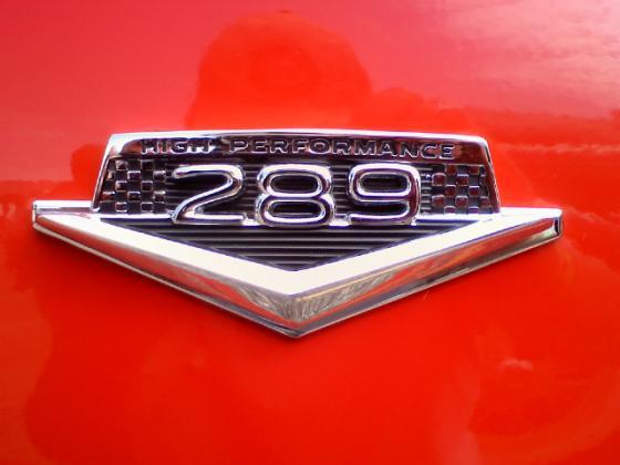

  30. Deuces
    Joined: Nov 3, 2009
    Posts: 26,693
    Deuces
    This would look cool under the hood of a Falcon.... Or any other ol' school Ford with a 289-302...
