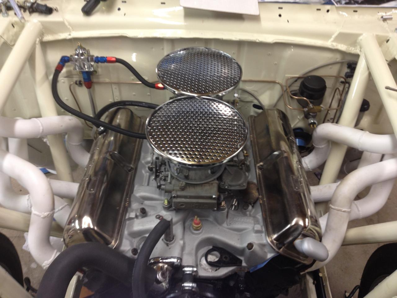

  25. nuts4fords
    Joined: Apr 16, 2011
    Posts: 26
    nuts4fords

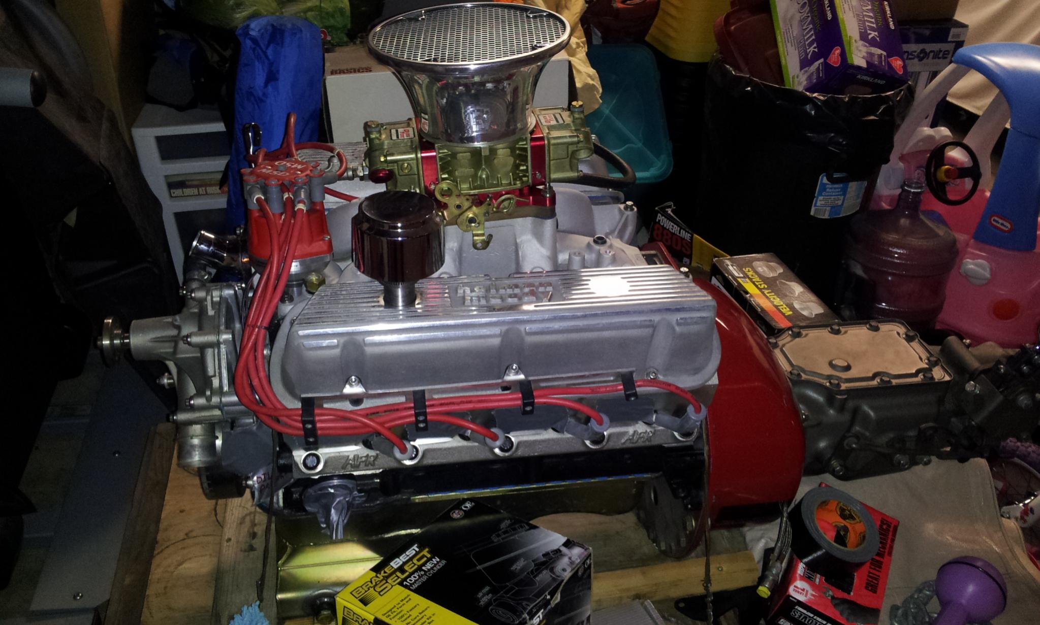

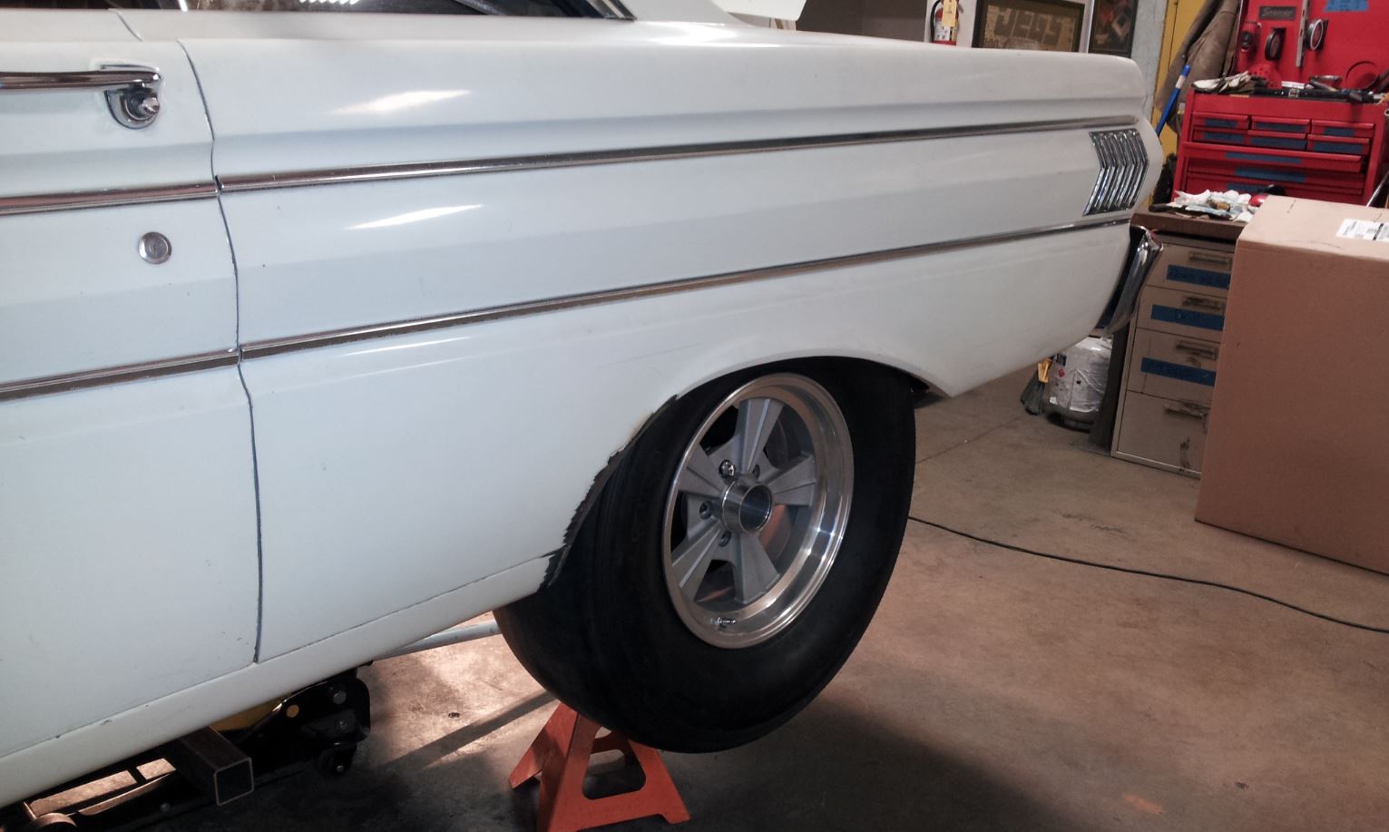

    This is what Im dropping into my BFX tribute 64 Falcon.
    Can't go wrong with a Mexican 302 stroked to 331, 4 speed top loader with front shift location and a 3.89 nodular narrow 9" rear. Perfect for that old school look and feel! Minitubbed, subframe connectors and cage.
