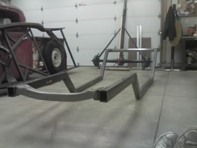

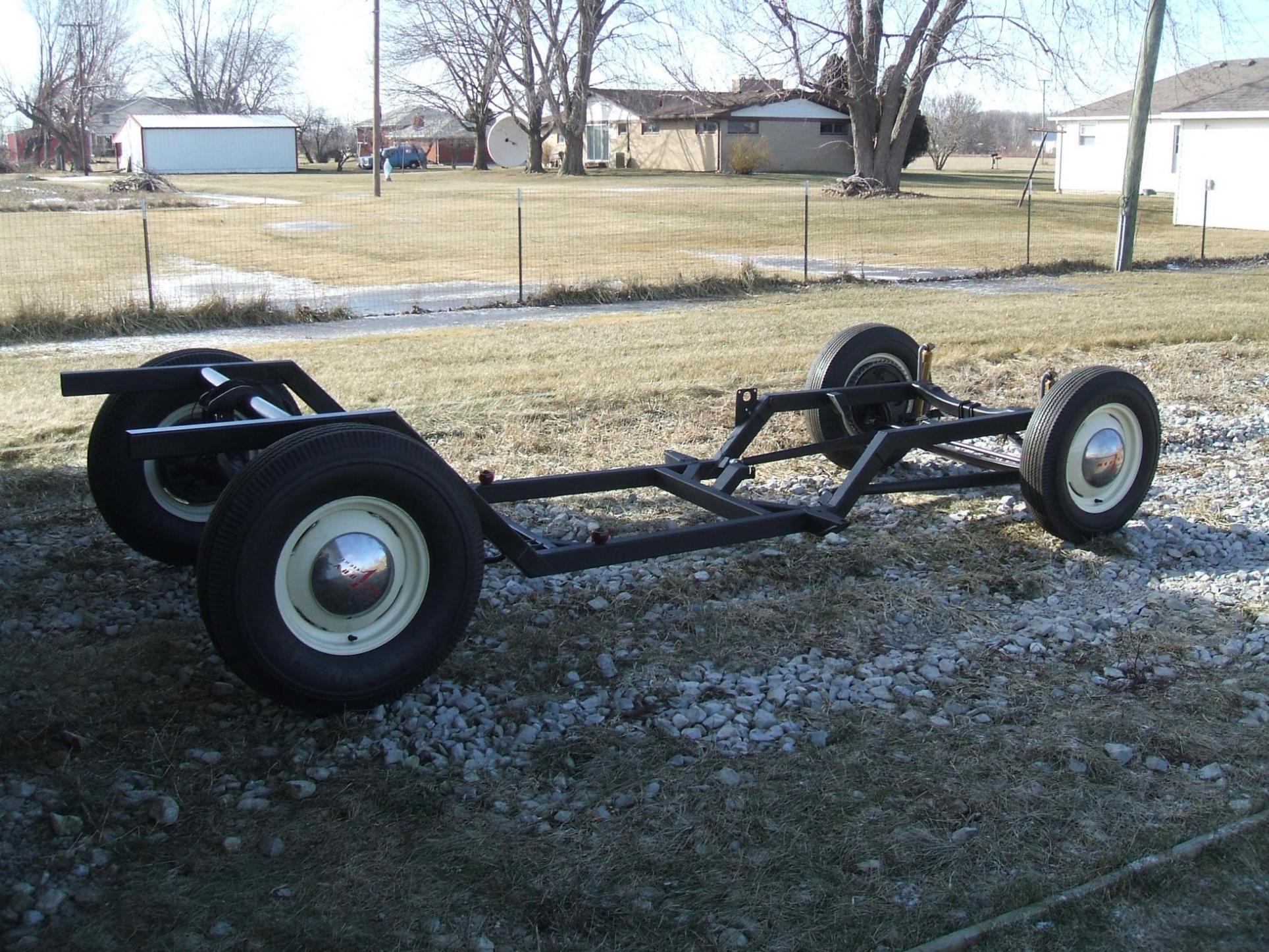

    You need a frame similar to this...........

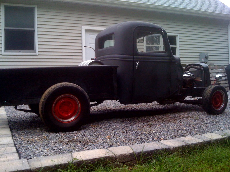

    That frame just ain't gonna cut it. The truck you like is maybe on a stock frame but it's not a stock front end setup. 36's had the spring in front, which set the wheels way back, that one likely has a spring over or spring behind setup to move the axle forward and lose the overhang that looks so odd on fenderless 36's.

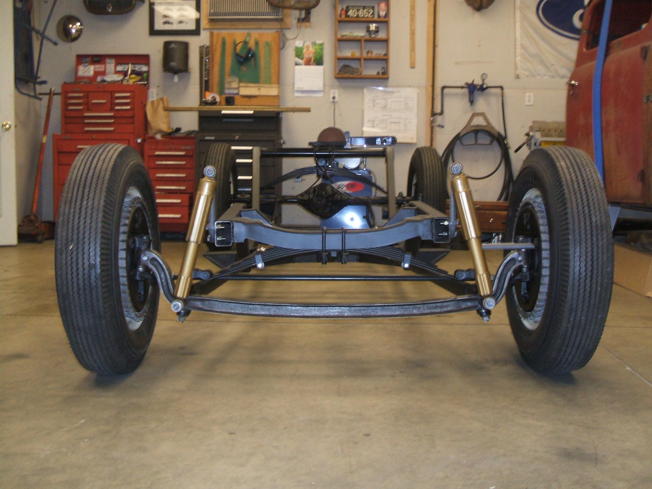

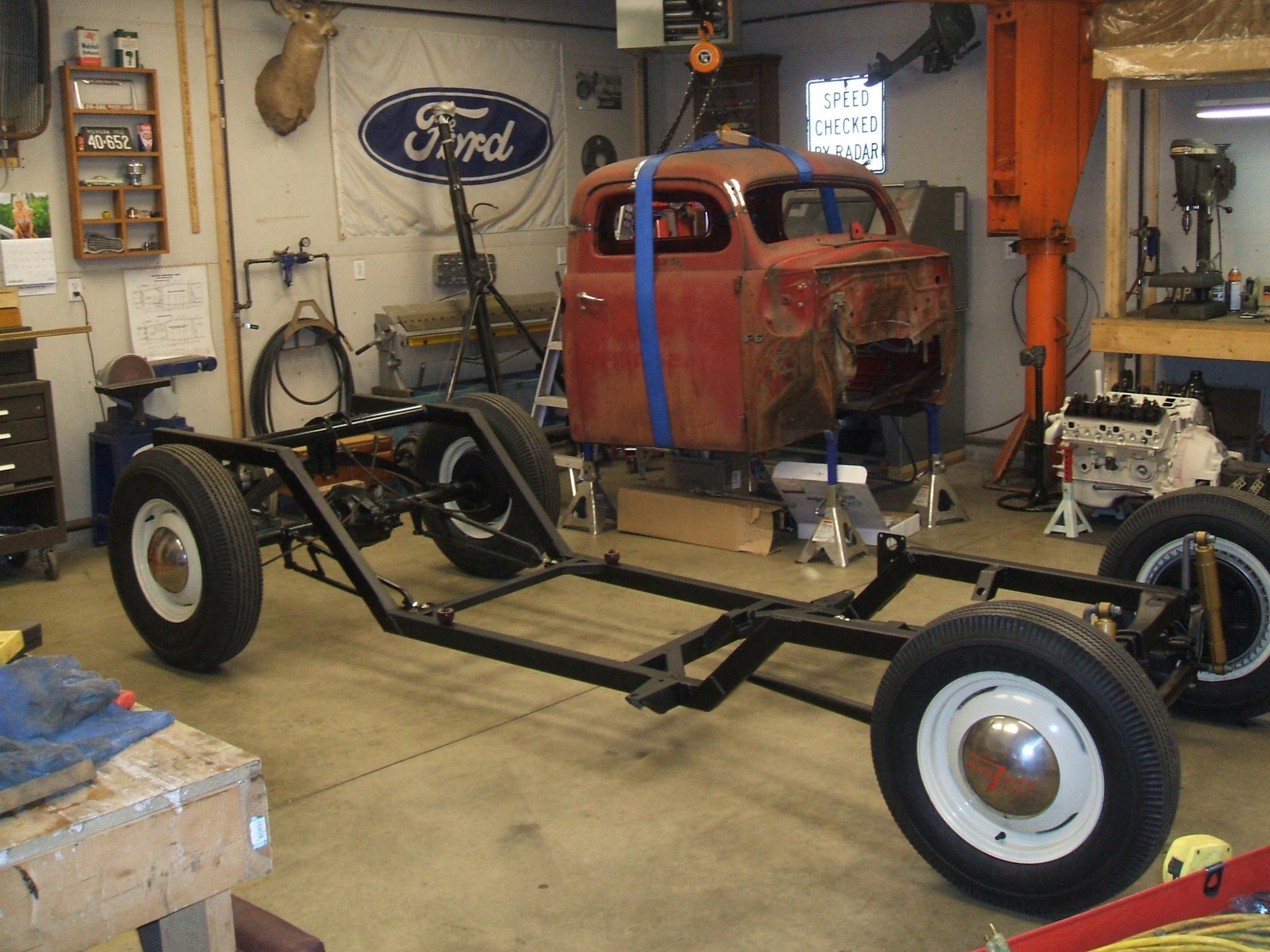

    Here's the frame we built and the truck as it sits right now. Some folks don't like these style trucks. They sure dont like them with control/a arms up front. It doesn't look right anyway. This frame cost $200 in tube and $100 for the repro model A front cross member. Front axle is early ford, 36-37 I think, dropped 4 inches, rear is dana 44 from 56 ford f100 with a 40 ford spring. Get all your suspension parts together first. ALL OF THEM. Build a mock up with 2x4's. Here's a thread I put my 2 cents in. Plan, Plan Plan.
