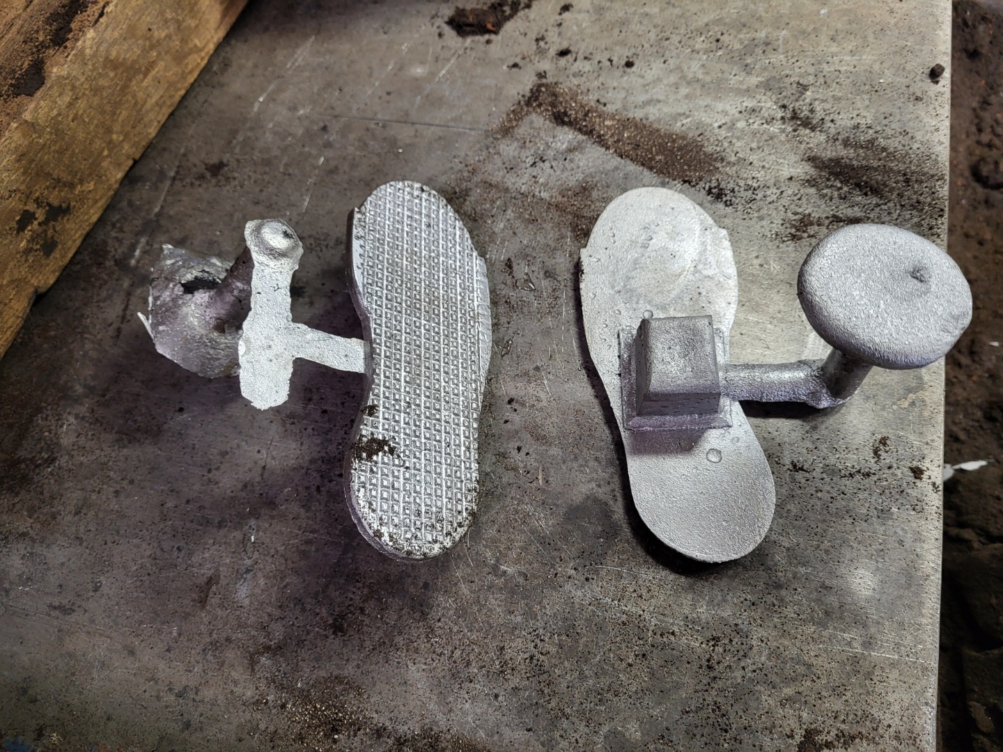

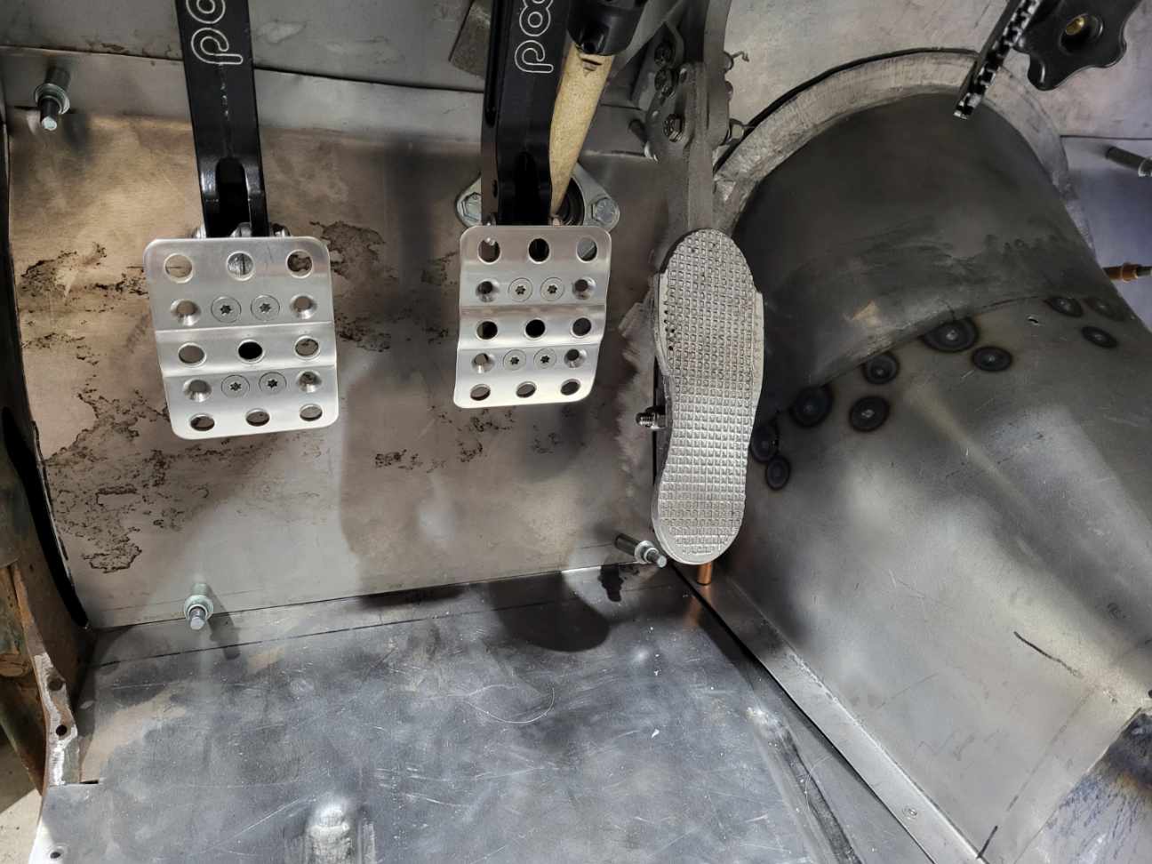

    I didn't like the pedal on the speedway throttle so I made a half scale "Moon" pedal and cast a couple.

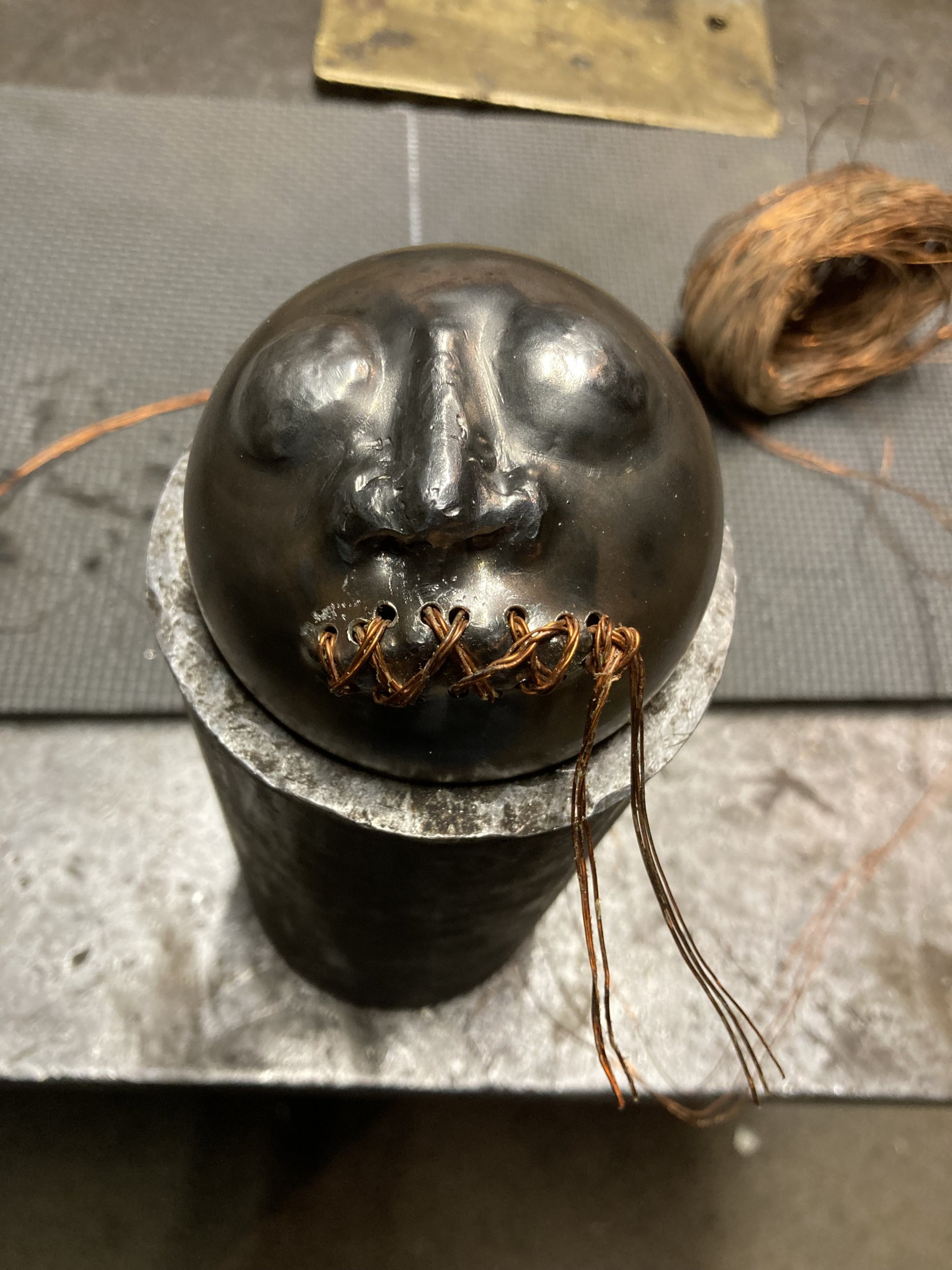

    IMG_0309.jpeg A ugly I’m working on

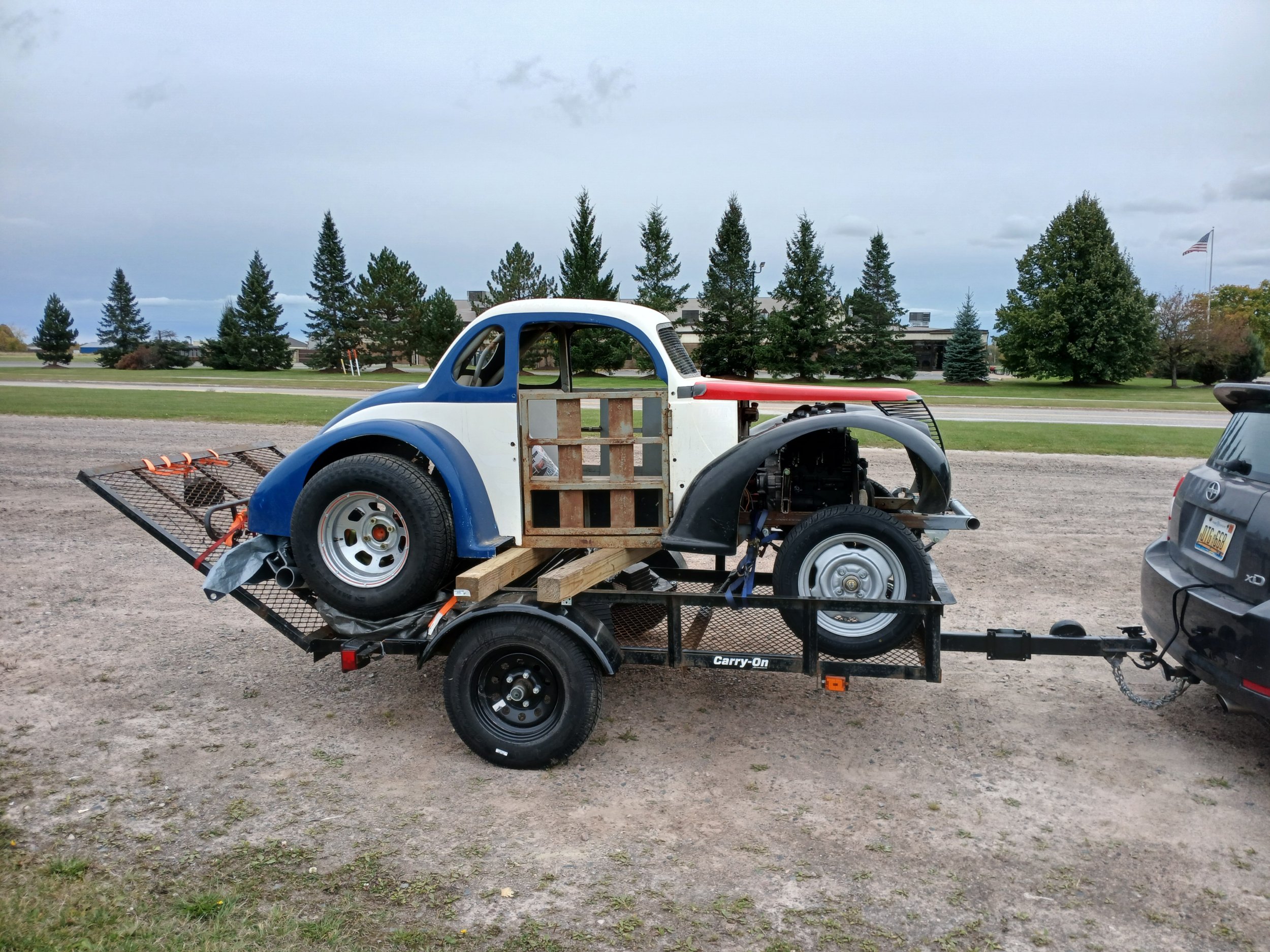

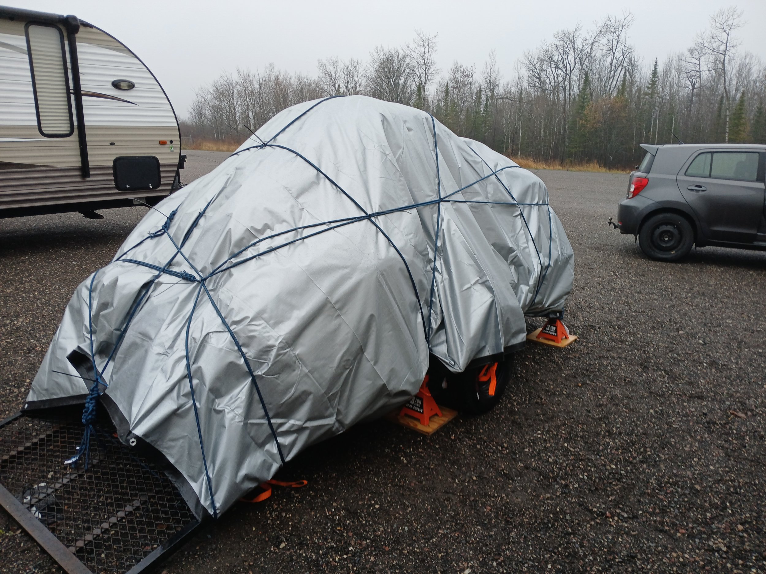

    Got a little progress on the mini g***er this summer. Had our first snow this weekend so it was time to wrap it up for the winter.

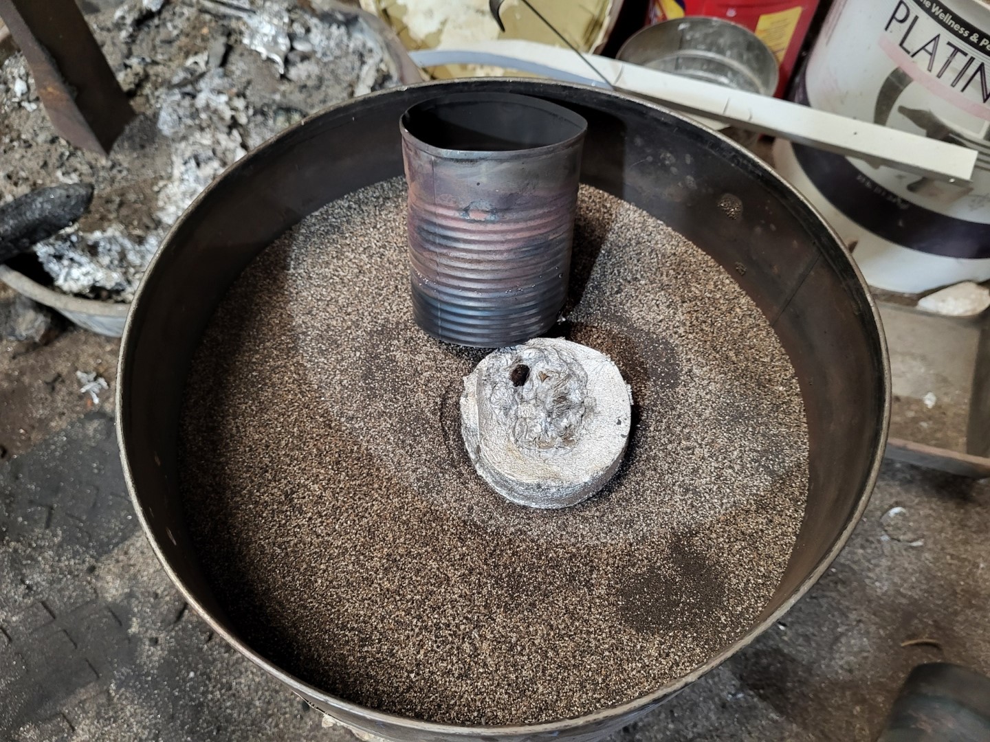

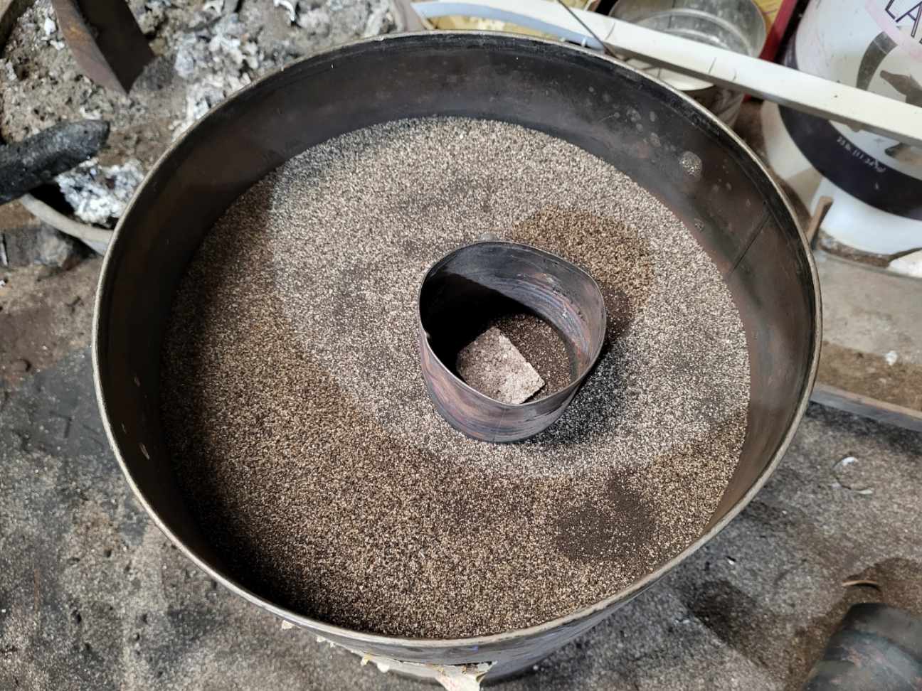

    I made a column drop before lunch using lost foam. This is a great method for one off parts and while I have been at it for thirty years and have a furnace and crucibles, it could be done with simple tools, a torch and a plumber's ladle.

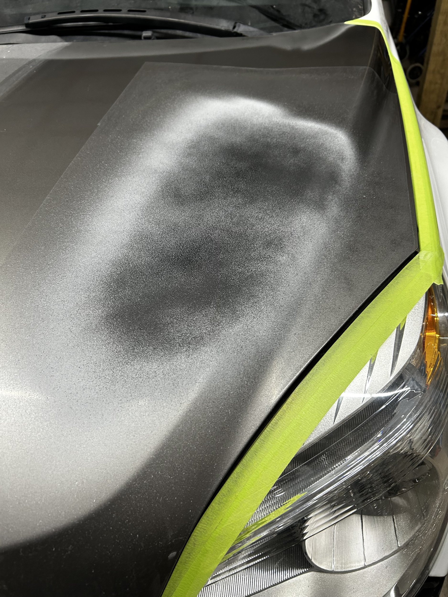

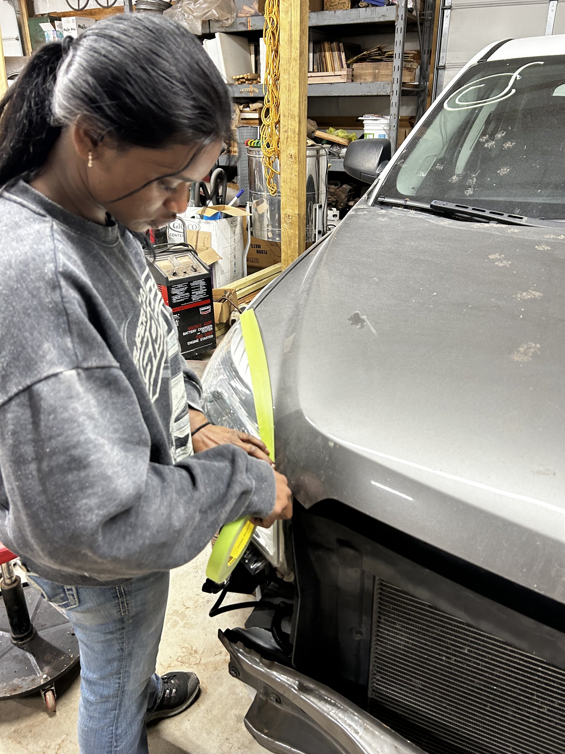

    Teaching my daughter to do bodywork and paint on her car. She actually bought a wreck from Copart that we are fixing. Hope to make the parts white in the next few days.

    @guthriesmith - Way to teach, dad! The wife's daily got bumped, brand new car, figures.. Just a little damage, minimal really. When I picked it up, I noticed the s**** area. Big pile of wrinkled sheet metal outside the body shop. The stuff is so thin, shops mostly replace panels instead of working on them.

    Yep, this new stuff isn’t easy to work. Easy to bend, but if it’s messed up much, easier to replace. However, I’m cheap and would rather fix. My wife’s car needs a fender and I checked on buying one. It was almost $400 for basically nothing. I knocked the beat up one into shape instead.

    She looks like she would be happier going somewhere with her friends in the car than she is working on it…:)

    Probably. But, she has a three year old son so doesn’t get to spend time with friends much anymore. :D She is honestly a hard worker and ***embles construction equipment for Ditch Witch to support herself and her son. :)

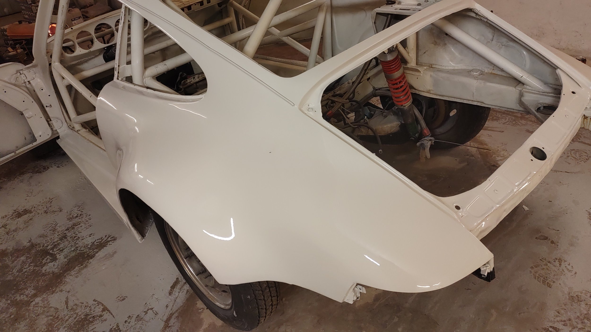

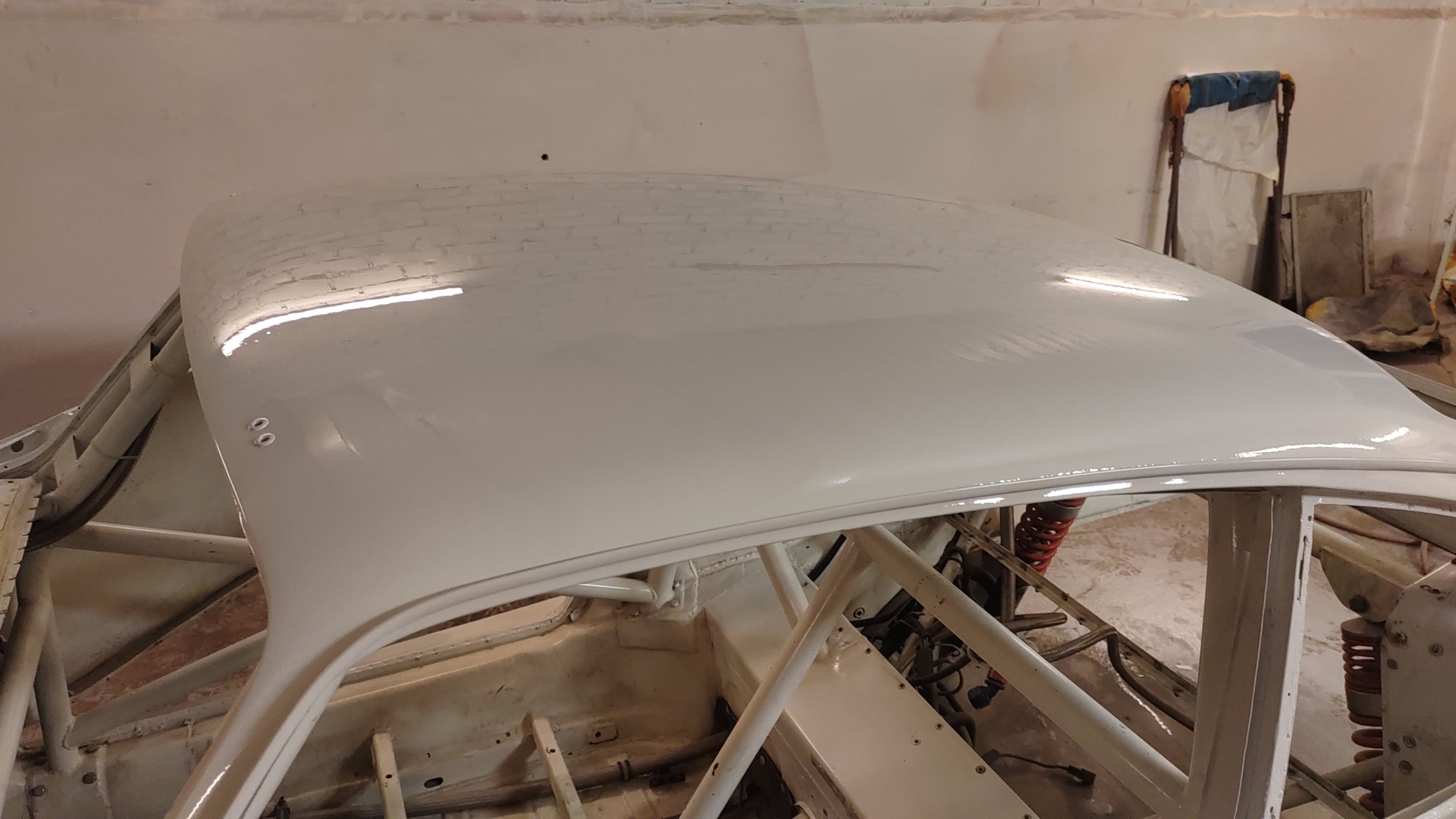

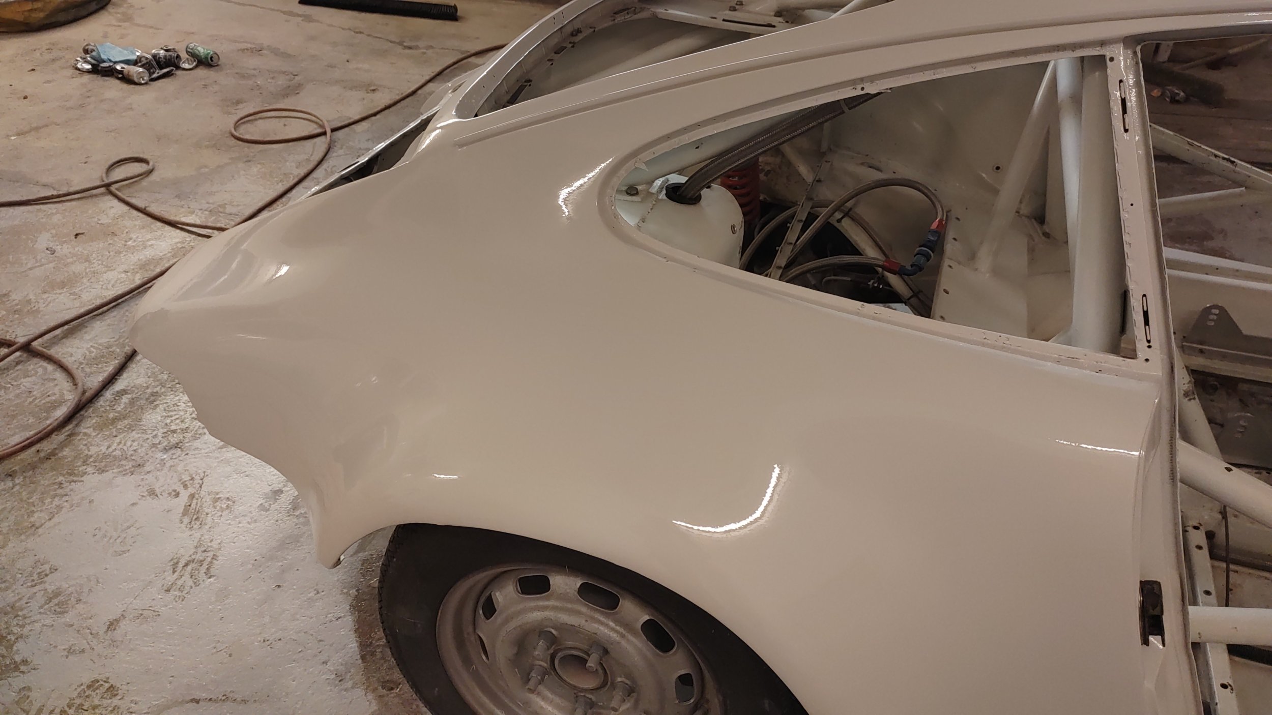

    Fresh coat of new paint for this racer. IMG-20241117-WA0024.jpeg IMG-20241117-WA0026.jpeg IMG-20241117-WA0022.jpeg IMG-20241117-WA0020.jpeg

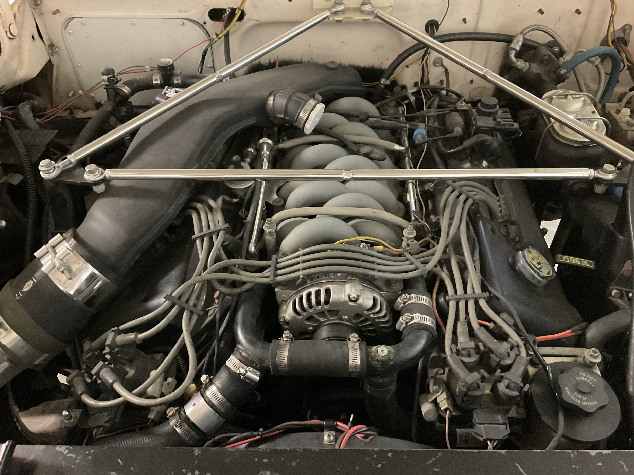

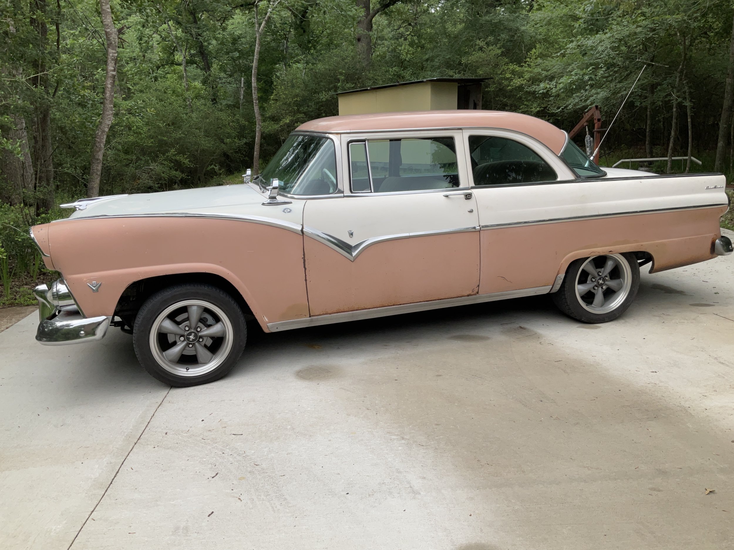

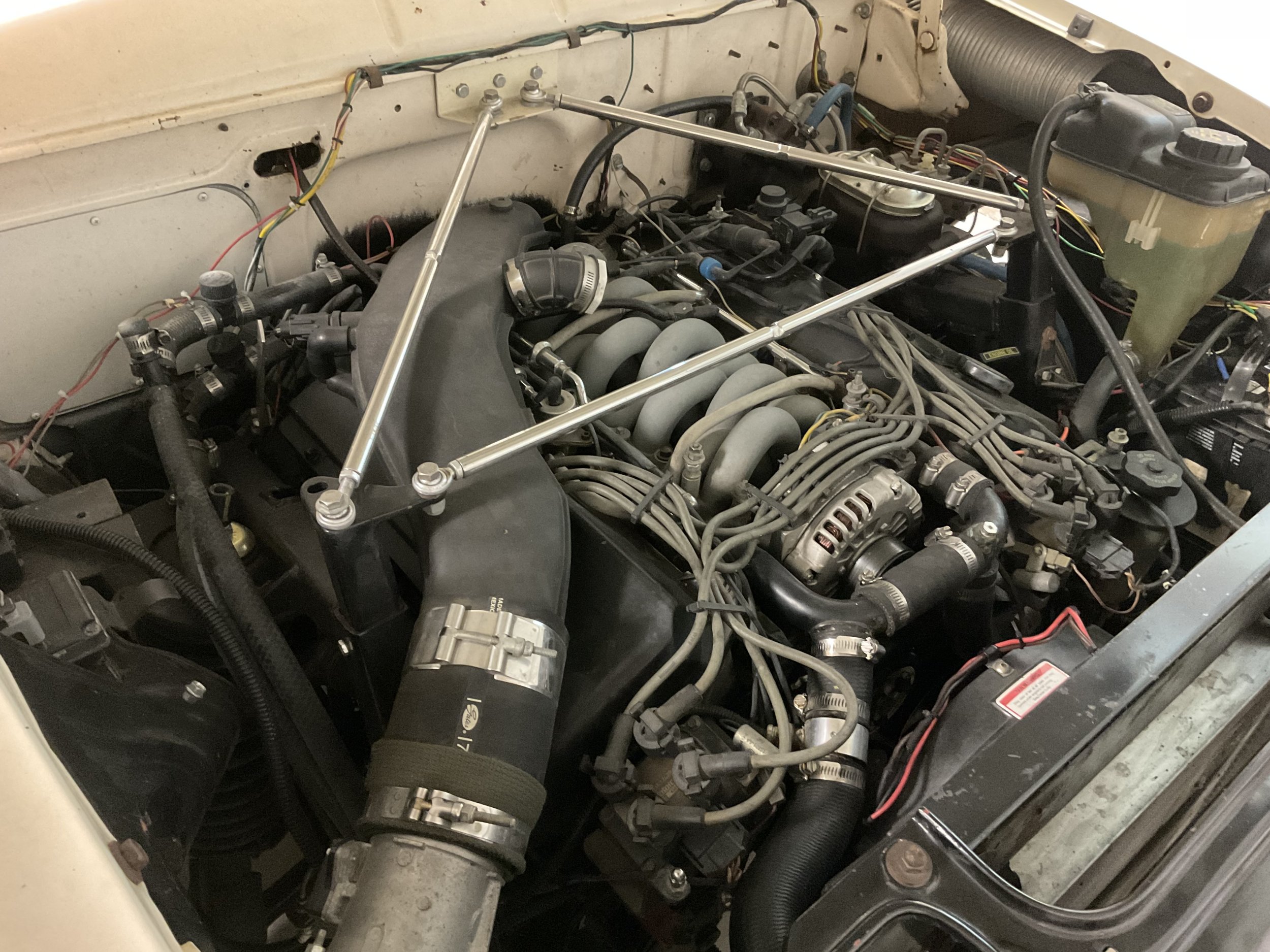

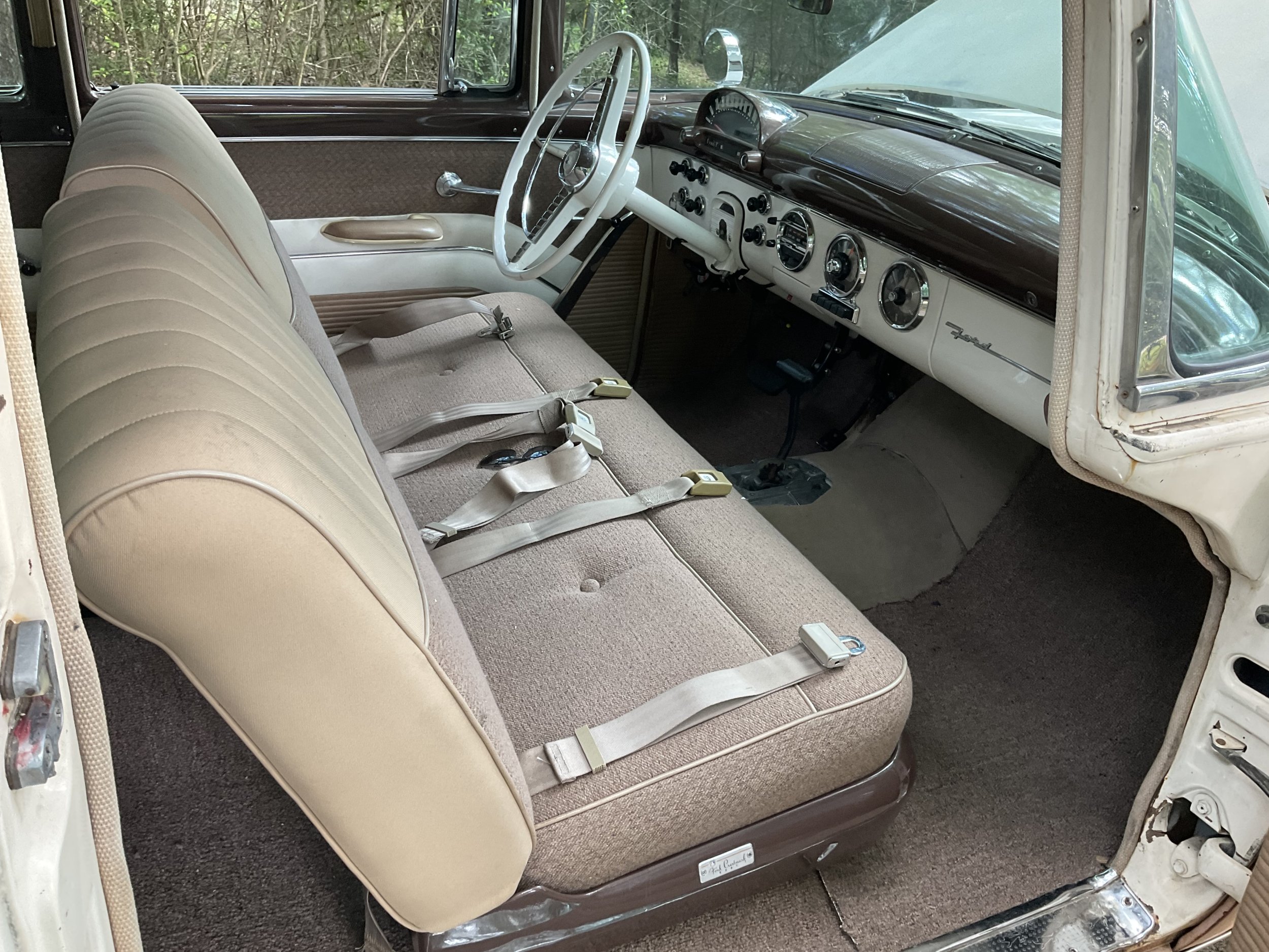

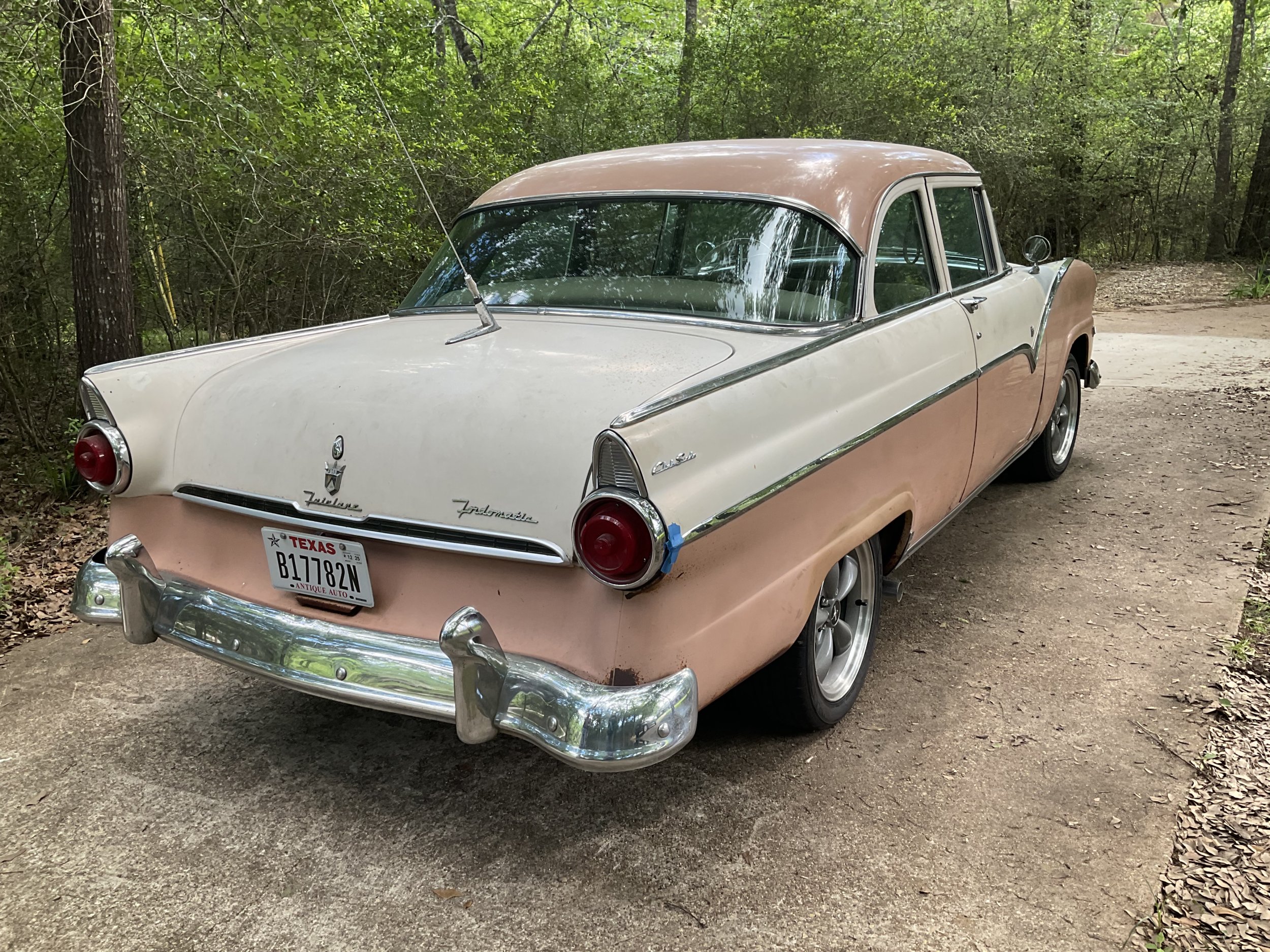

    Have a 55 Ford 2 dr post sedan—-original paint,never in an accident—bumpers frt and rear and all stainless trim is original,factory tinted gl***. Frame cut off at firewall—entire Lincoln 95 Mark 8 clip inserted into original frame and welded——engine,trans is from same donor car as frt clip/290 h.p 4.6L all aluminum DOHC V8/Lincoln power rack pinion,hydraulic ***isted power disc brakes,big sway bar,struts. Car looks like a stock 55 Ford—-has Mustang 17 x 8 wheels on all four corners. Car is decently quick with 55 rear end ratio of 3:31/engine remains stock catalytic converters with 4 ft gl*** pack mufflers. Looks like a 55 Ford,drives,handles,stops like a 95 mark 8. Gas pedal is from a b*** drum. IMG_2553.jpeg IMG_2552.jpeg IMG_2433.jpeg IMG_2395.jpeg IMG_2392.jpeg
