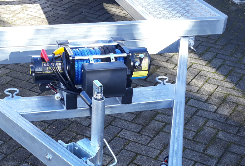

    While I was on a roll, I also added a stand-alone motorcycle motion sensor alarm and GPS tracker to my Race Car trailer
    This is the GPS tracker , You can "Geo-Fence them to switch off a fuel pump relay.
    But I connected it to a relay that locks the brakes using the winch battery

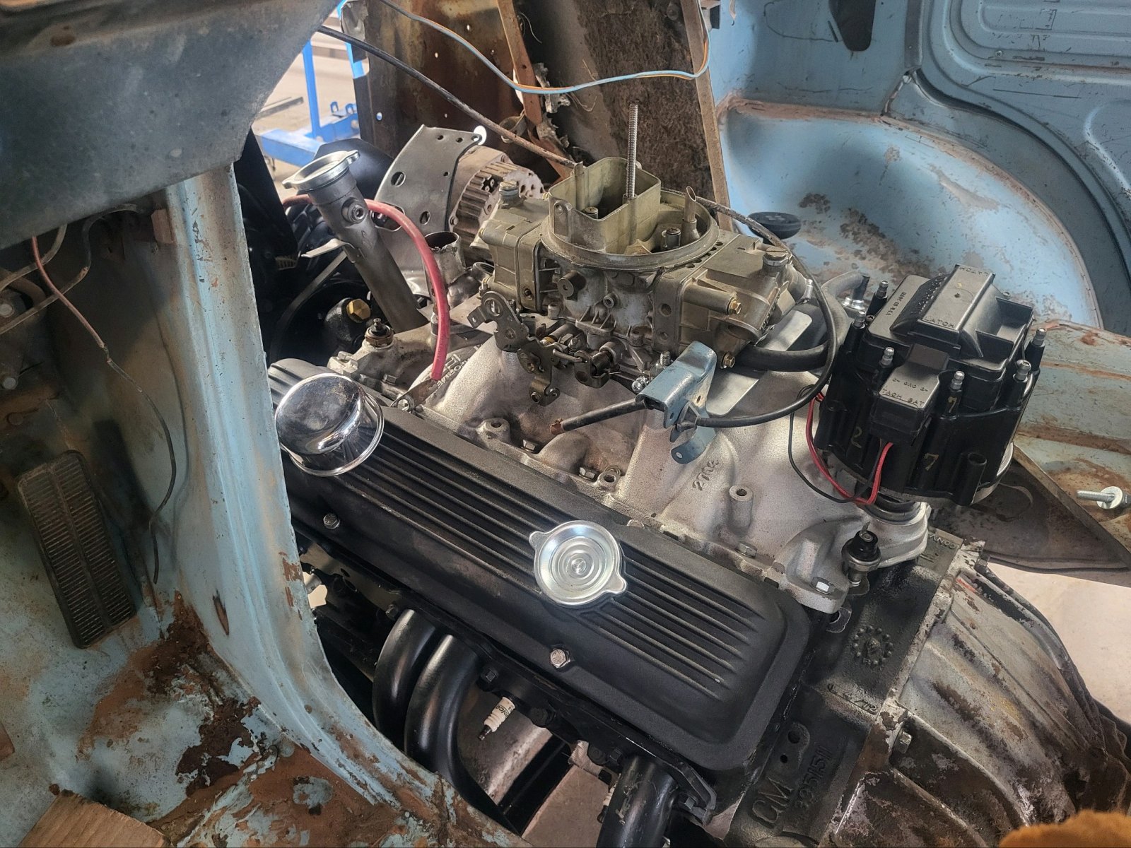

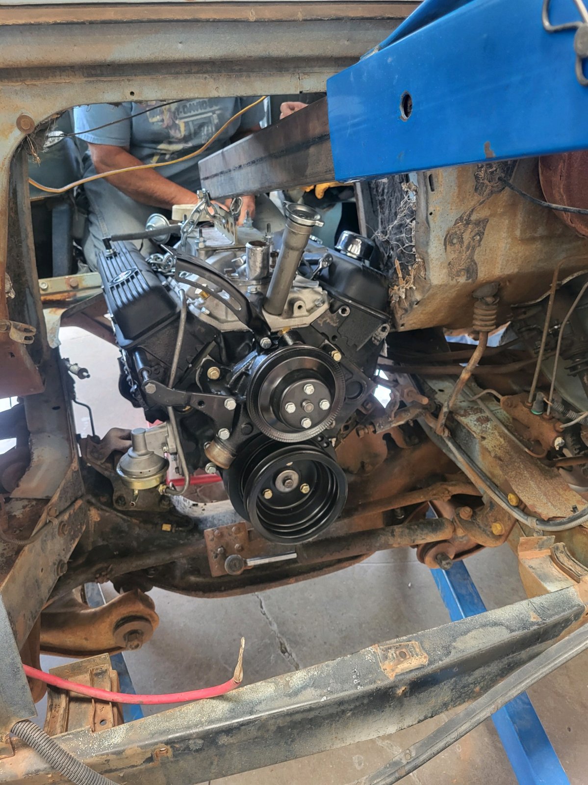

  2. So my 1973 ghetto barge I managed to get the engine sitting on its mounts this afternoon, tomorrow since I am off work I am hoping to get the entire mess bolted together but we will see I'm not intending on getting up early lol. 0514241828.jpg

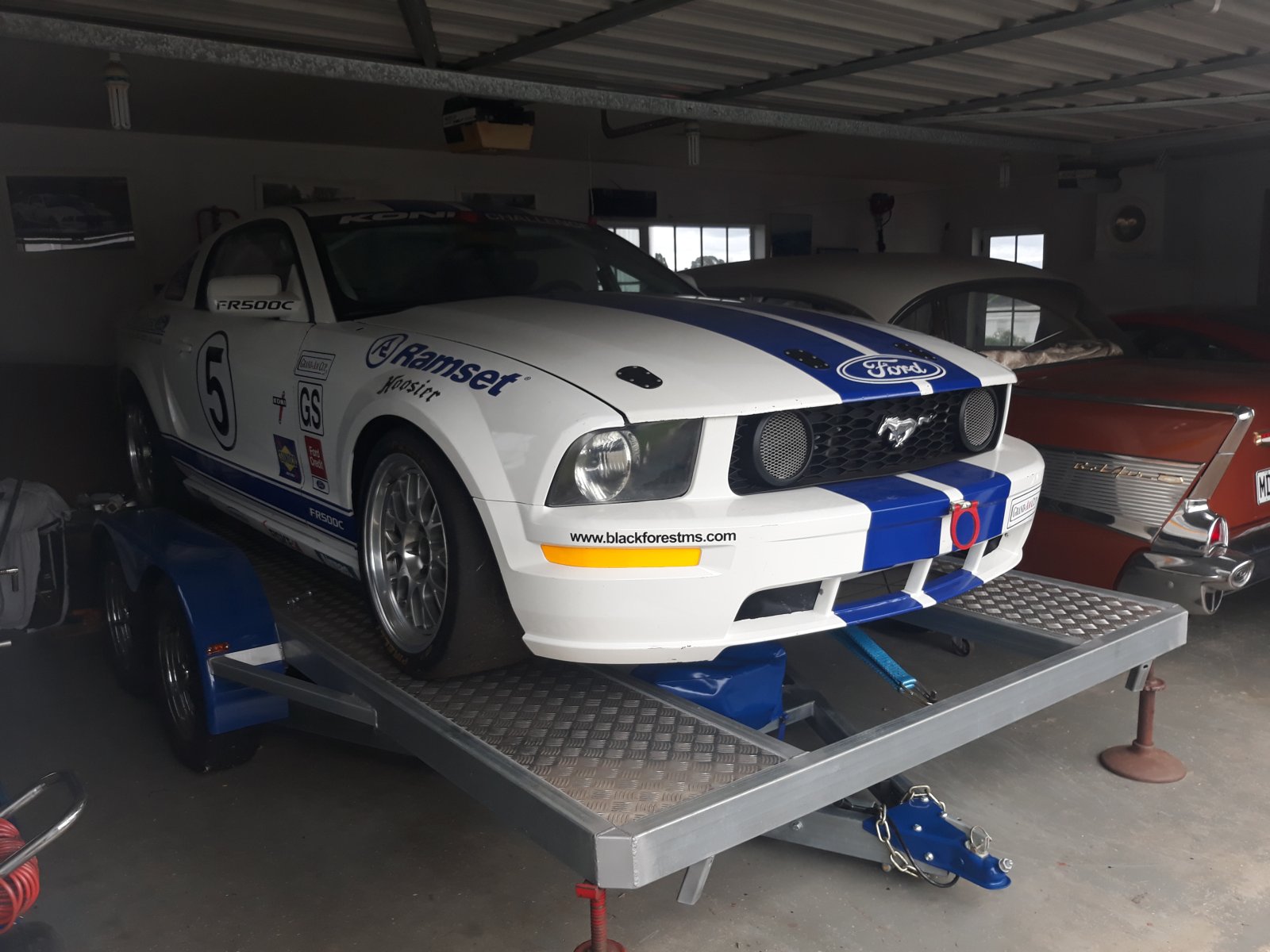

    Trailer theft is very common here because they are easy to re-register as homebuilt. The best anti-theft method is to hide it away from thieving eyes.
    My trailer has a detachable tongue that rolls underneath.[easy with a tilt deck] I can hide it inside an urban garage with my race car parked on it.
    The GPS tracker is tiny. It hides inside the plastic control box on the winch
    All the wiring is stealth and hidden inside the frame rails etc [plus a 90-day internal backup]
    There are many other "secrets" on that trailer

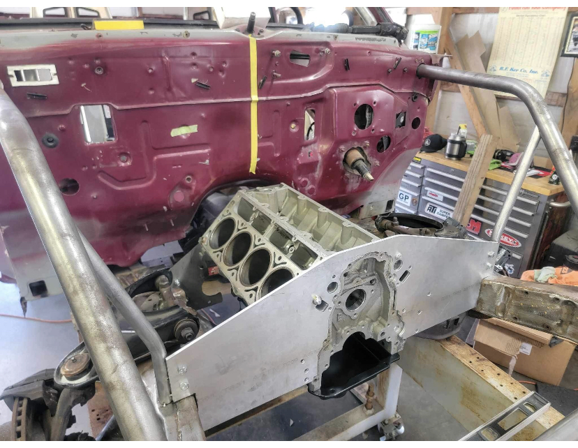

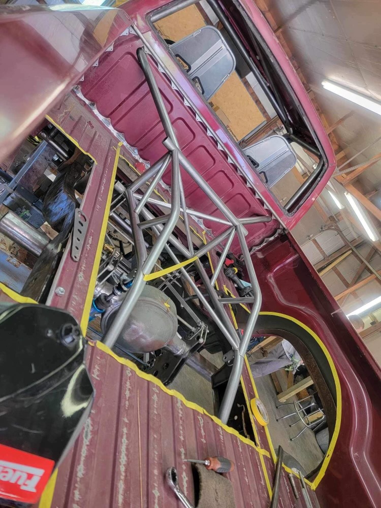

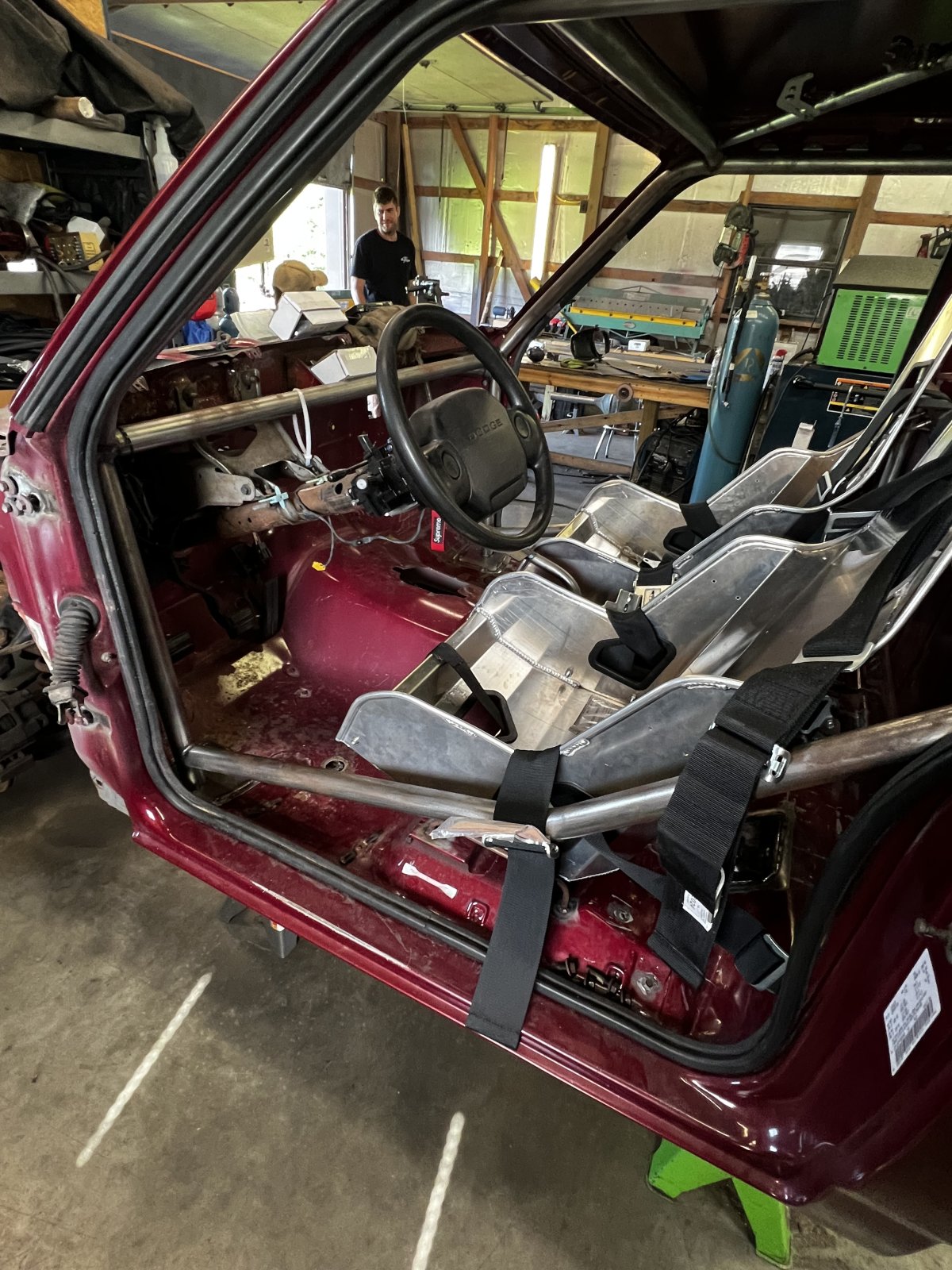

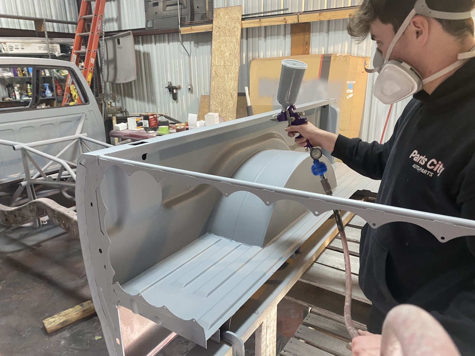

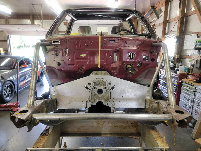

    Sons just turned 20 & he’s been building his 96 twin turbo LS Dakota for mid 4s in 1/8 drag racing. We bought it new 4cyl stick no option shop truck , claimed it since 3 years old. Old rodder pal asked him when 3 while eating out with Grand Ma & Grand Pa , if he had a hot rod & he replied ….”yep , I got a Dakota “. You do said old pal ? “ Ya , I’m gonna put a big block in it someday” he later told me I’ll never forget him telling me that so small. You’re a product of your environment …. Flux

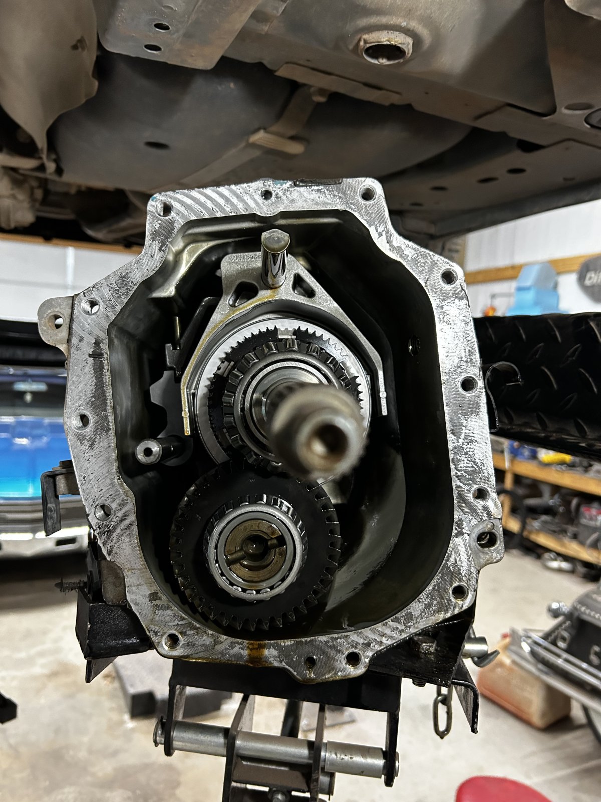

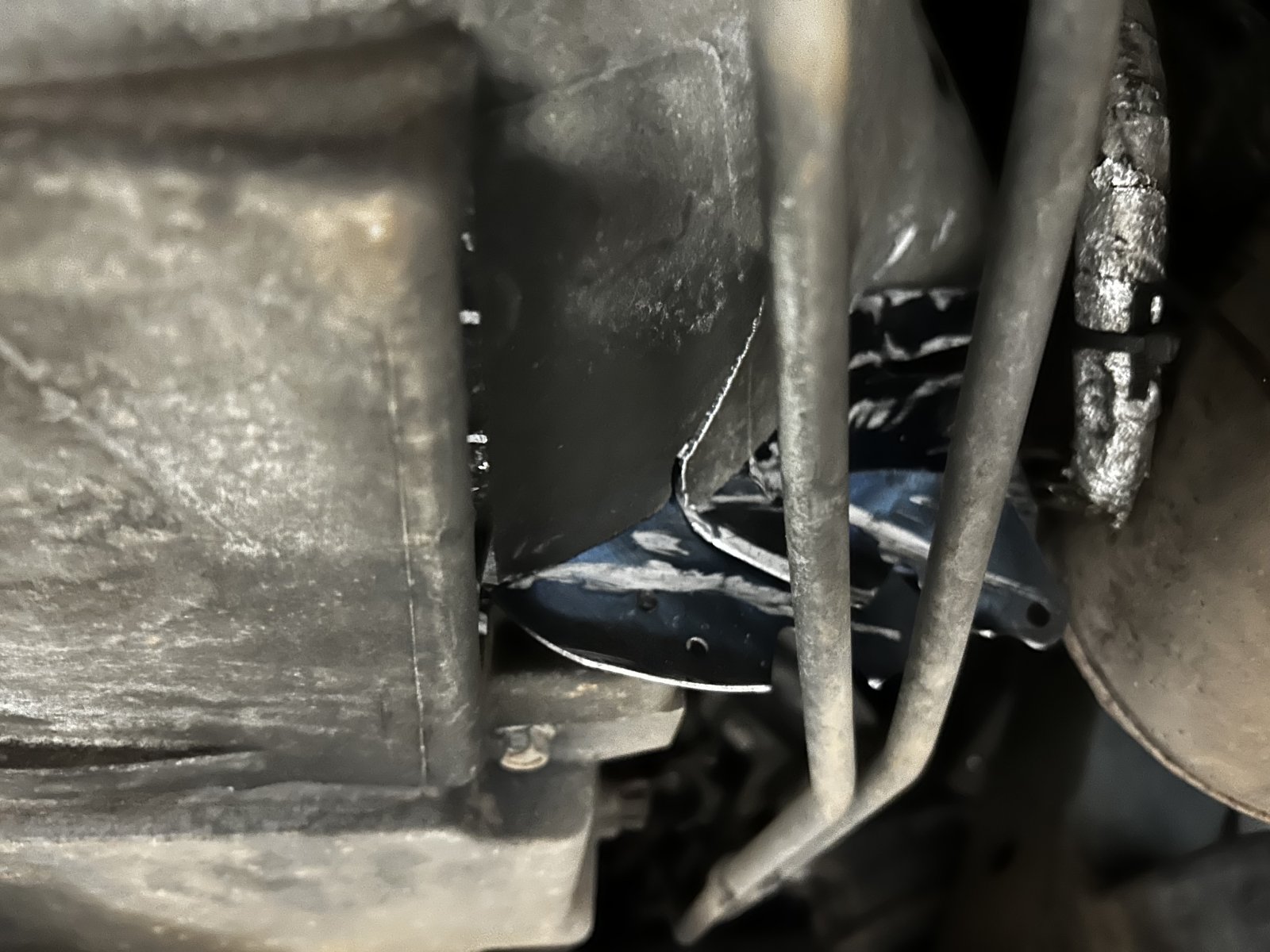

    Clutch came apart in my son’s 2010 SS Camaro and made a mess. At least it didn’t completely make it out of the bellhousing. I’m sure he was just idling along when it came apart. :rolleyes:
    Anyway, I was surprised when it started leaking transmission fluid when we started pulling off the bellhousing. I’ve never worked on one of these new fangled transmissions before…. I guess we will learn together.

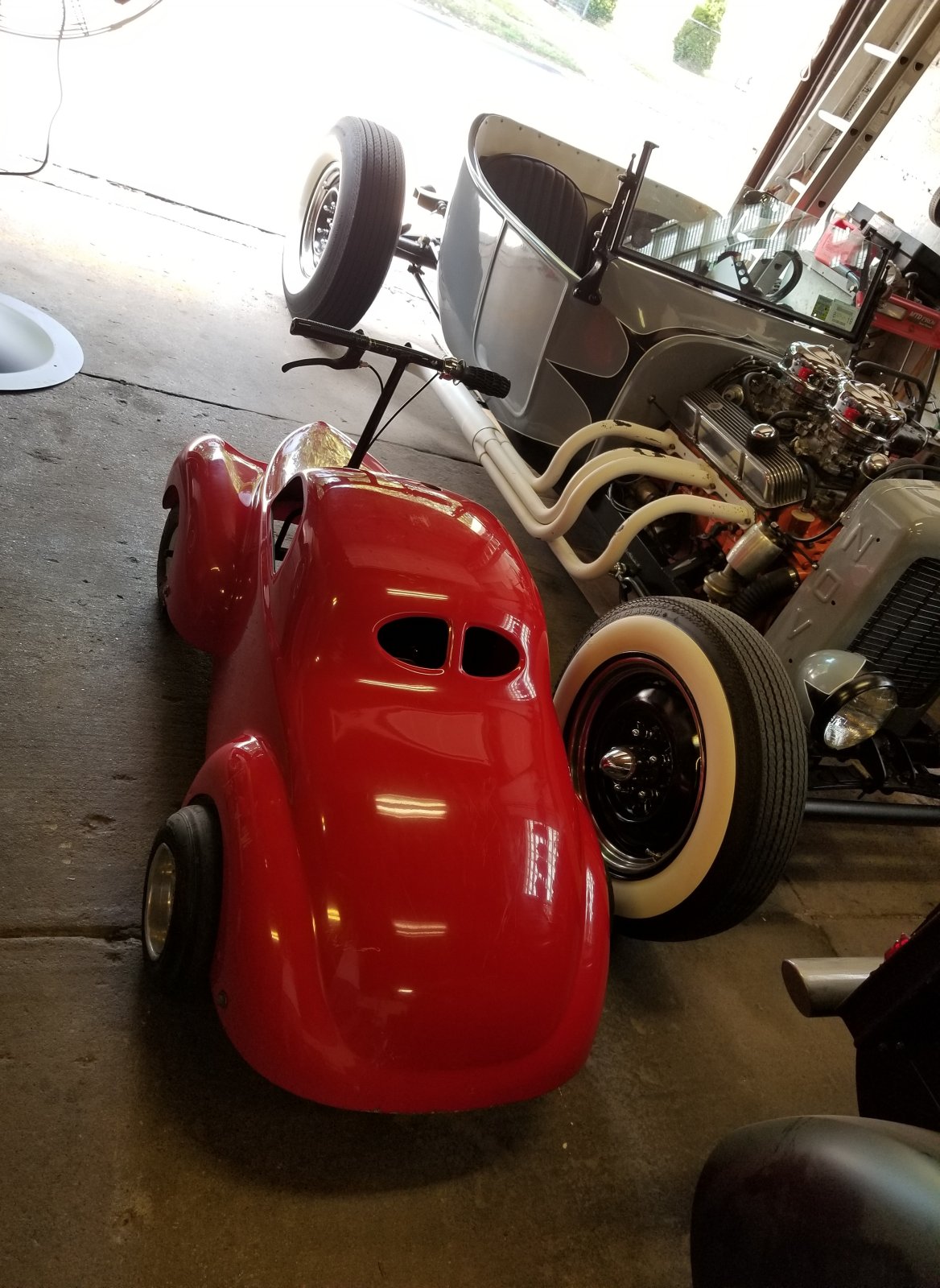

    I got "Little Slippery" up and running yesterday for the year, was on line searching (with no luck) for some foot pedals to operate the gas and brake so I can put my 10 inch Superior steering wheel on it to steer.
    I think I'm going to paint it gray like the "Hot Rod" Willys.

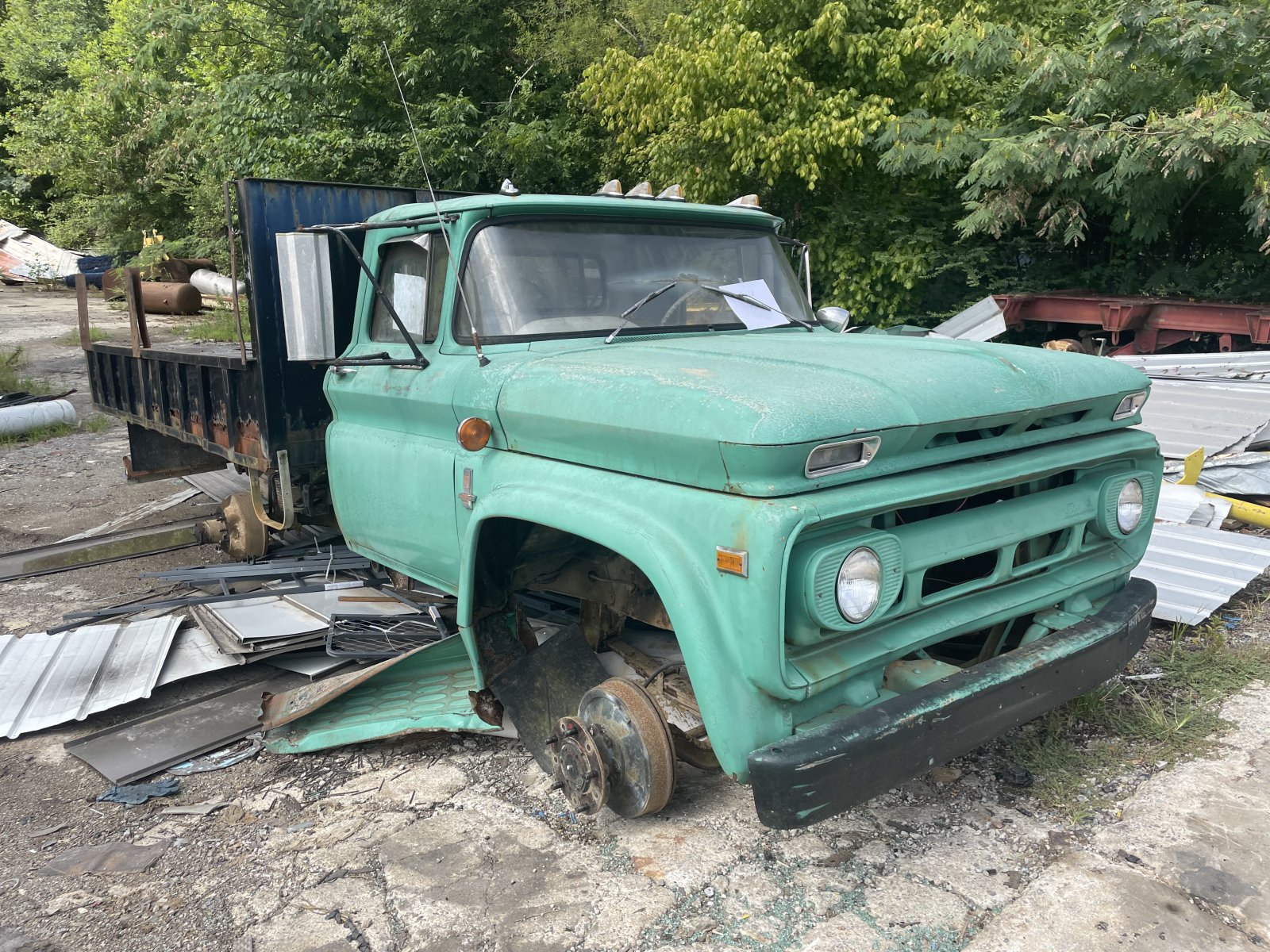

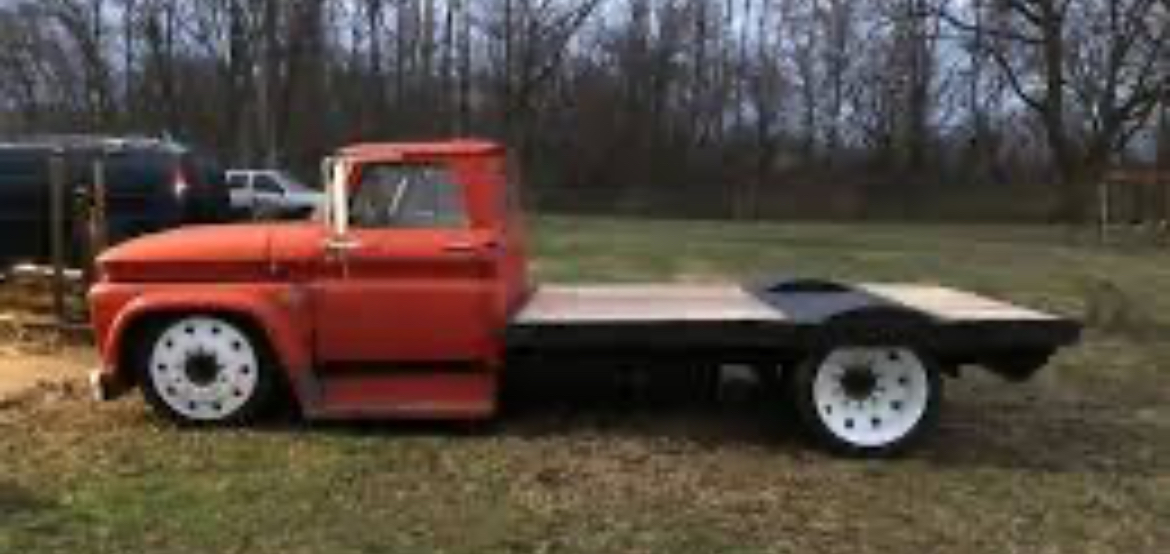

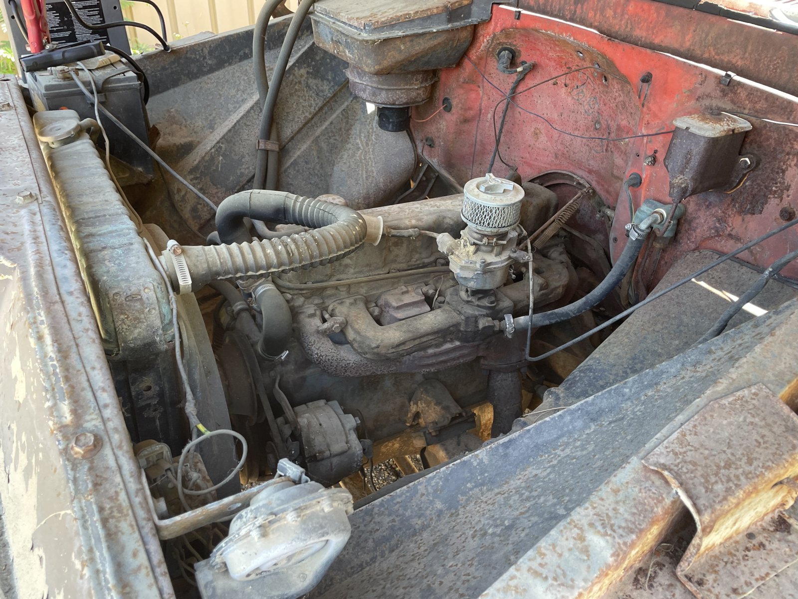

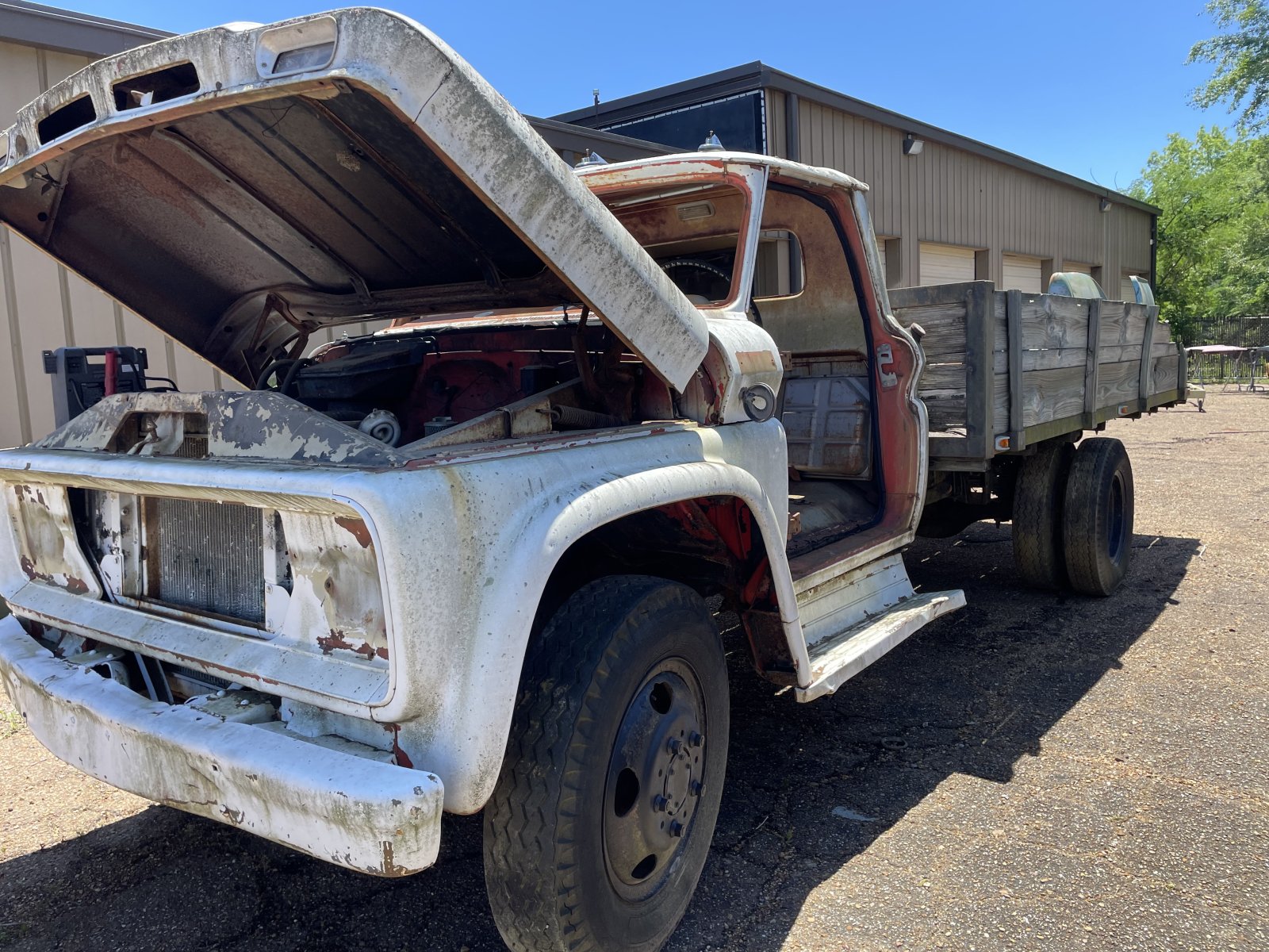

  24. Those are cool. Just got this one a couple weeks ago
    put a coil and some gas and it fired up on the first try.
    Like to use this cab on it
    Squablow, Okie Pete, ffr1222k and 5 others like this.

    Just seeing yours makes me want to go back and purchase that one I looked at. Love those big old trucks.

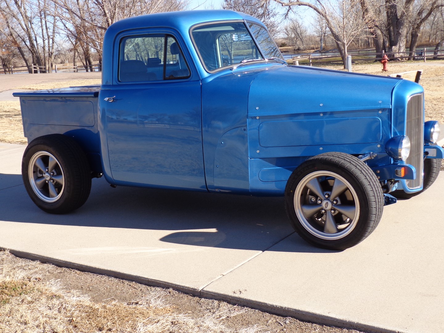

    me and my youngest put this together a few years ago. I told him I’d trade him the 2 c60s for this. It’s a c40. Basically a heavy duty c30. Has a 14k gvw. It had the small gm 5/10 19.5s. We swapped over a newer set up from a motorhome. Rear axle and front crossmember. 4 wheel discs and Hydroboost. I’d like to take the front fenders, running boards, core support and front bumper and swap it over to this truck. That would be a 8-10 inch drop just by swapping over the sheet metal.
    I’d like to do similar to this
    but do not want this
    the motorhome with the 5/10 lug is 4 inches wider in track width vs the 8 lug c30.

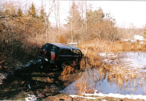

    Trying to get trusty rusty to complete it's 2 incompletes so I can get it inspected, no codes or lights, but damn incompletes.
    Might be time to cut it loose or LS swap a Yugo with it.
    Wasn't even 30 days old when I put it in a pond, took 6 tow trucks to get it out, first 5 got stuck too lol
