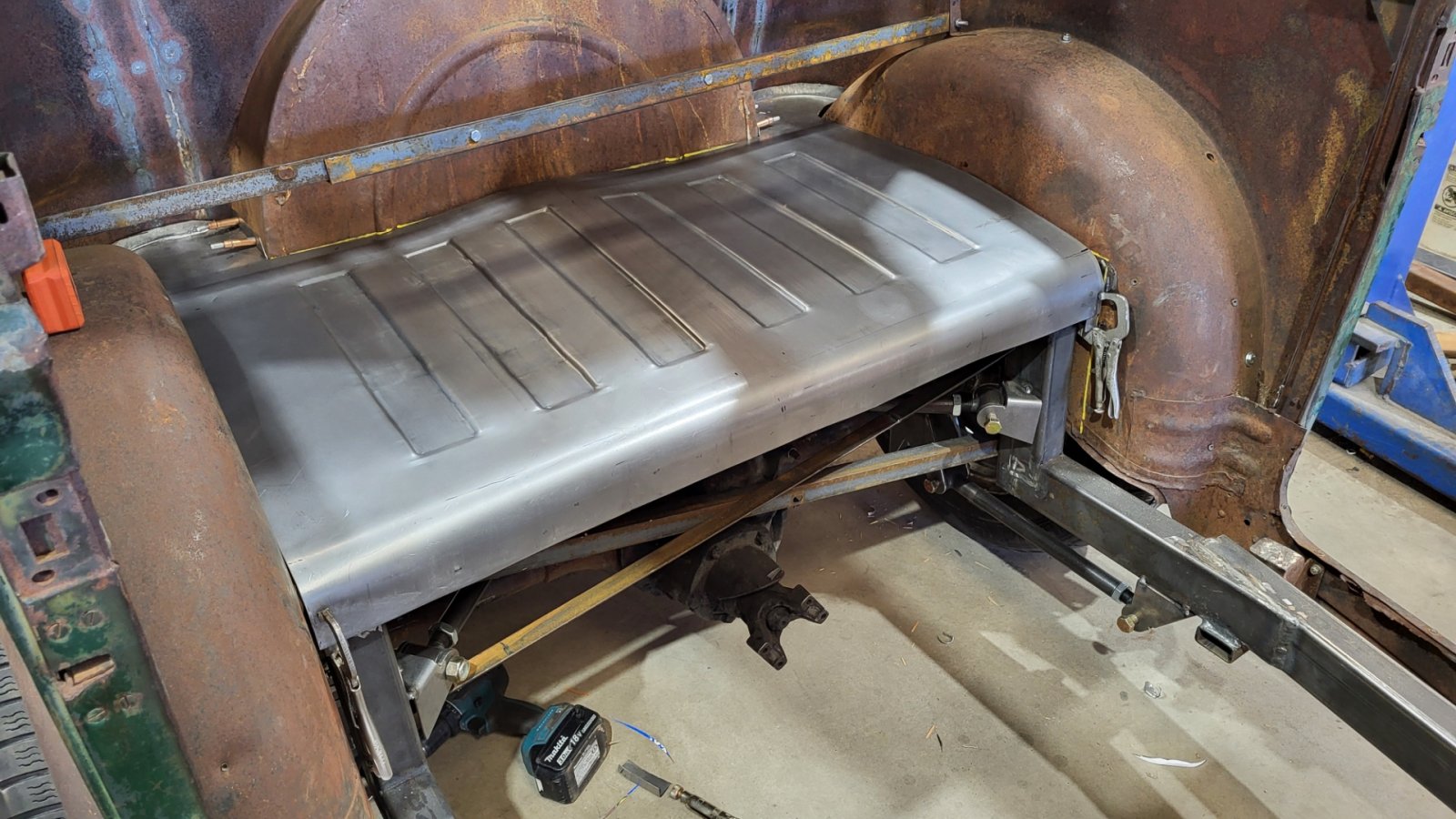

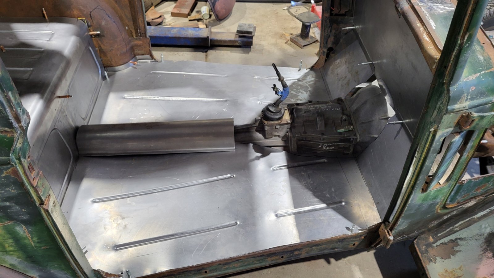

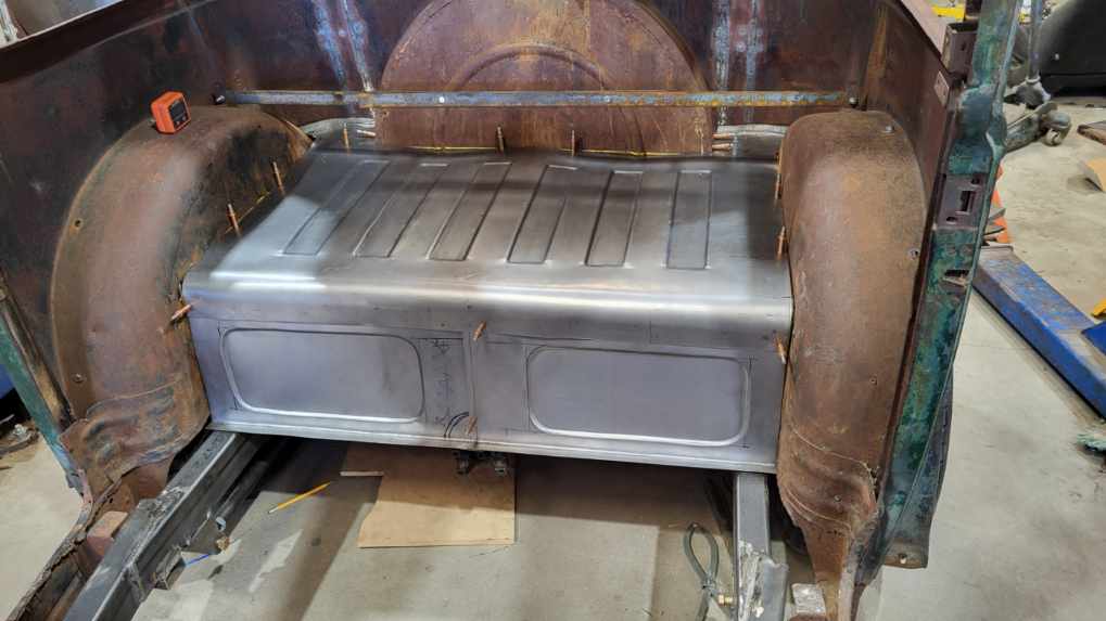

    I started filling in some of the interior decking.
    Resized_20240926_155328_1727572283653.jpeg Resized_20240927_102024_1727571919355.jpeg Resized_20240928_174603_1727571877791.jpeg

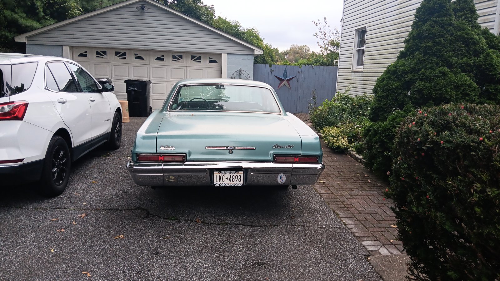

    Got all 4 springs done on the '66 Belair plus strut rod bushings, etc. I have the use of an alignment rack coming up.
    The new front springs (from Dorman) left the front absurdly high, so we took 2 coils out of them. It sits 1" lower than the OG 20240929_153454.jpg 20240929_153527.jpg 20240929_153549.jpg springs and rides much better.

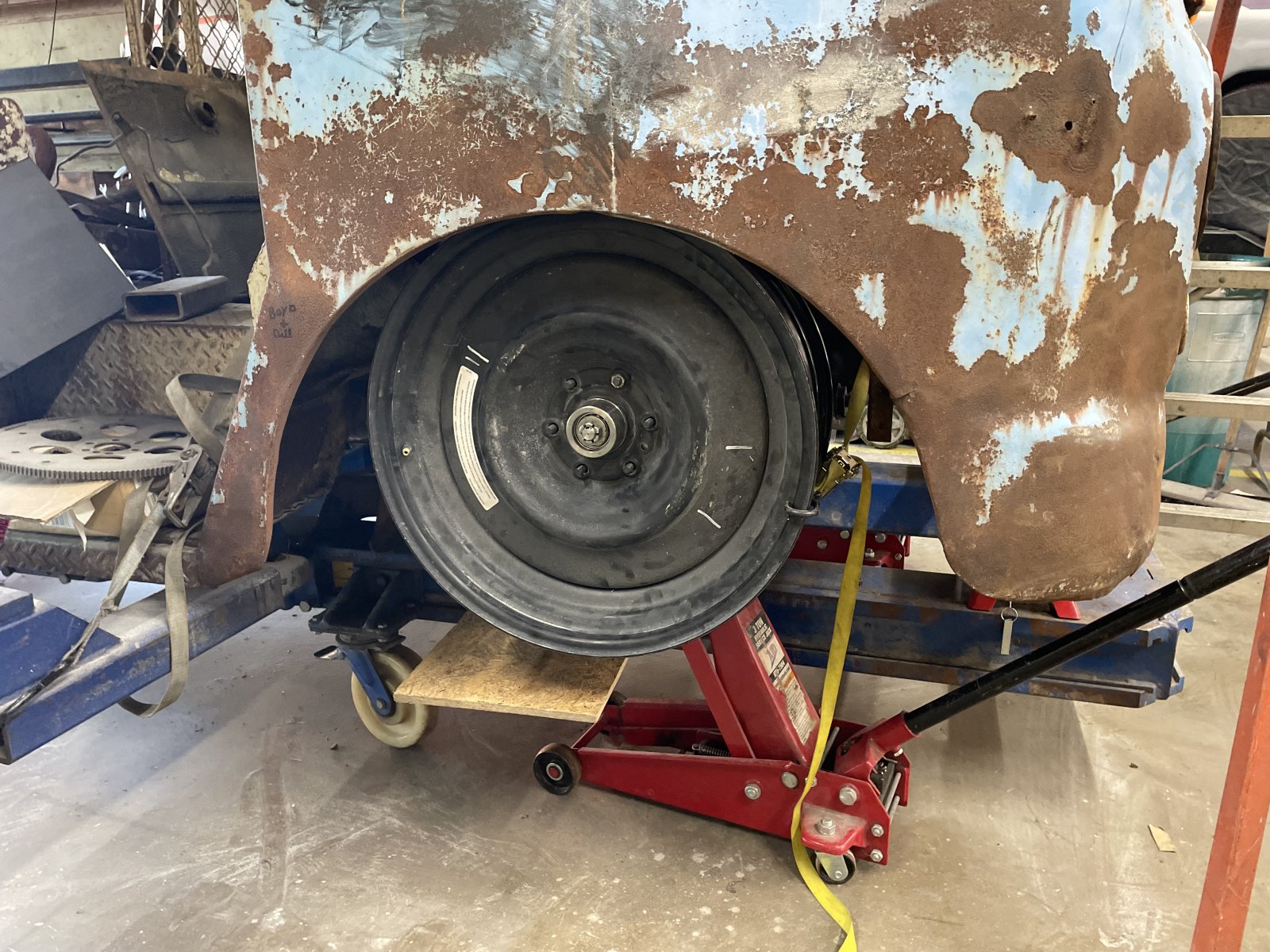

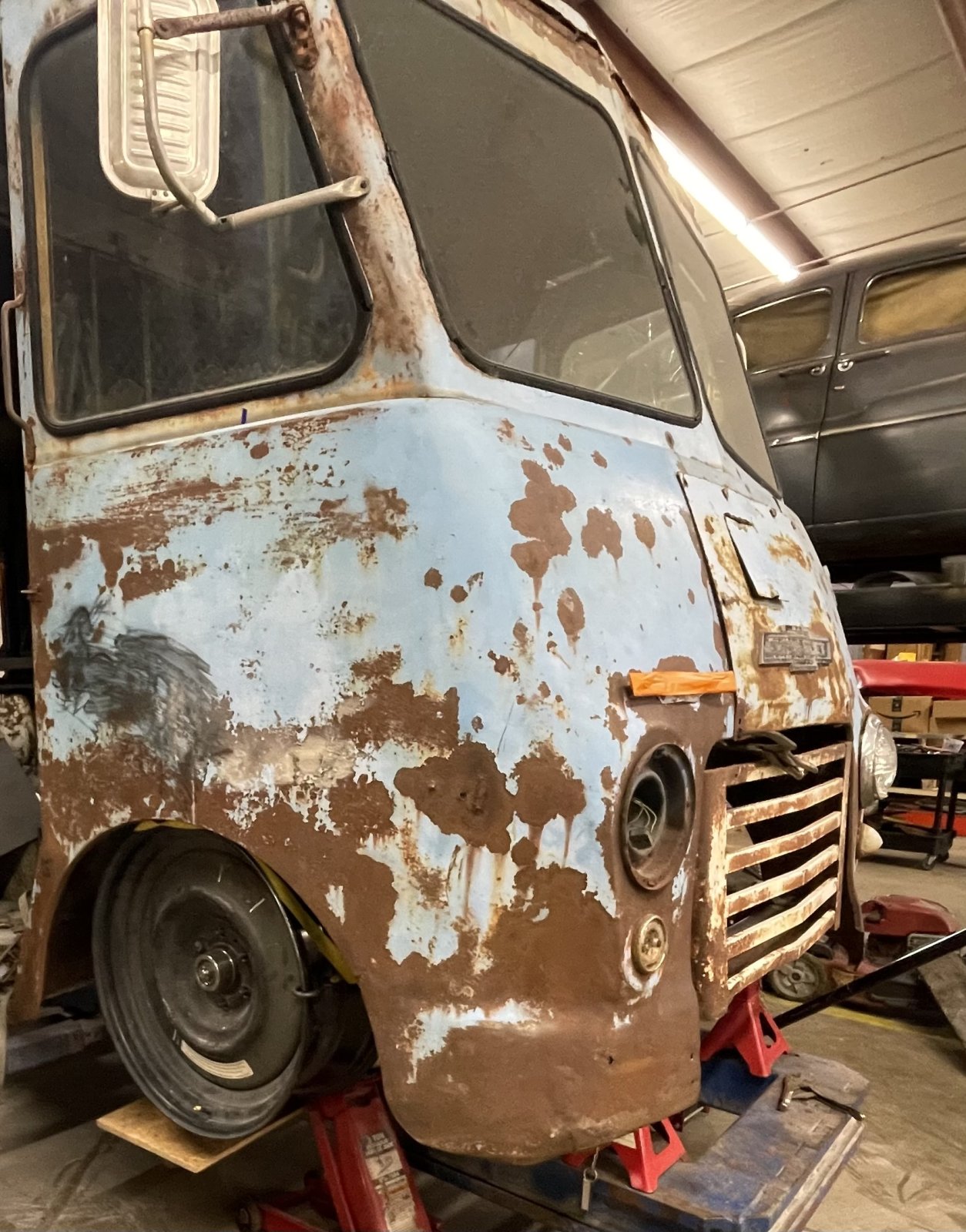

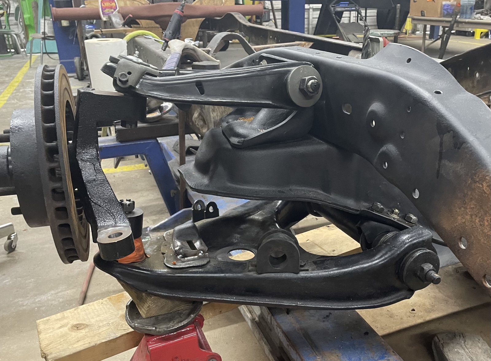

  4. Modified the bump stop mount
    This should yield a 5 1/2 to 6 inch cruising bumper height
    6 lug rotors just got here so now we can test for the 22s

    The Belair had a pull to the left, went under and worked the driver side strut rod, now it is world's better.

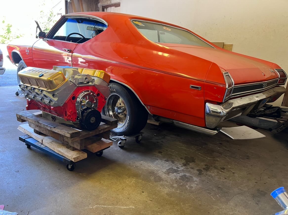

    Got the 396 back from the machine shop the other day to go back into my good deed for the year project. 1969 chevelle ss that belonged to a friend of mine's late father, has been stored in the garage for a few decades with a broken lifter and wiped out cam, and im getting it back up and going for her and freshening things up

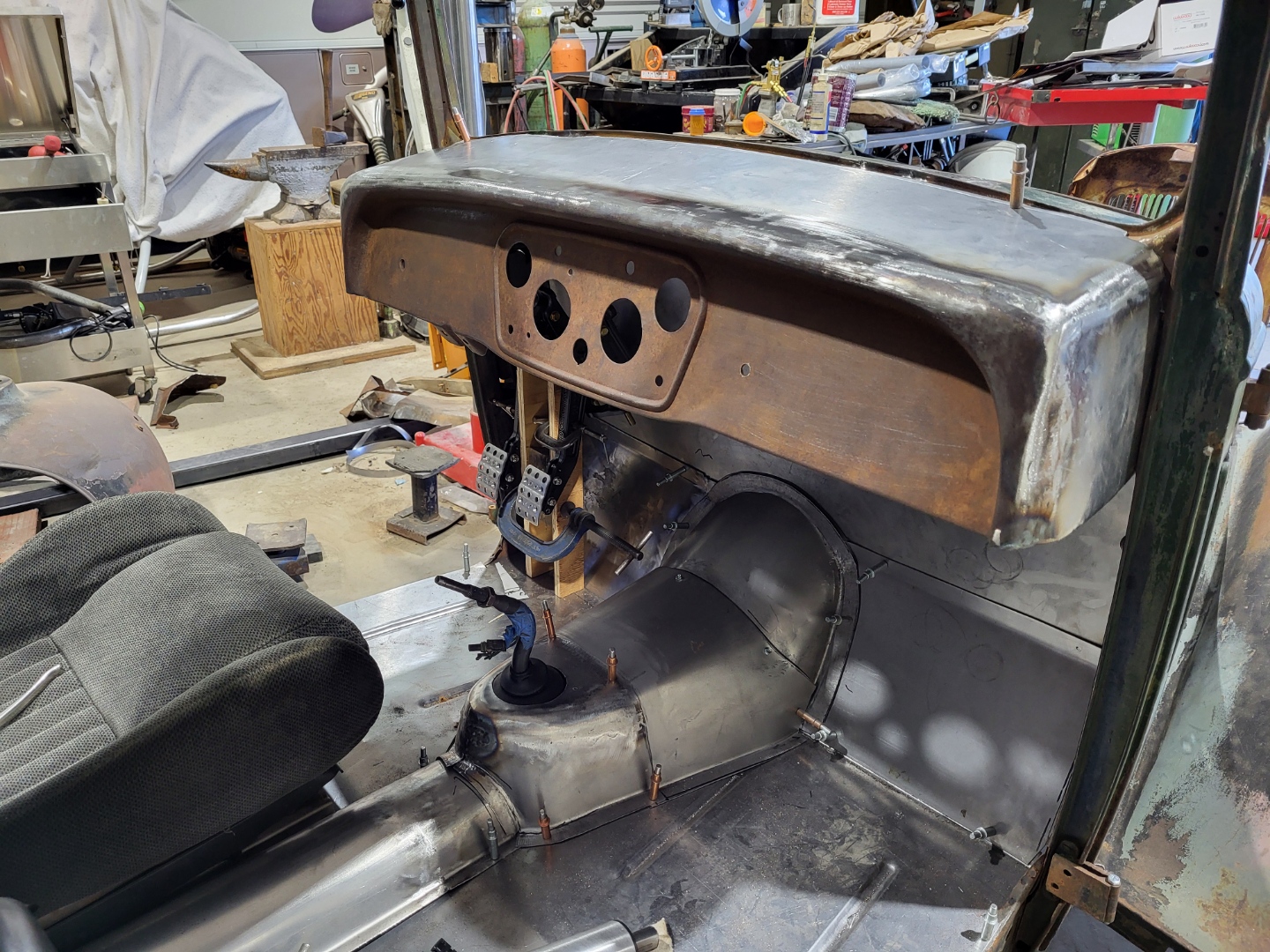

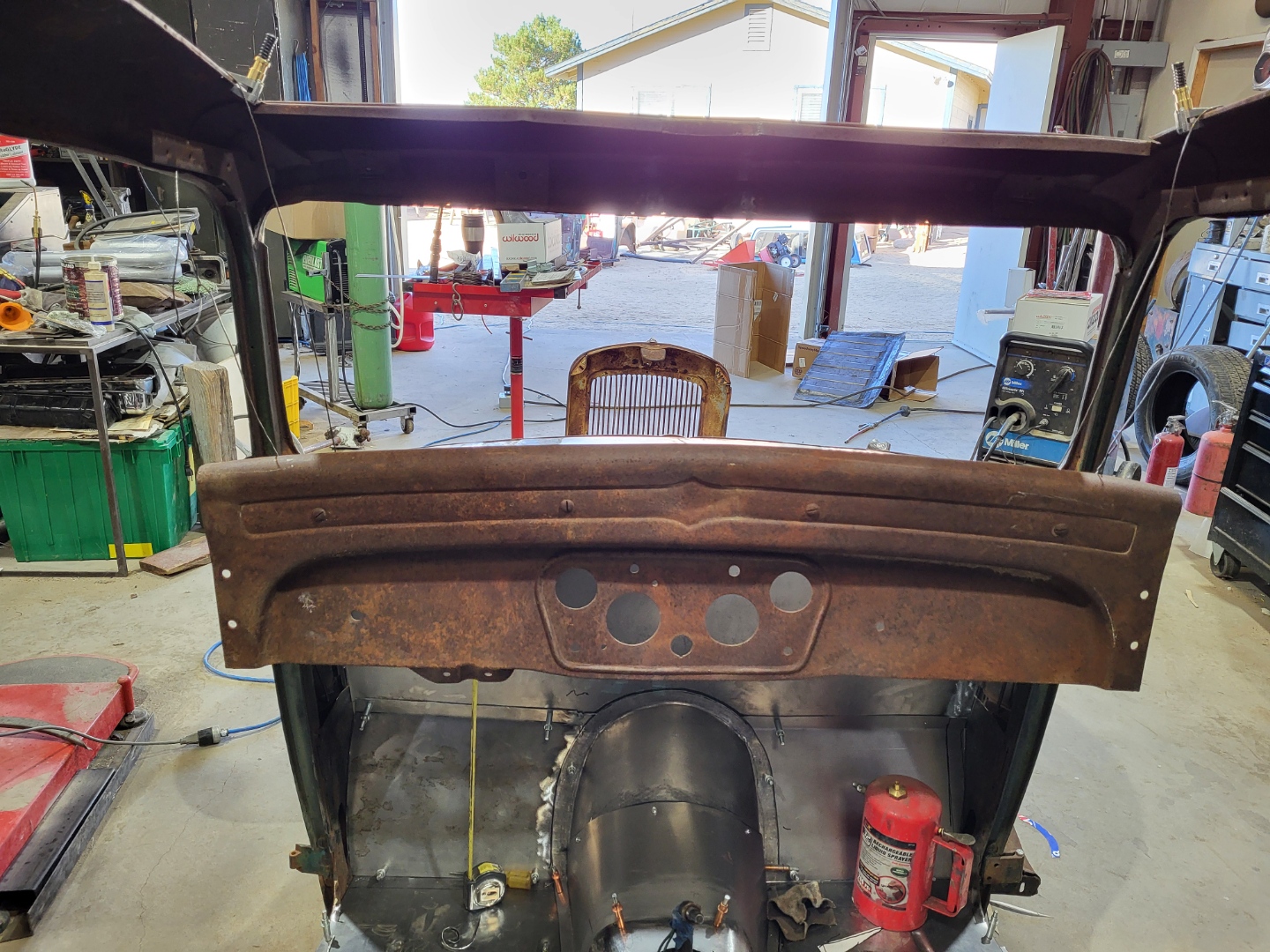

    Picked up a dash last year for a wall hanging that turns out to be a '32 Chevy that fits perfect with a little modification.

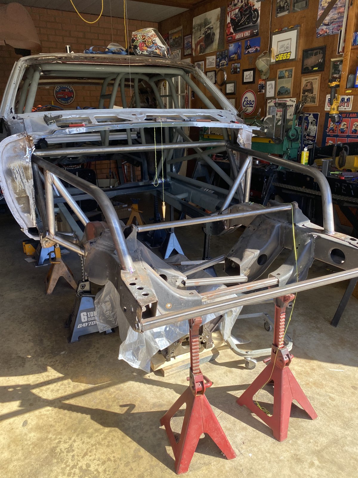

    HOTRODPOWELL

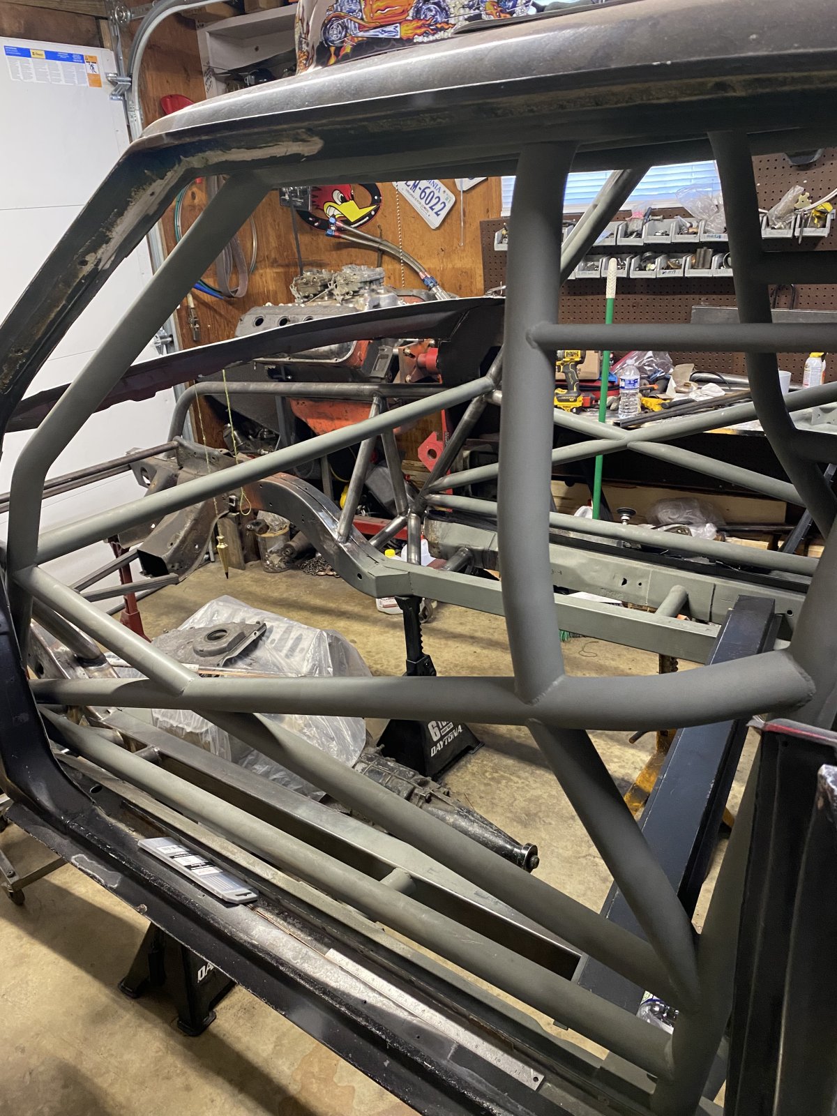

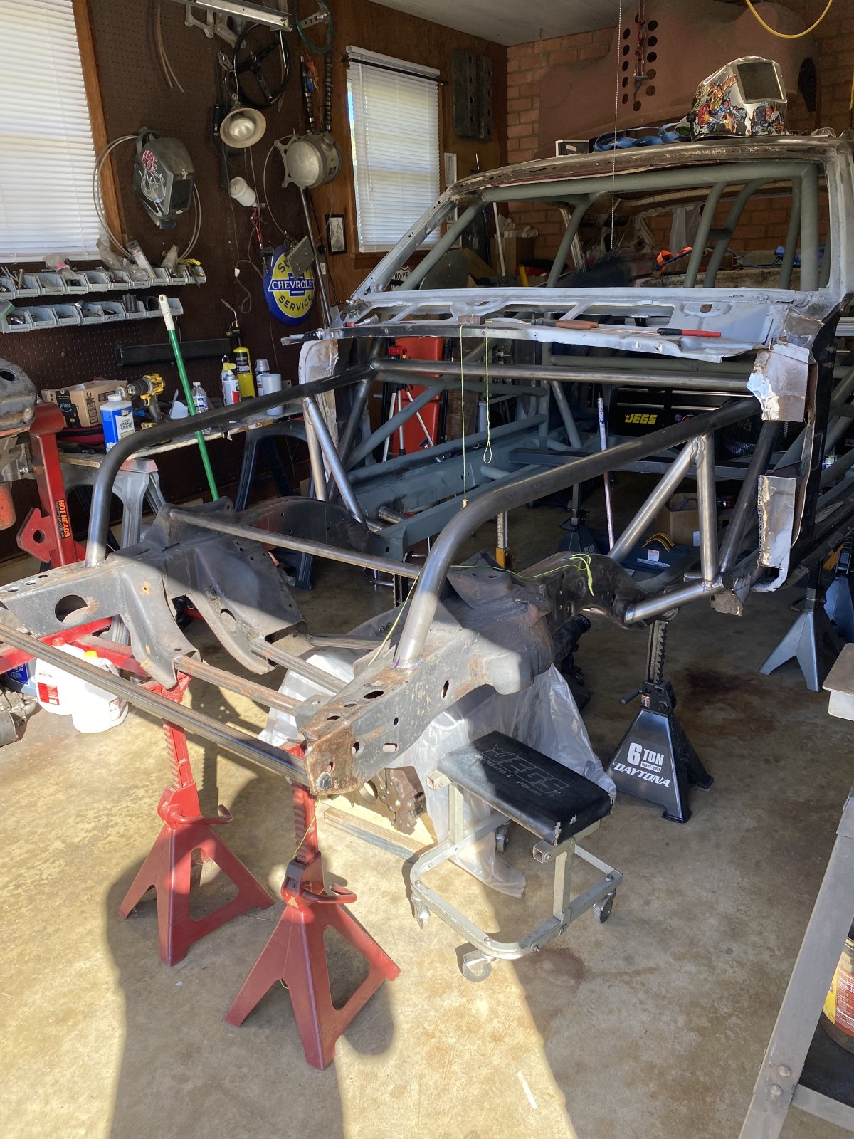

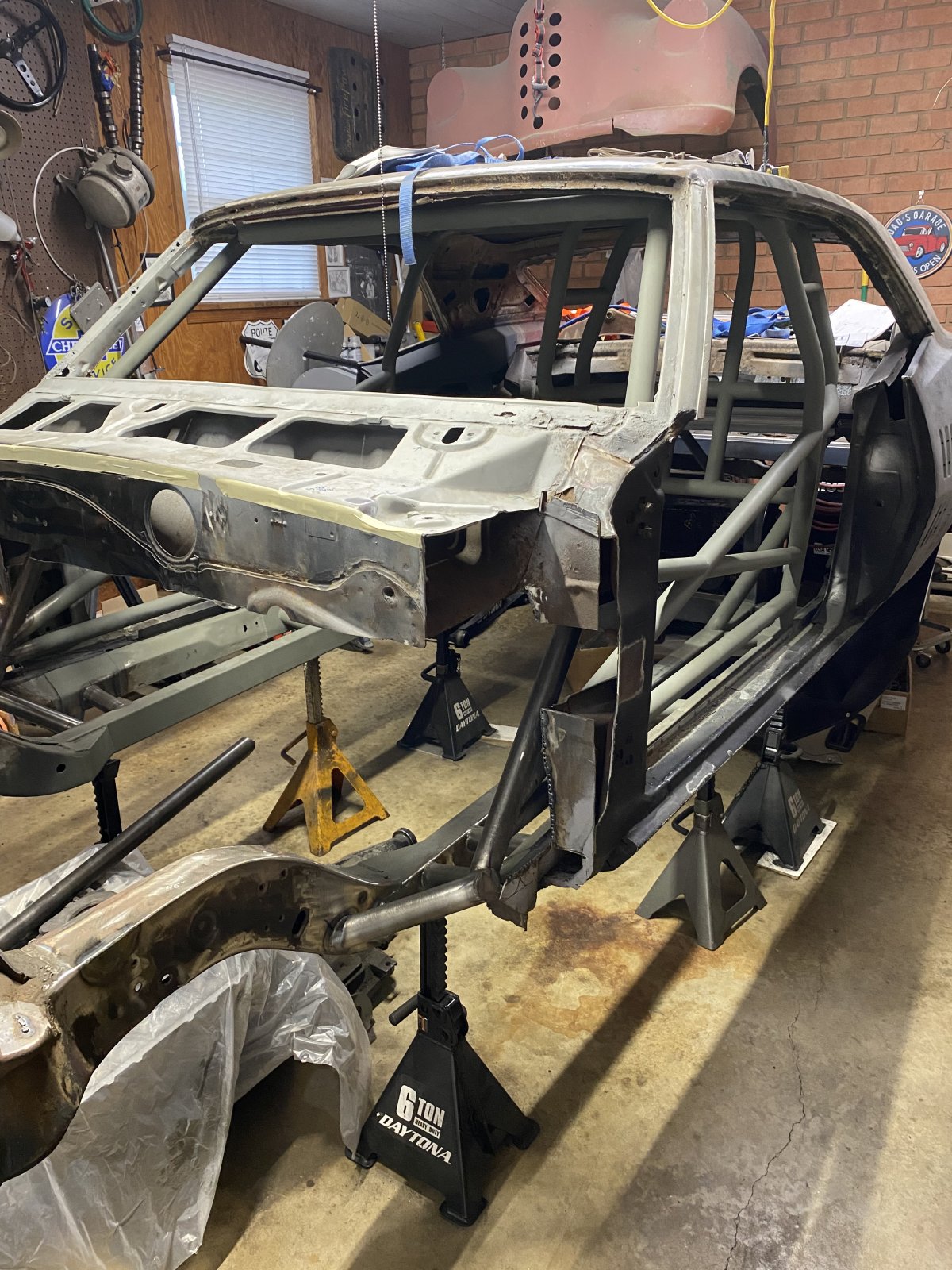

    Camaro bird ch***is is coming together A9504956-CA72-4C24-B57C-7069AAE09742.jpeg D3B8D7A2-A410-46F1-80DC-B6D039166AB4.jpeg 08DA3A97-DC28-4944-9118-D3EC38AD67D4.jpeg

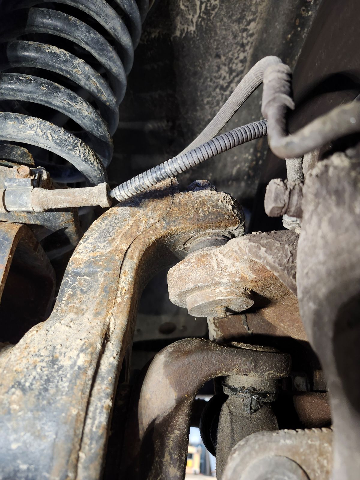

    image000001.jpeg The F550 bucket truck at work. Went to grease the upper ball joints-sigh WHY!
    I figured out if I rotated the wheel “just right “ I can fit the grease gun between the yoke and U-joint, just barely makes the angle.
    A 90 degree zerk would have been nice.

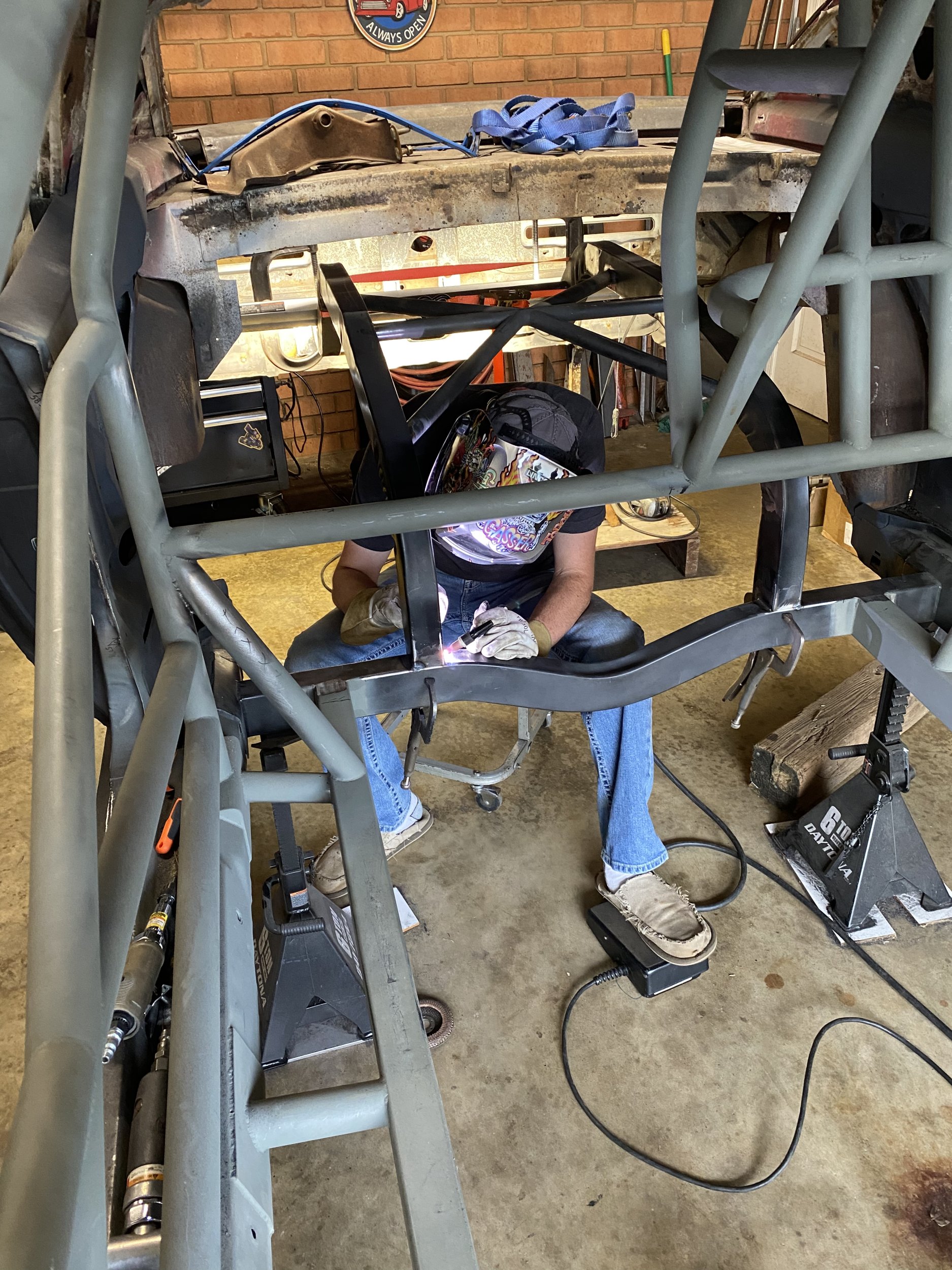

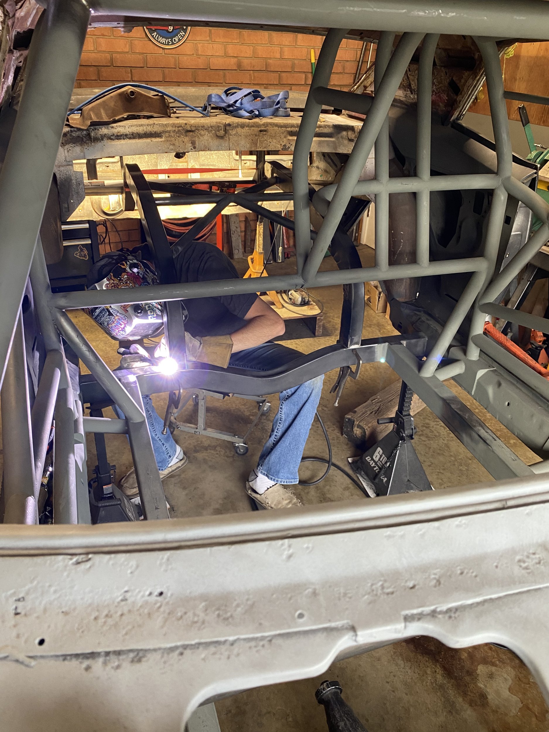

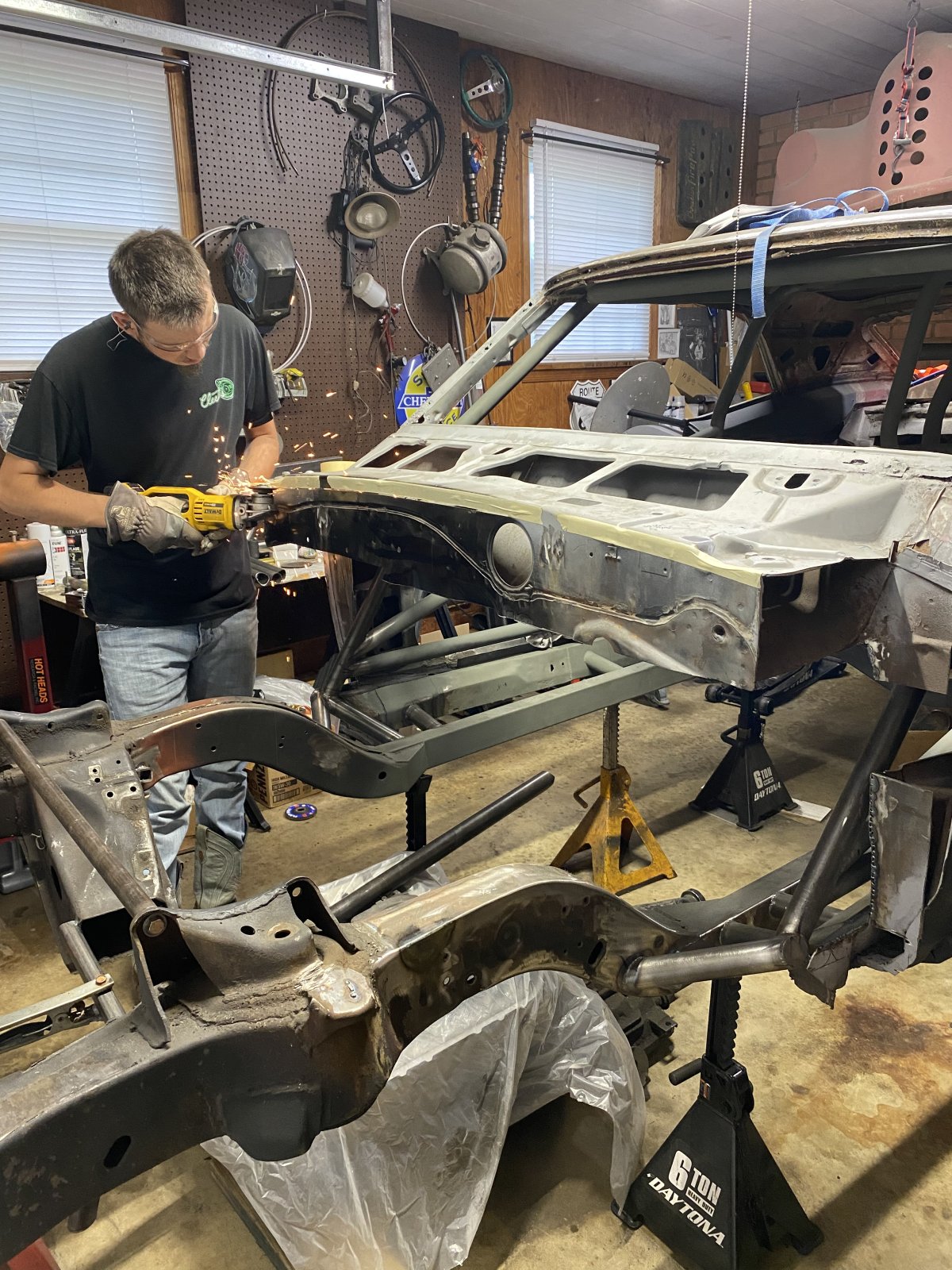

    This Kid makes me so mad DFB4E178-CB52-4CB4-B20A-AB1461129C7E.jpeg D32C4D37-0642-4DD2-A08B-48B92027A2C4.jpeg
    He can weld with either hand after 30 years I still can’t do that

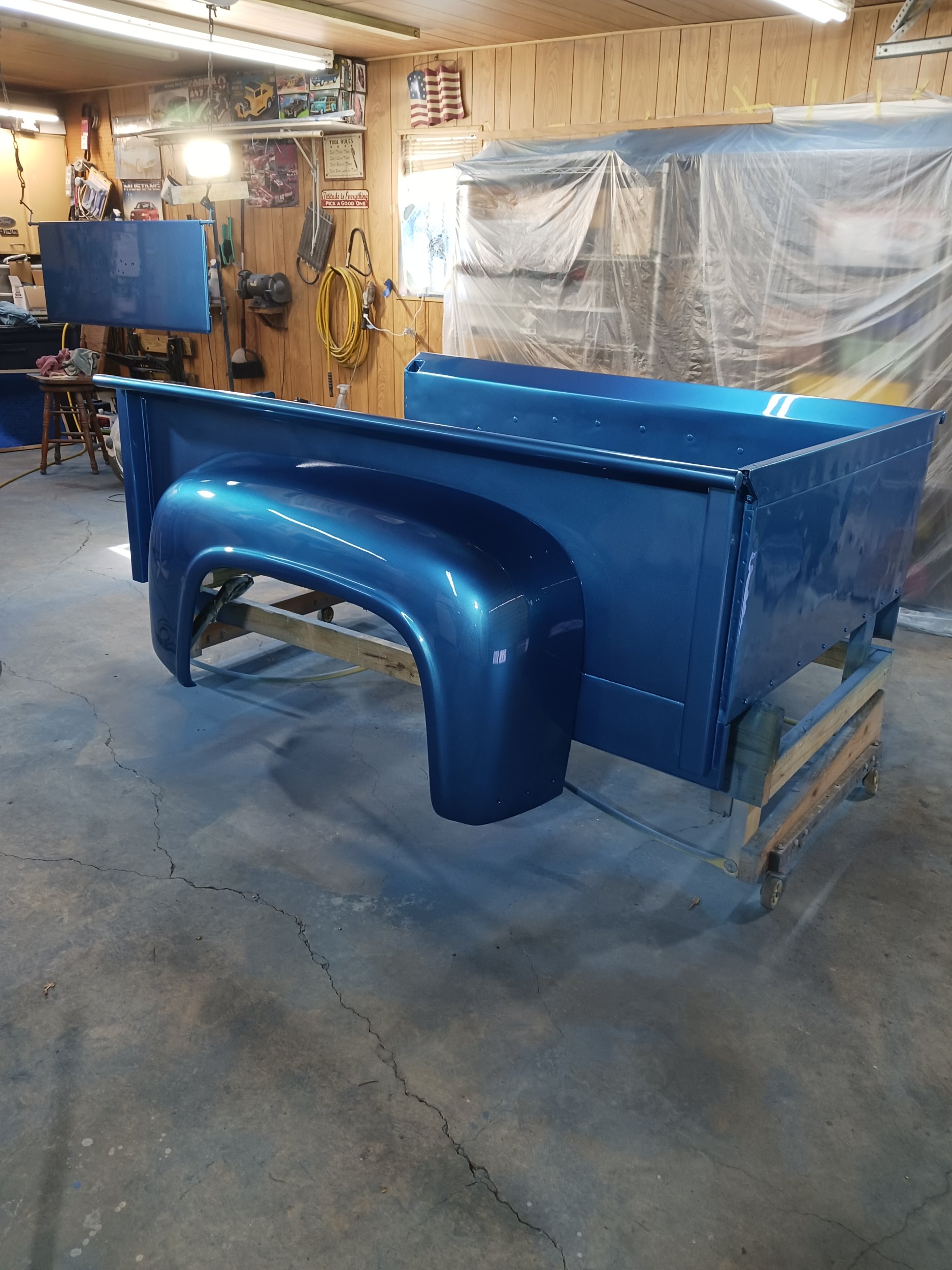

    Painted my bed today.

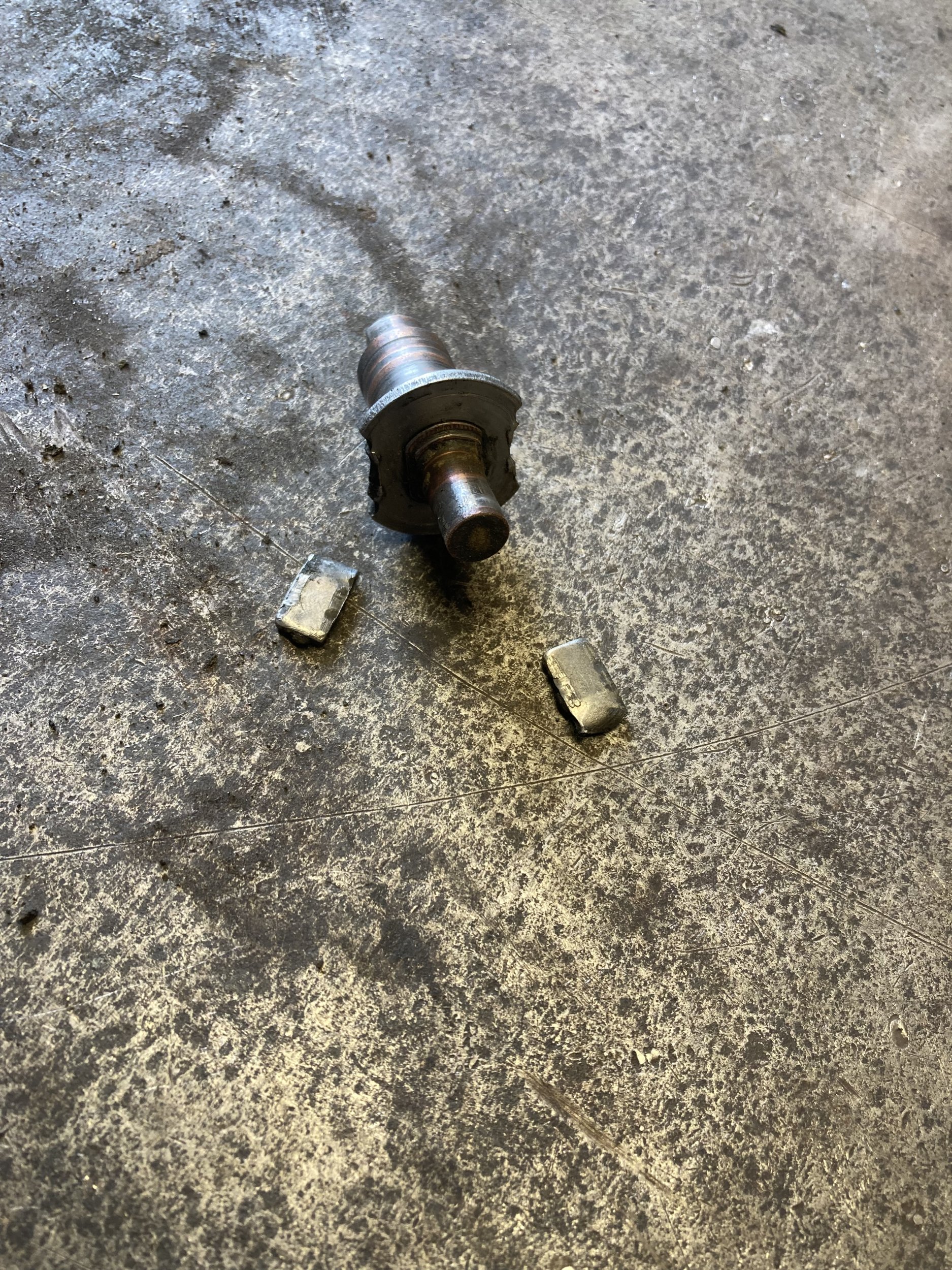

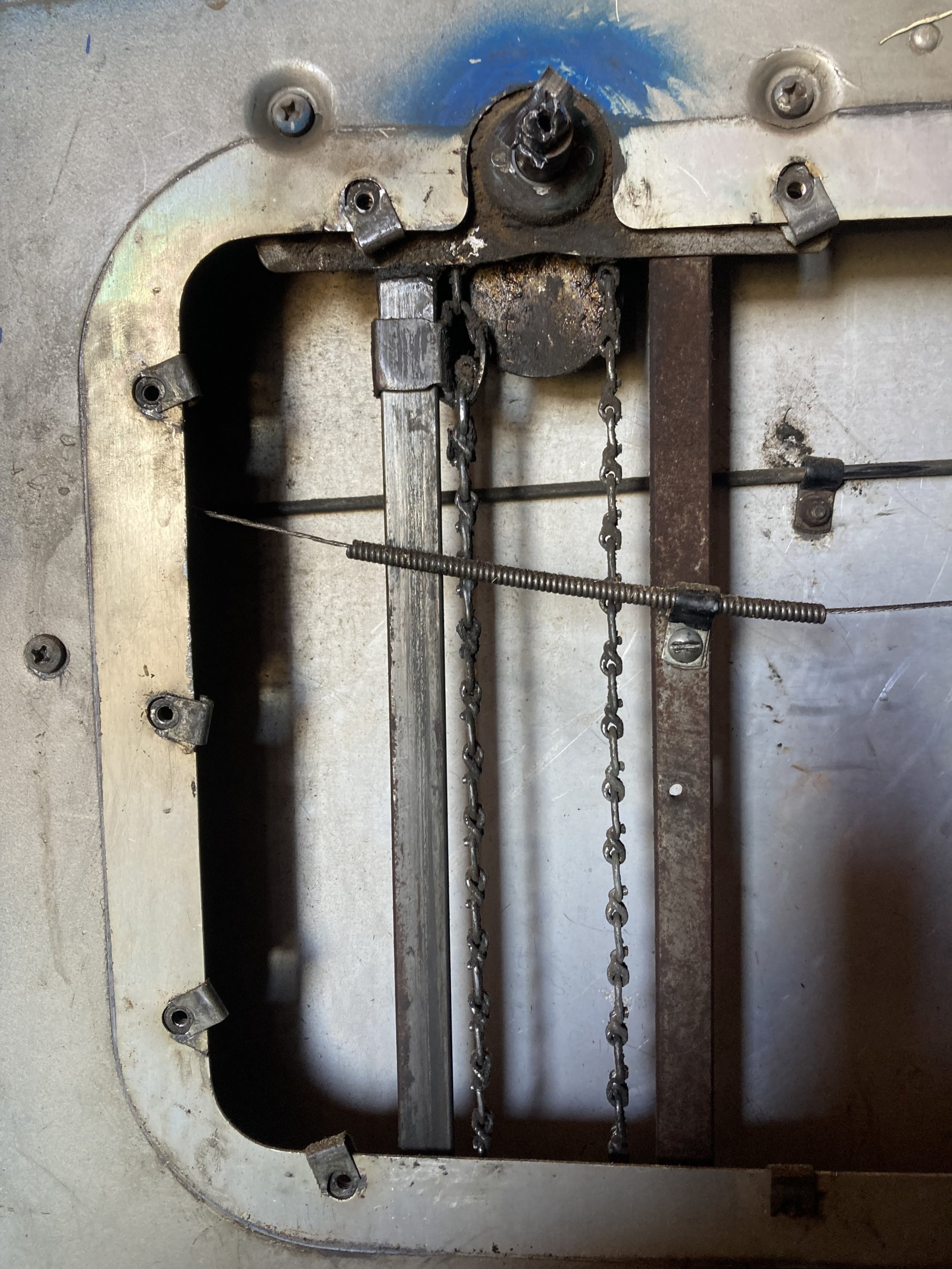

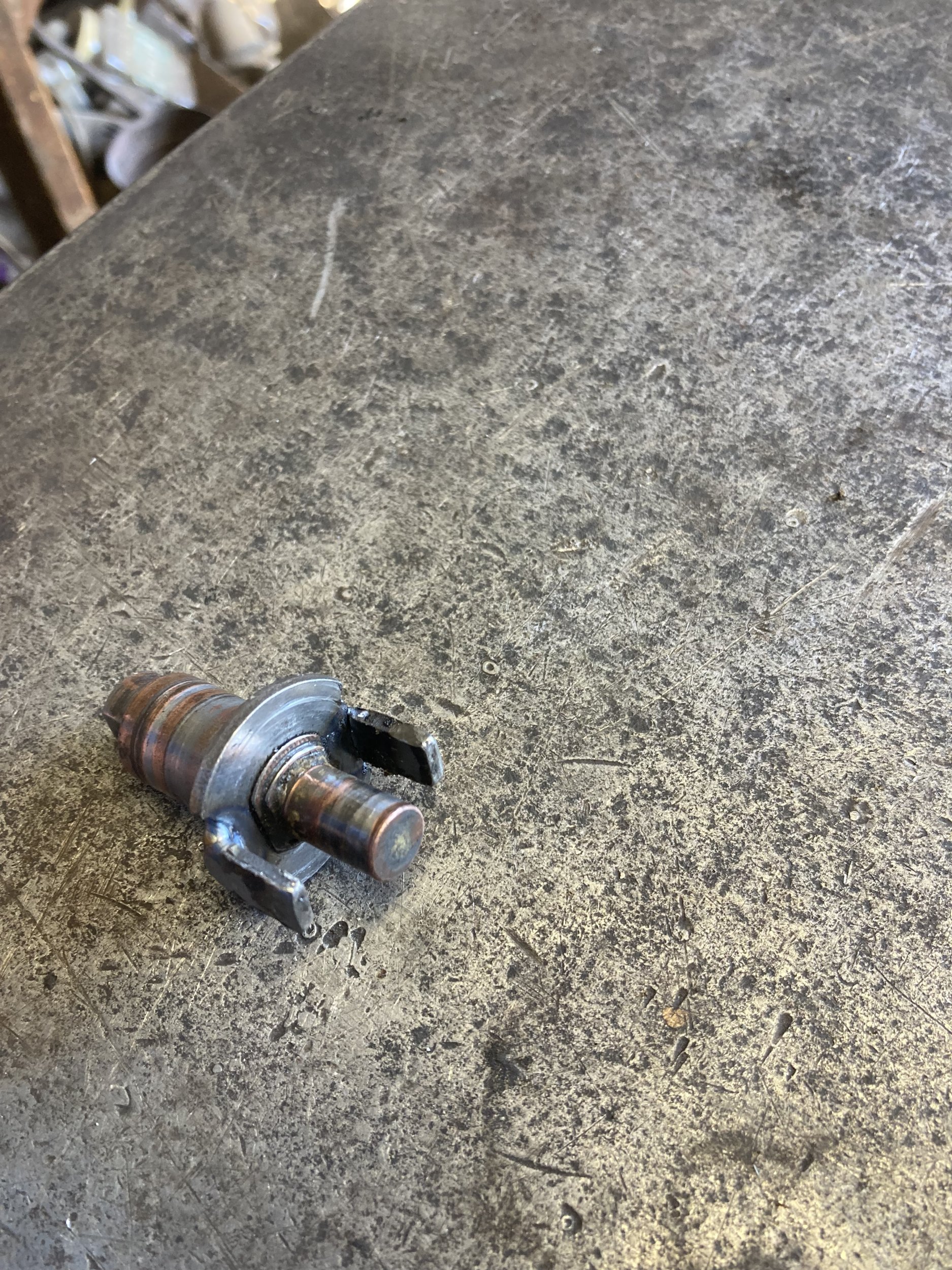

    IMG_0137.jpeg IMG_0176.jpeg IMG_0188.jpeg IMG_0189.jpeg W900A 1966 the drivers window wouldn’t roll down . Took it apart and found the ears on the crank shaft were broken off . Welded them back on and it works good as new . There are new replacements but after picking one up there are differences . There 3/8” thick spacers where it bolts on to the door . The shaft the handle bolts on is 3/4” longer than the old one . So I repaired the old one .

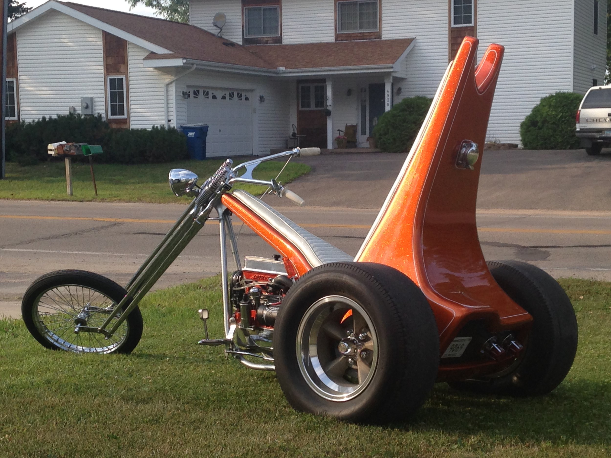

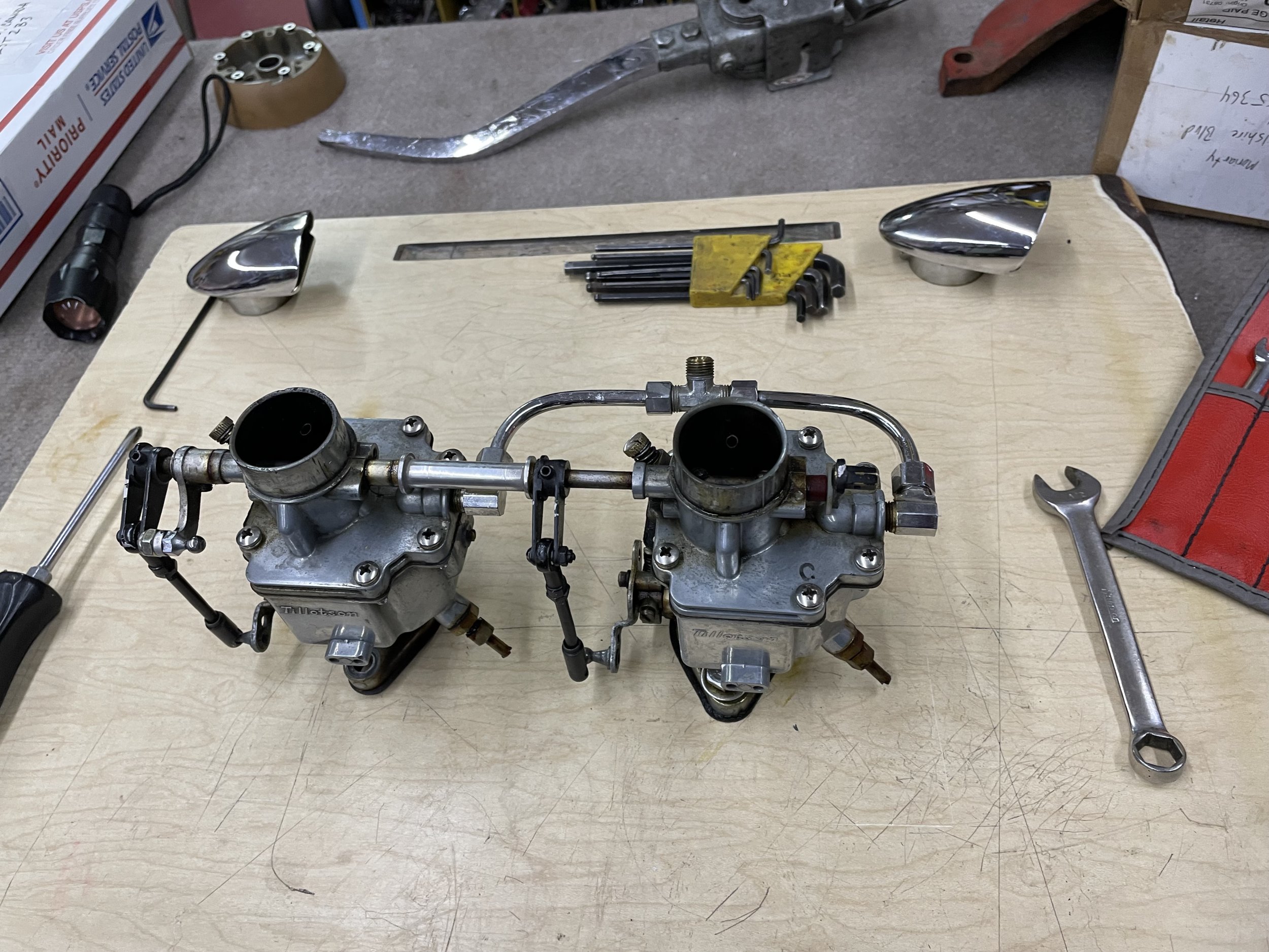

    Going through the carbs on my crosley powered chopper trike

    Running like a champ, Mark. Hope you went for a ride.

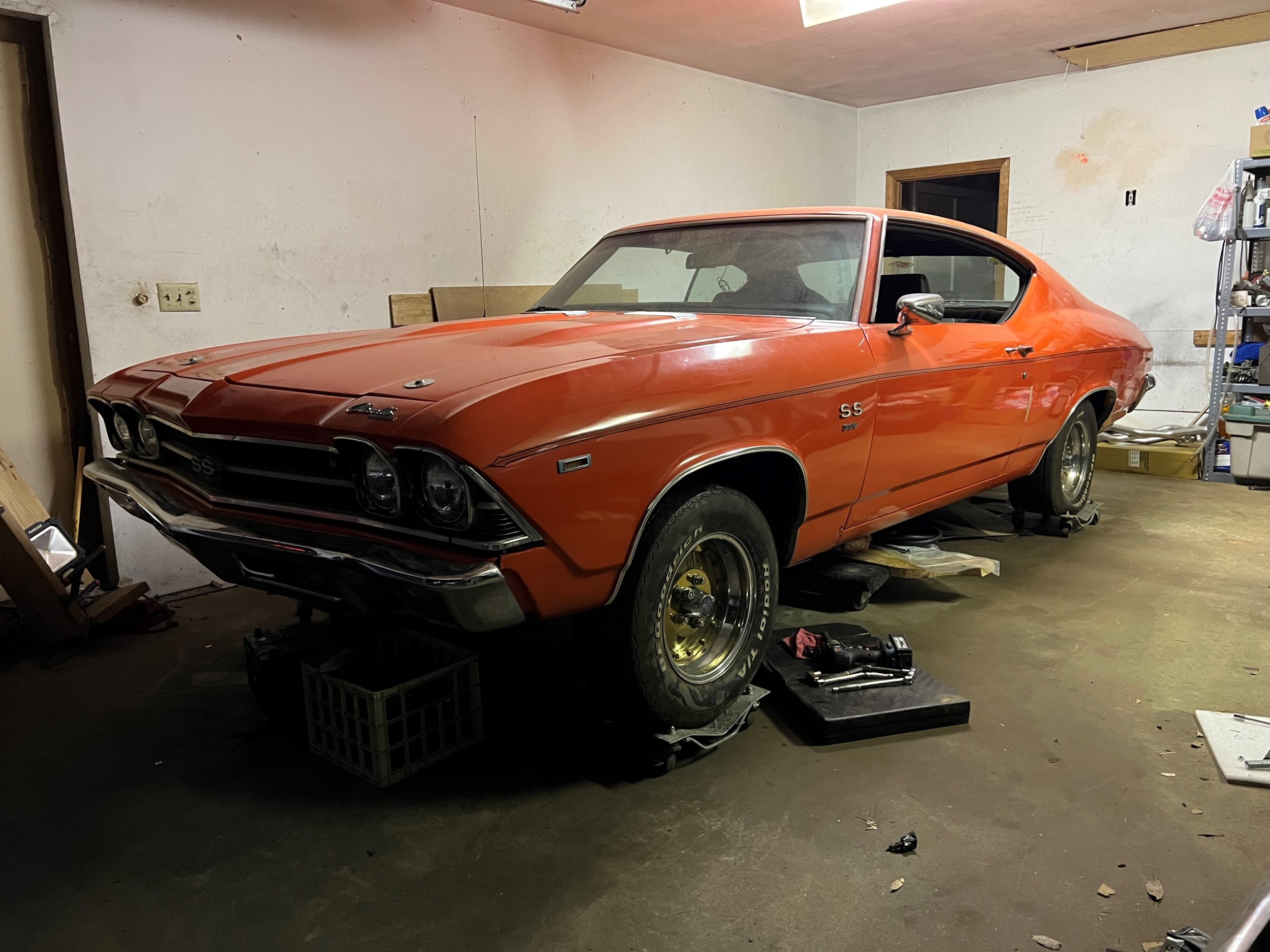

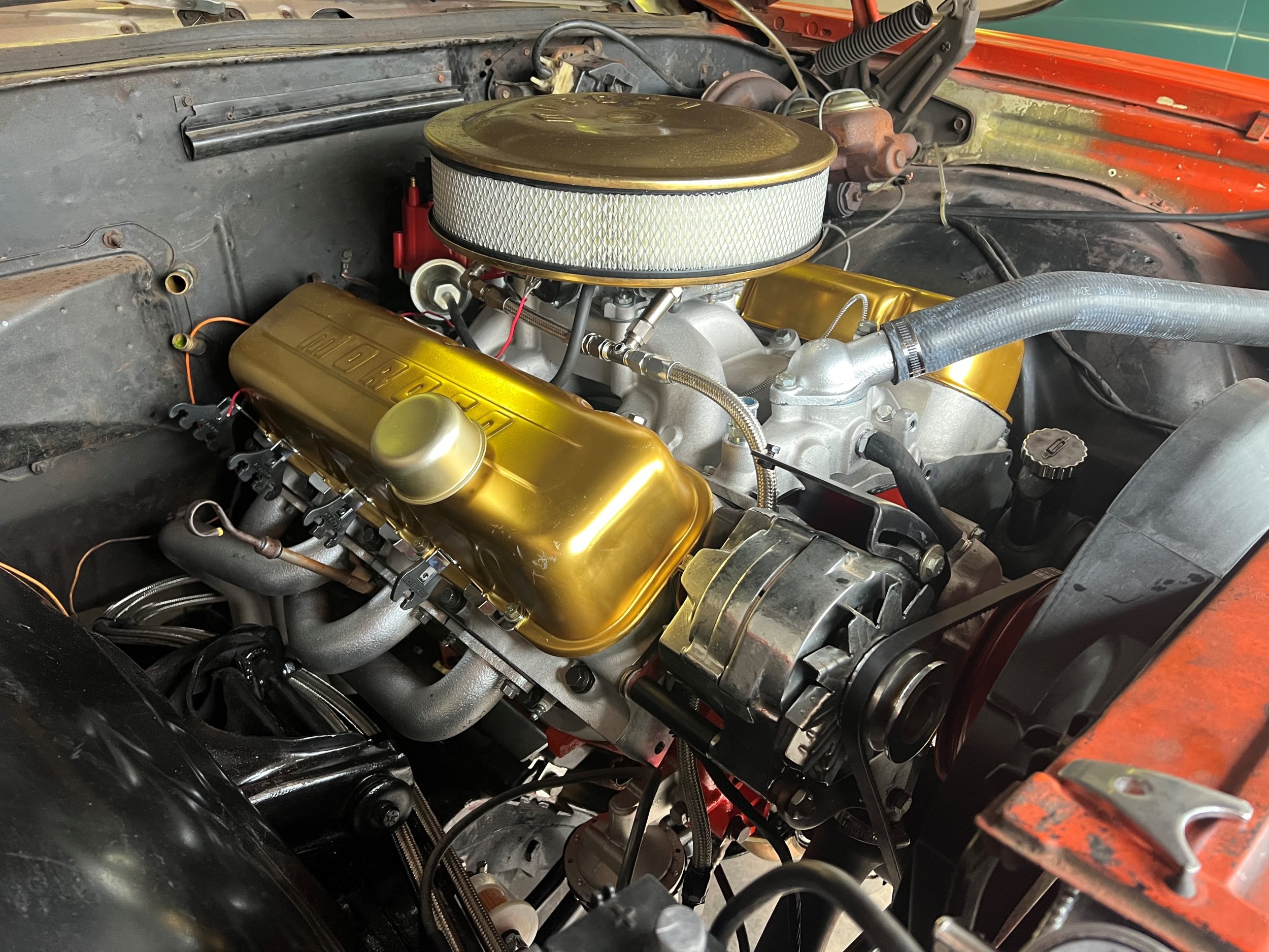

    Plugging away on the Chevelle SS that im doing for a friend, that belonged to her late dad, and at my normal lumbering break neck speed :rolleyes:, but making progress. Its alot of going through and fixing/ replacing either stuff that has fallen apart in the 20+yrs its been sitting or the stuff that was maybe mickey moused/ half ***ed decades ago. Should be ready to fire up this weekend. (it is a girl's car now and ive lost a few compromises, so pictures were taken before the bright pink spark plug wires were put in :()

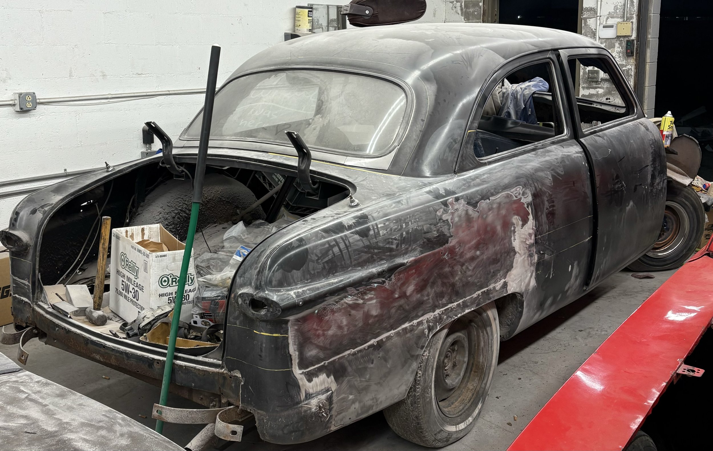

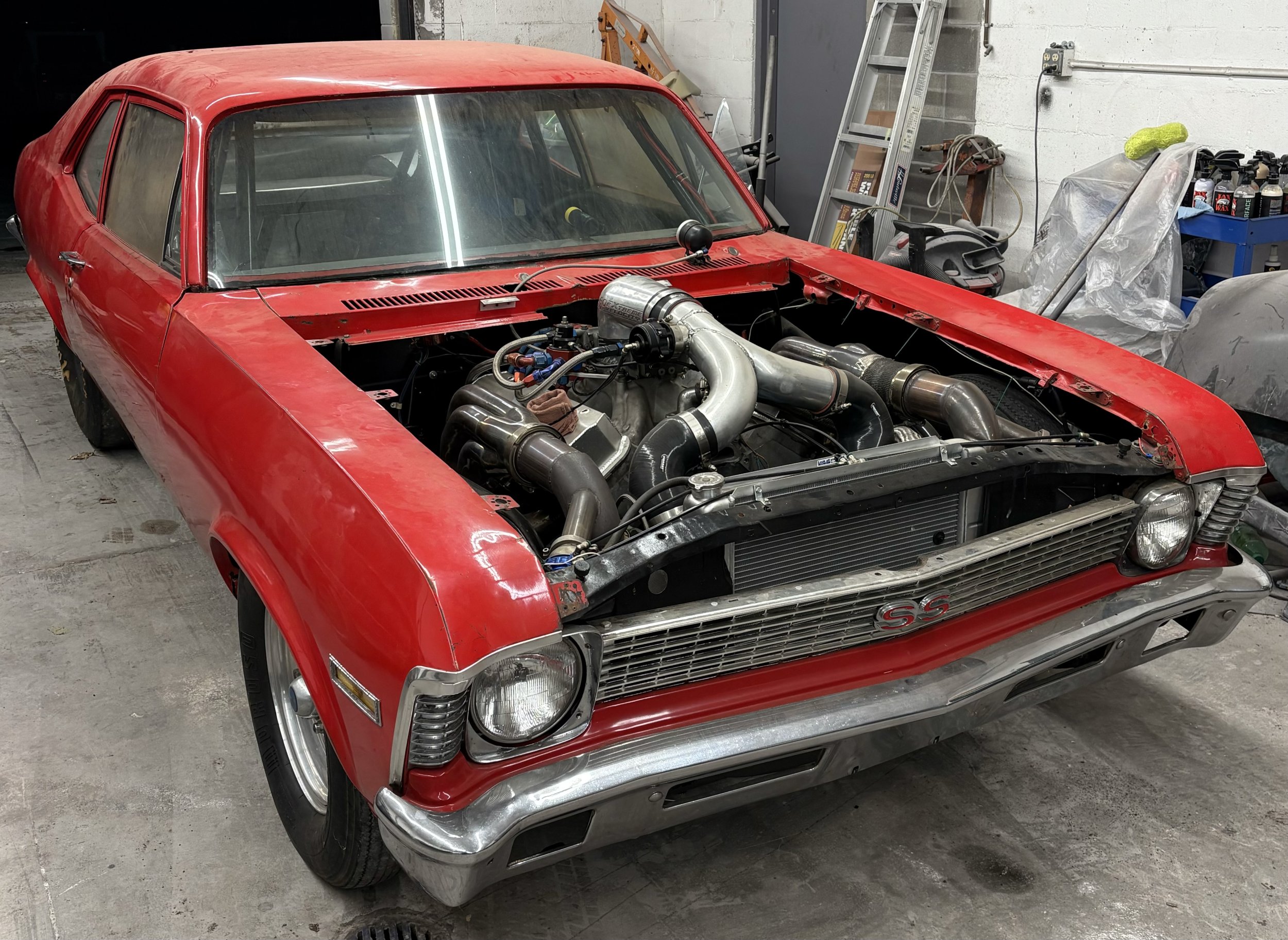

    Brothers Camaro blew a brake line, been redoing those. While he ended up trading it for dad’s nova, so got both those in the garage while mine got moved to the side. As I slowly sand away on it. IMG_0112.jpeg IMG_0113.jpeg IMG_0114.jpeg
