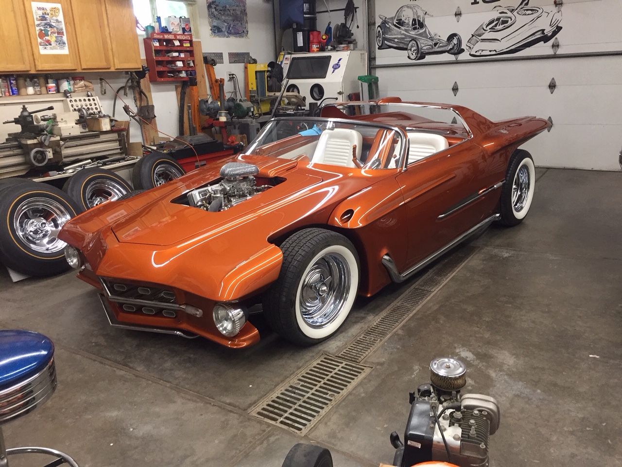

    For actual paint jobs, it will always be tough to beat PPG. But, I've got a friend that is the paint guy at NAPA and I have him match and mix me up all my paint for everything else.
    I know a lot of guys that use Summit's house brand with good results, too. If I get around to doing a driver type car I might try them next.
