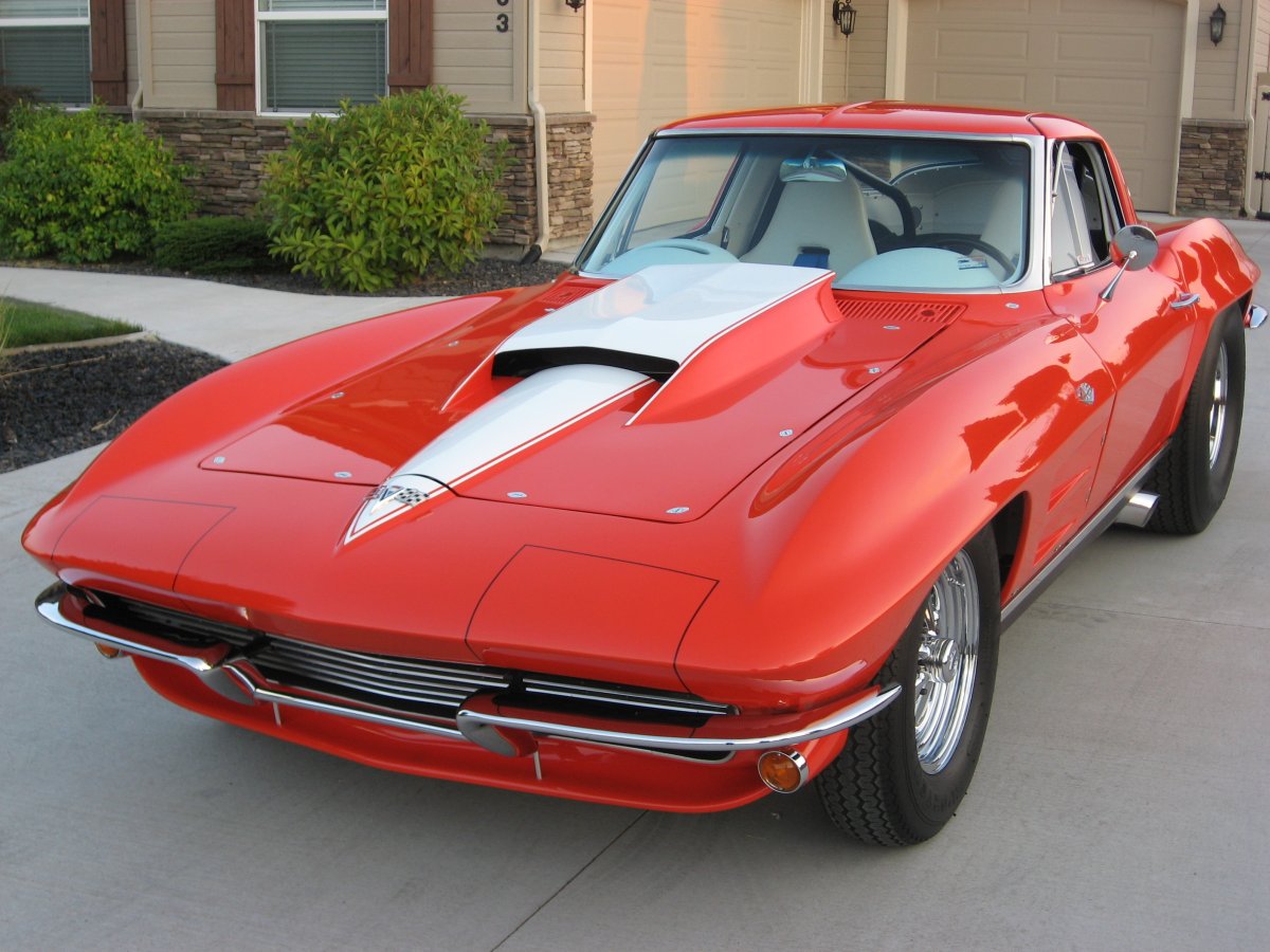

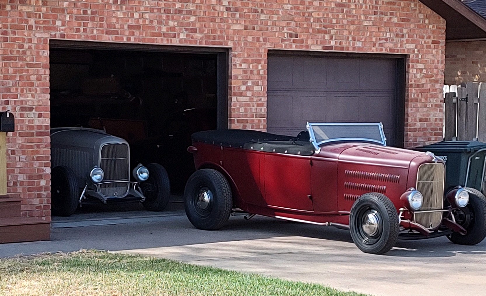

    Also used PPG on my phaeton. This was $28 a quart and the catalyst was $36 a quart' it took 2 quarts of paint and one half quart of catalyst. 8561.jpeg Part_1 (17).jpeg
