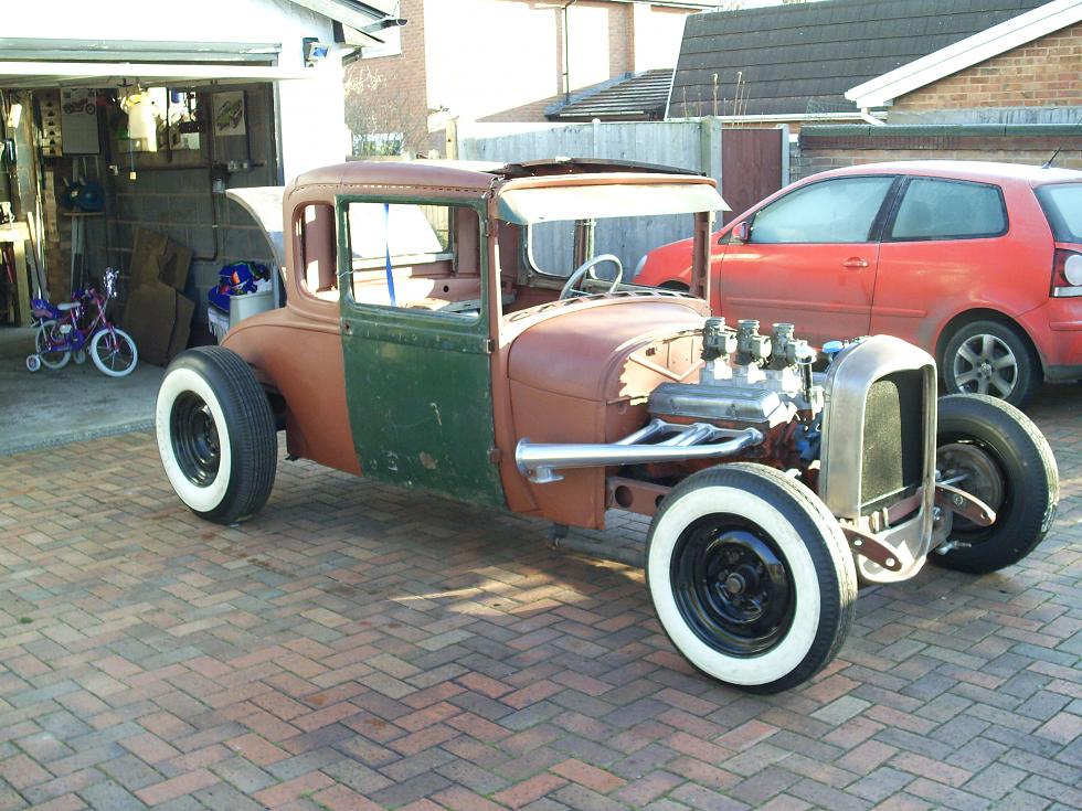

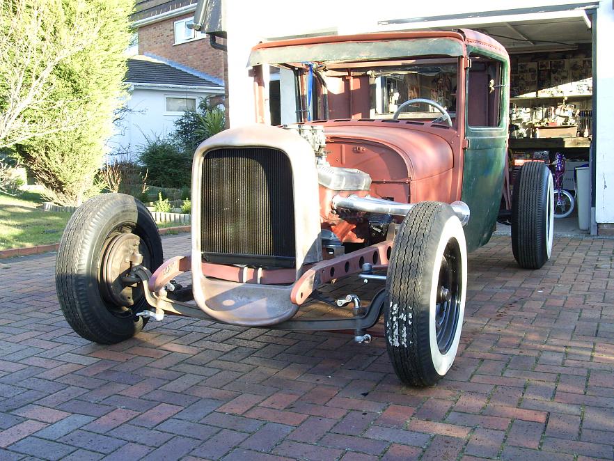

    inkoret, yes mine's 'Z'd and channelled,but my radiator was 1'' too high, so I've unchannelled the body 1''.I'm sure with a bit of work you'll get your friends radiator to look right, heck I'd rather have a low radiator rather than a high one!These are the best pictures I've got I'm affraid.

    You wouldn't happen to have a side profile would you? I'd like to see how it slopes down, yours looks just right.

    inkoret, Best I've got at the moment, if can wait till tomrrow I'll take a picture full side if you like.
    Aw Shit, just noticed that me bloody avatar!!!!!!At least it'll go bigger, give you some idea!

    Nick...you have a great looking car............

    Mine is a 40 ford rad that they narrowed to fit a 32 shell, Then they added a Rad mount that drops down under the frame as shown above. Never has dragged or hit anything with it but its pretty stout just in case.
