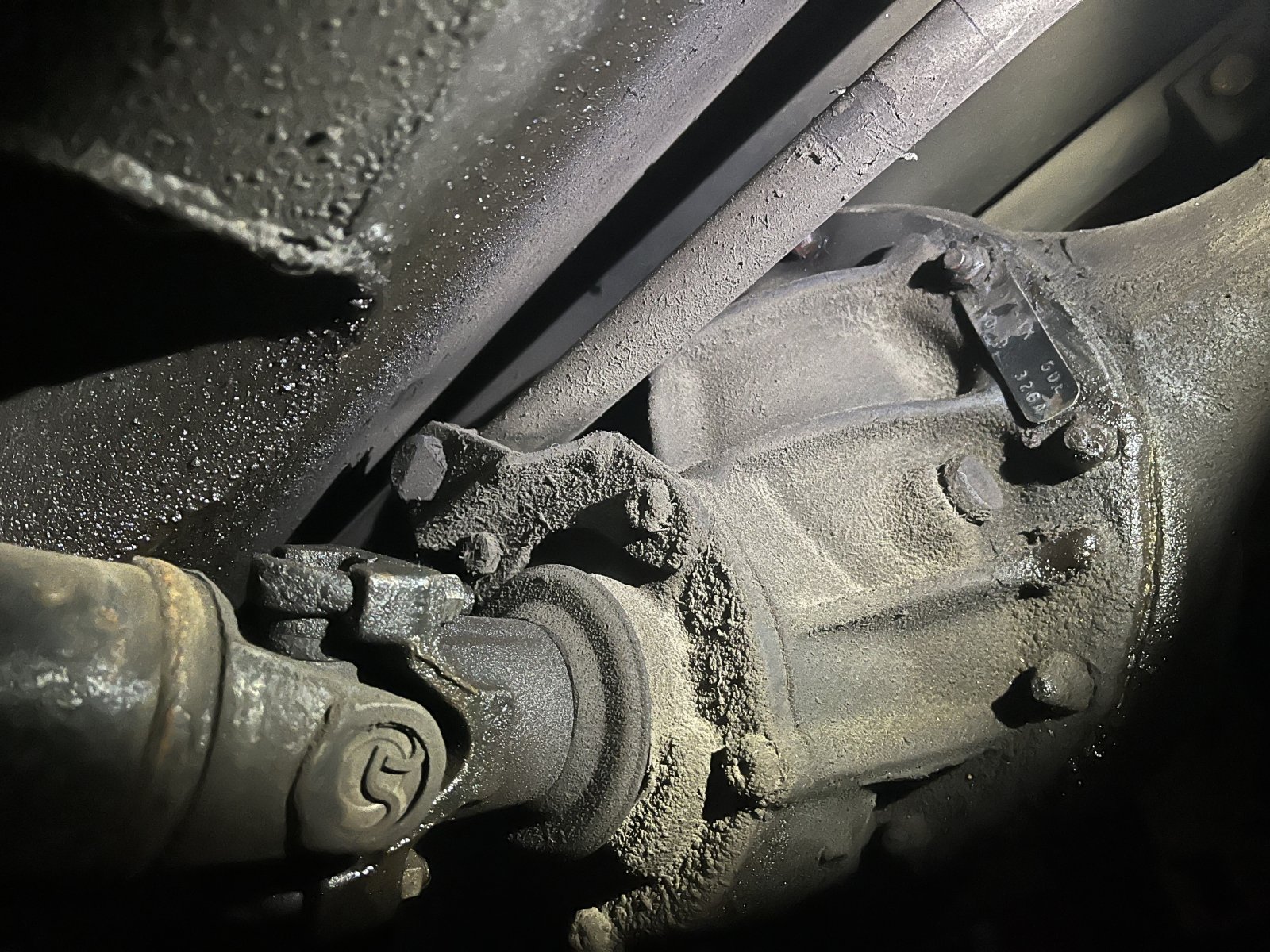

    IMG_0260.jpeg Can someone help me identify this rear end please. I bought a car and don’t know what this is.

    Well for starters it's a ford rear end. The tag will tell what gears .
    What kind of car did you buy?
    Clean the tag so we can read it better.

    looks like a 9" ford. And it sure is hard to read the tag...
    looks like it's leaking around the pinion nut. They need either a new nut, or sealer on the splines, when ***embling.

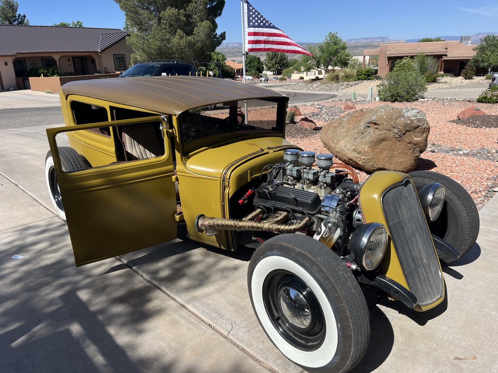

    Bought a 1930 model A. But i dont know much about it because the previous owner didn’t know much about it.

    Are you sure it’s a 9”

    If I were to go to a parts store what year and model ford had this particular 9”?
  9. Need to further decode the tag
    A hub to hub measurement can help
    The housing looks to be pre 73

    The part of the tag in yellow is the part that tells what it's out of. I can't quite make out the letters.
    But yeah, it's a 9", it, says so.
    3.50 9
    and it looks just like one, too.
    if it says WDM-AK, then:
    WDM-AK Ford F100 Pickup 73-78 3.50 9 in NL 31

    Thanks everyone. I have the information now to order parts for it. Couldn’t have done it without you. Take care guys and be safe out there!

    Beware that it's really easy to swap parts on these things, so double check by appearance/dimensions that you are indeed ordering the correct parts to replace what's on it.

    That bracket bolted to the top of the pinion support is an aftermarket mounting tab for a panhard rod connection to locate the housing in the car..
    Makes for an awful short bar and results in a larger amount of side-to-side travel as the suspension goes up and down. It would be better to have the mount on the housing out near the opposite sidehousing end, so that the bar is twice as long and travels in less of an arc.

    Fill plug has be scratching my head

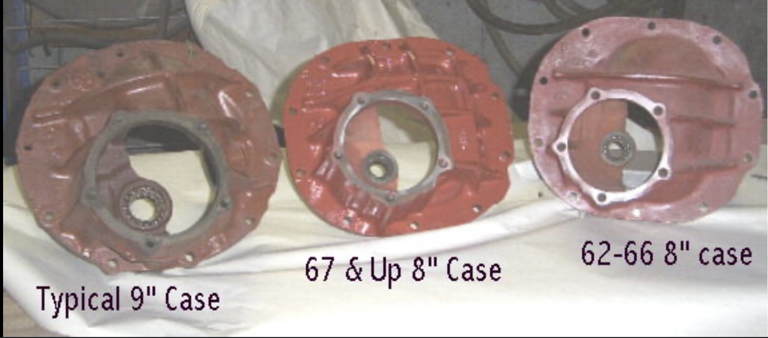

    9"-v-8". 8" is flat on top and bottom by comparison. Check the axle flanges to determine bearing size. All retaining nuts are easily accessible on an 8" but one isn't on a 9". Appears to be a 9"
