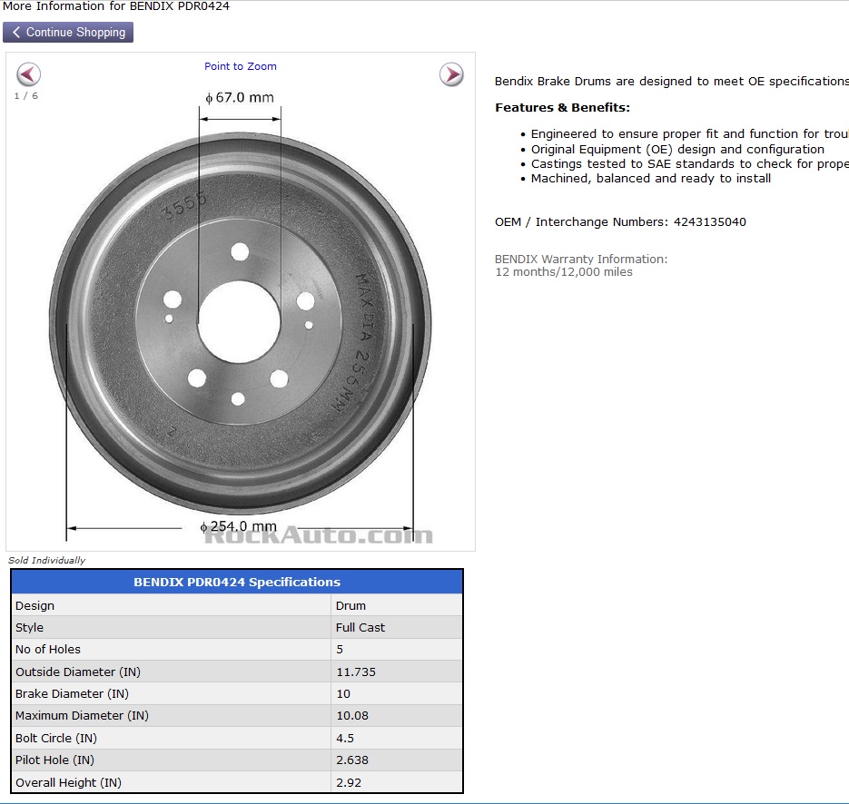

    The axles have been redrilled to change the bolt pattern, what is the original bolt pattern?
    It's not a Chevy rear, it is most likely a Toyota pickup.
    It looks like you have the adjuster spring, is the spring missing on the other side or something? do you really need to replace them?
    Do you have the old drums? to measure and take a picture of? or do you have dimensions?
    rockauto is pretty good for looking up the dimensions of drums that you suspect might fit it, so you can compare.

  8. yes the spring is missing on the other side. And yes its a toyota rear, but what yr and what did it come out of?
    I can't seem to find the correct spring I've checked Rock auto,
    I also figured out its a chev bolt pattern.
    I think a 1957 chev drum might work from Rock auto.
    But I need that brake adjuster spring.
  9. I believe the drum has to be wider than 10" plus the bolt pattern on my axels are 5x4.75 not 5x4.5
    there were no drums that came with the car.
    there was no brake parts that came on the rear end drivers side

    It is very clear that these axles have been drilled with the Chevy bolt pattern, and the studs installed there.
    Measure the bolt circle on the 5 empty holes
    You will find that to be 5-on-4-1/2".
    It is a 2WD Toyota pickup rear end.
    You will need to re drill new drums to get them to fit.

  12. Measure it
    easiest drum is drilling a Toyota drum
    You can look up a casting number from a wheel cyl to help ID
    Numbers on shoes
