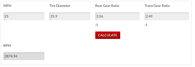

  1. I used a calculator, and it says 25 mph (what i shifted at) should be about 2900 rpm, to me 2900 sounds way too low for what it sounded like, i thought i shifted in the high 3000 range.
    any thoughts?

    I never heard that engine go over 2500 rpm....but then again, it's a really*****py video, and I have no idea what point in the video you're even talking about ! :)
    seriously, how about a time stamp so we can know what you're referring to?
    A tach would be a good thing to spend a little money on. I have a few old tune-up tachs that have both a low and high range, and you can connect it and set it in the car to see what it shows when you're driving.
    Also the numbers don't lie, if you know what the rear gear ratio is, and you've calibrated the speedometer (a phone app works for this) and know the tire size, you can find the RPM at a specific speed in high gear.
    heck, there might even be a phone app to figure out rpm using engine sound.
