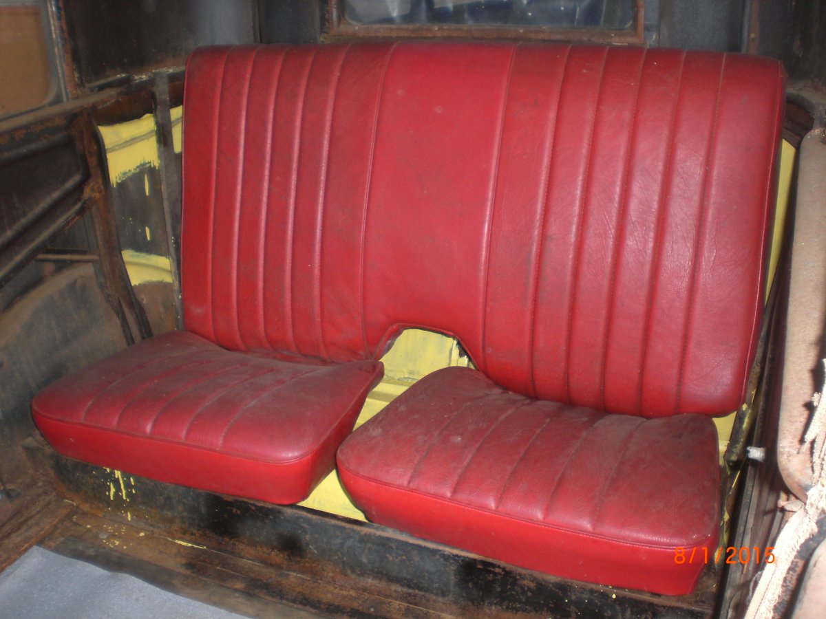

    I stuck a 1980 Camaro rear in my 30 TuDor, seat back fit well and the two bucket bottoms left room for a center console if you want one. they are sitting there in the photo.

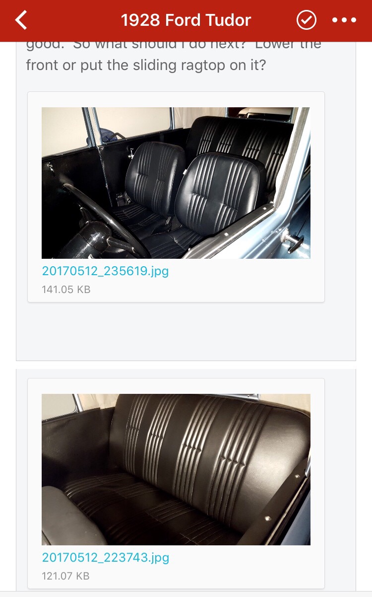

    PT Cruiser Front. Dodge caravan for rear.
