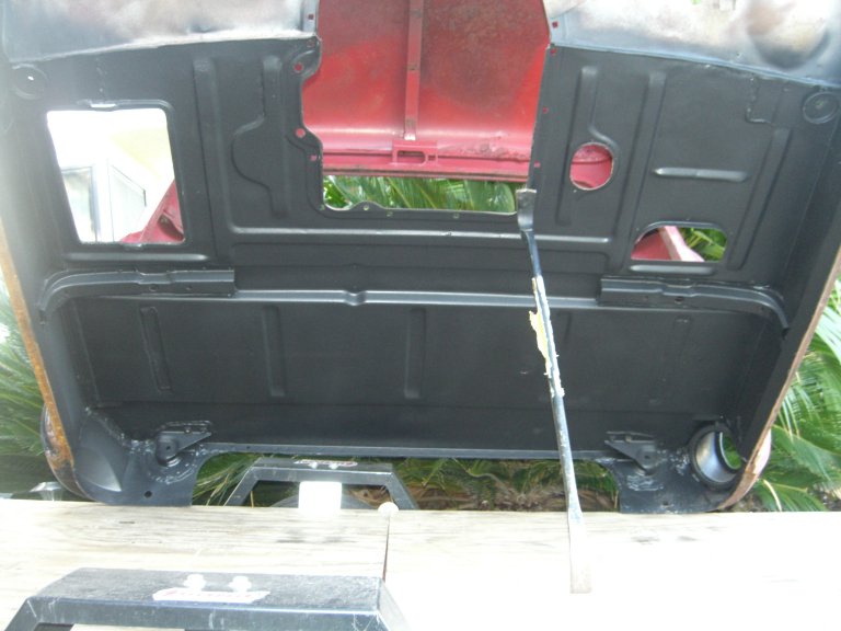

    Here is a pic of the underside my F100 cab...sprayed the bare metal with 2-part (2pak) epoxy primer and then sprayed about three coats of rattlecan DupliColor bedliner over it. This may be the perfect solution for you...durable and it will match your paint scheme.

    Chuck how long did this take you to do. Can you pm me the brand name of the epoxy primer? I appreciate it. Donald
