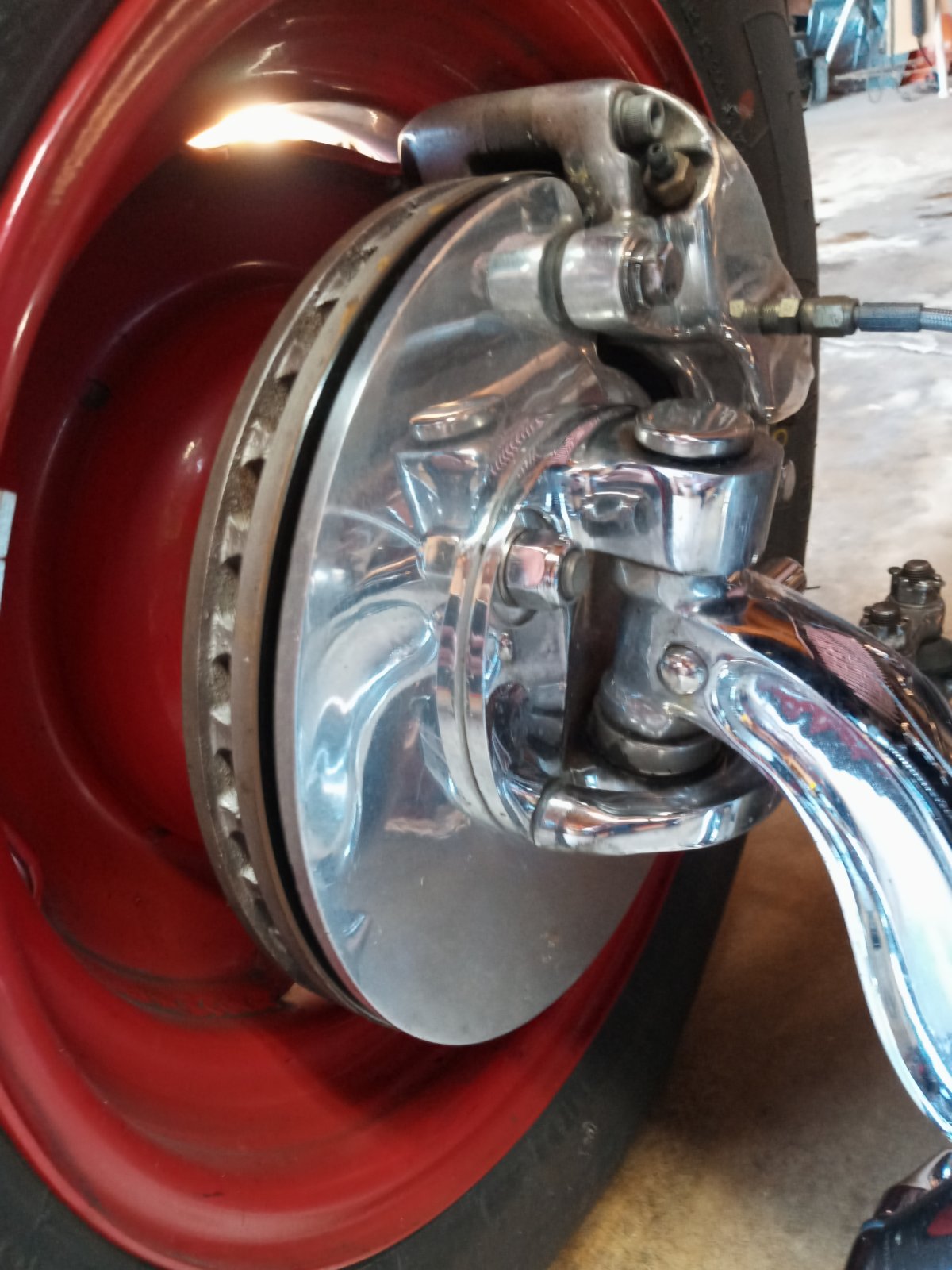

    The front brakes on my Model A are 11" with Metric GM calipers. Got the kit from Speedway. Pretty standard stuff. Wheels are 15 X 5 dual pattern (ugh!) steel wheels.
