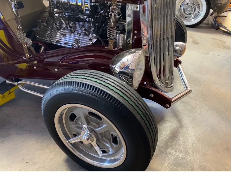

    These are 560x15 DB Auburns on 5" wheels on my roadster and the same tires in WW on my truck in the background, also on 5" wheels. They are 25" tall.
