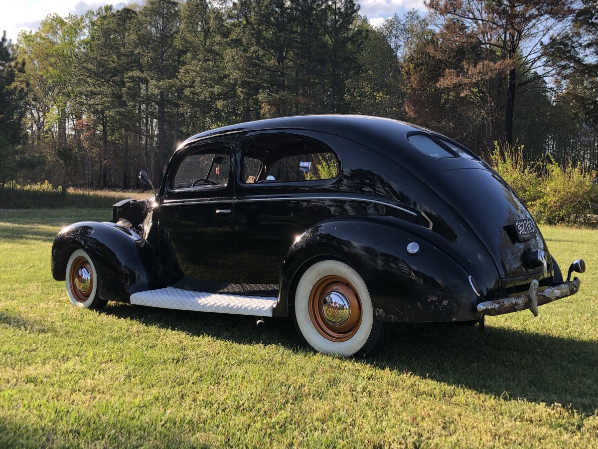

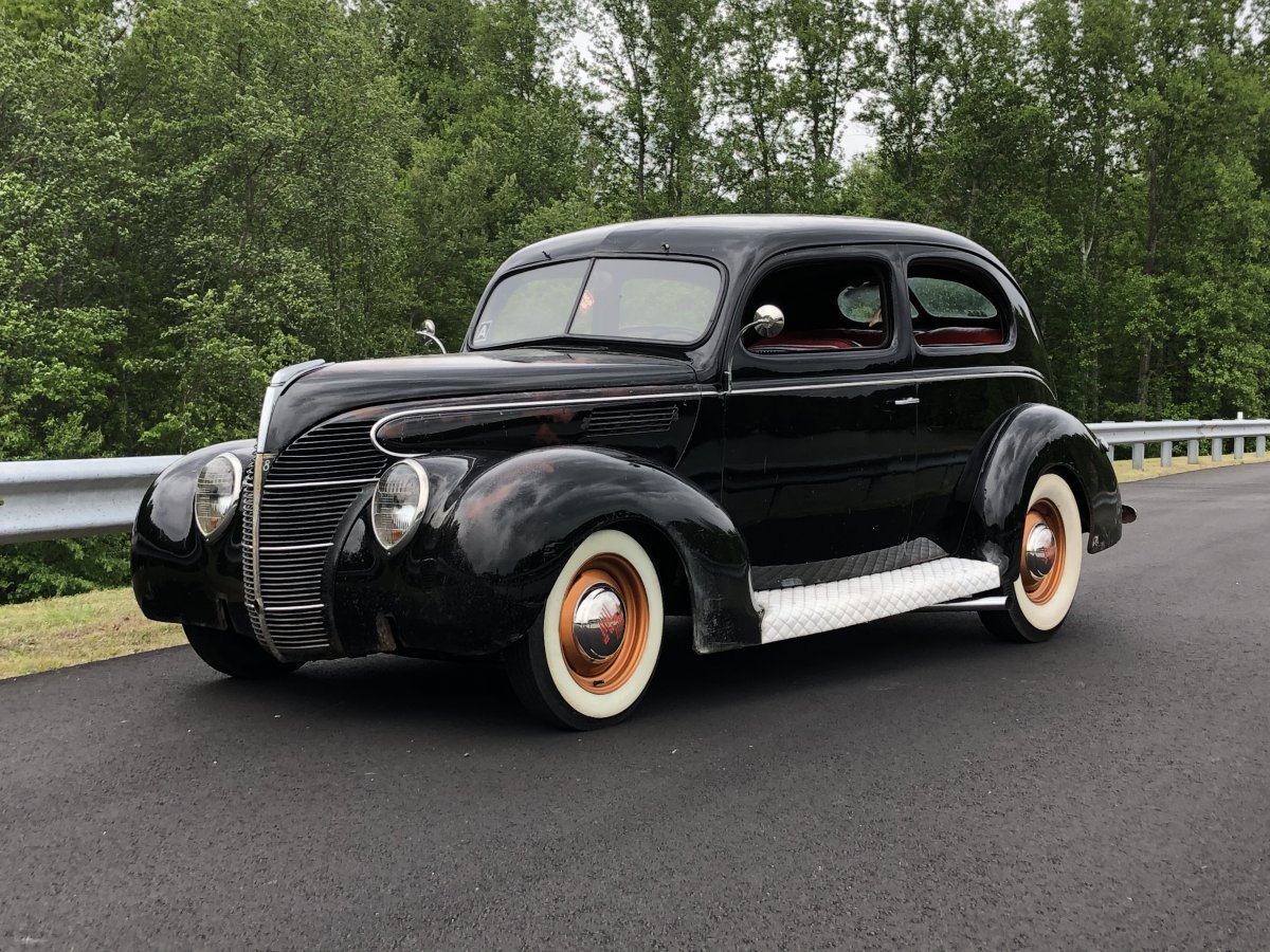

  4. he tires below on the rear of my 39 are 7.0 16 Firestones on original for 16 X 4.5 Ford rims.
    D6CE843B-9E7F-4352-BBAD-4EF7705BF8D4.jpeg 196FCEB1-A955-4D72-B597-8B7B14356B7D.jpeg IMG_2501.jpg
    jim snow, alanp561, Tim and 1 other person like this.

    Note: Looking at the 39 above, the fronts look so much better than the rears.
