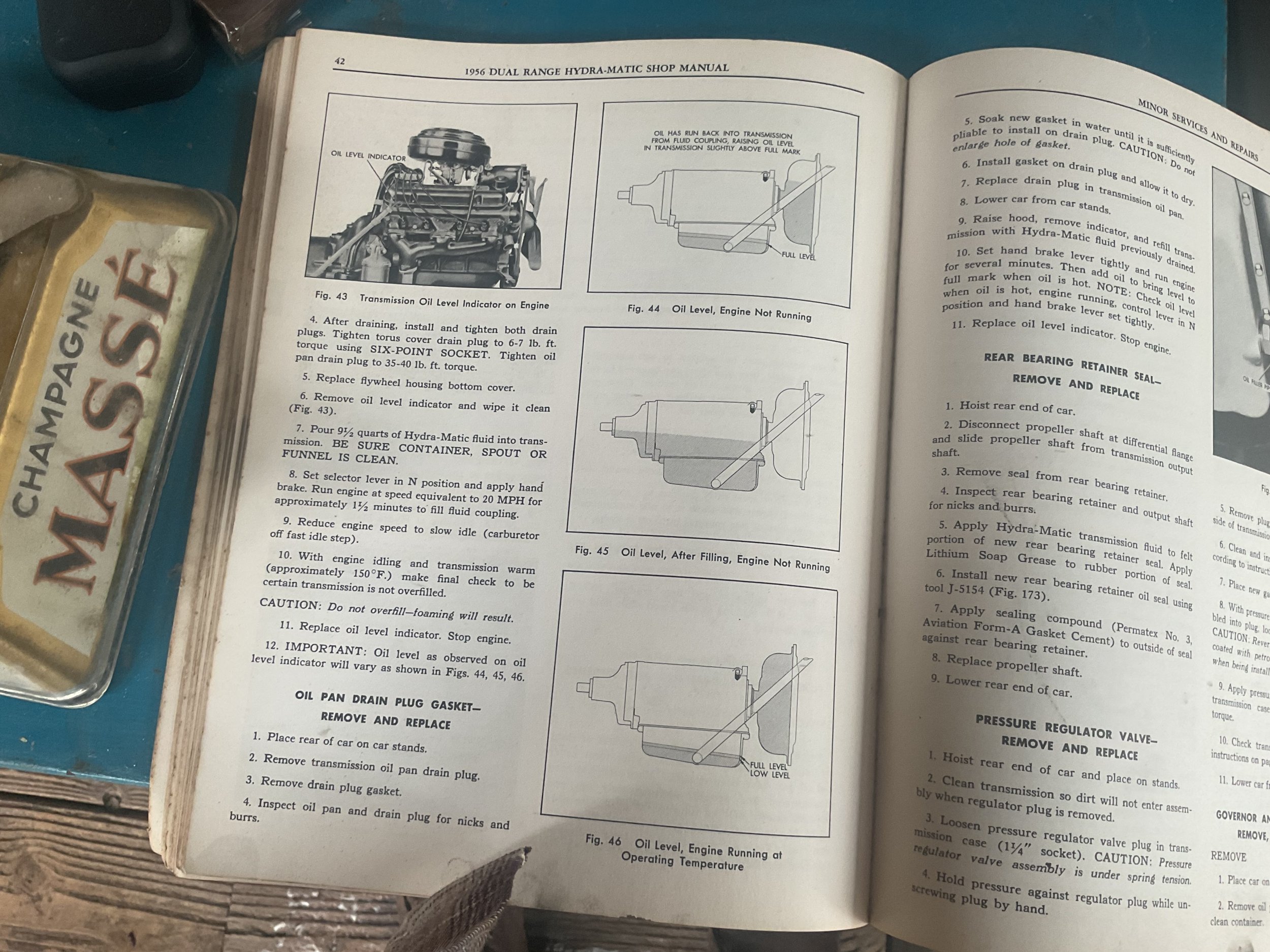

    Since I’ve been elbow deep in a Hydramatic I’ll put my 2 cents in. No, I would not flush the entire transmission but I would drop the pan and try to clean the bands with brake cleaner WITHOUT loosening or taking them off. You don’t want to open that can of worms. If the bands are saturated with oil or grease they will not be able to properly grip the clutch drum ***embly.

  21. ekimneirbo
    Joined: Apr 29, 2017
    Posts: 5,390
    ekimneirbo
    from Brooks Ky
    If you just poured the oil in, and didn't start the engine, you only have it in the pan to whatever level you filled it. Maybe the bottoms of the components got some on them, but doubt it was full enough to flow inside the components. The suggestions to remove the pan and spray cleaning fluid inside sound like the best solution, and do it a couple times depending on how it looks inside. When you refill it this time, might want to put some fluid in the torq converter as well.
    Sharpone and RodStRace like this.
  22. skooch
    Joined: Feb 7, 2007
    Posts: 754
    skooch
    Depends on how much fluid was added. These transmissions take nearly 10 quarts. Torus is filled by warming transmission up and shifting gears.
    Sharpone likes this.
  23. ekimneirbo
    Posts: 5,390
    ekimneirbo
    from Brooks Ky
    Good post and pics. As you say, it depends on how much he put in the trans...........so Sean, how many quarts did you put in it? My guess is that you maybe poured a quart or two in, because I can't imagine too many people that have 10 quarts of rear end oil sitting around.....tho I guess you could have just purchased a case of the wrong oil. Hopefully it wasn't 10 quarts. :)

  25. skooch
    Joined: Feb 7, 2007
    Posts: 754
    skooch
    Yes, that is what happens when you try to fill these without the engine running. Unfortunately 6 quarts is enough to wet the clutch band material.
  26. ekimneirbo
    Posts: 5,390
    ekimneirbo
    from Brooks Ky
    So, its a good thing that he tried to fill it without the engine running, because that means it wasn't being pumped thru the trans....... only laying in the pan. In @skootch book diagram (fig 45) it shows that if filled fully (12 qts not running), the fluid would fill the trans pan and slightly less than 50% of the trans case. If he only put less than 6 quarts, it would appear from the diagram that the trans pan would be full and if any of the fluid rose to a level to touch the trans parts.....it would only be minimal at the very bottom of the parts. I admit this is speculation on my part, and only the op can tell us just how high the fluid left a telltale (if any) on the parts above the bottom trans surface. At any rate, it appears that there is a chance that little if any of the fluid got to the actual transmission parts. A full pan would also give an overfull indication on the dipstick. So there is some hope there.
