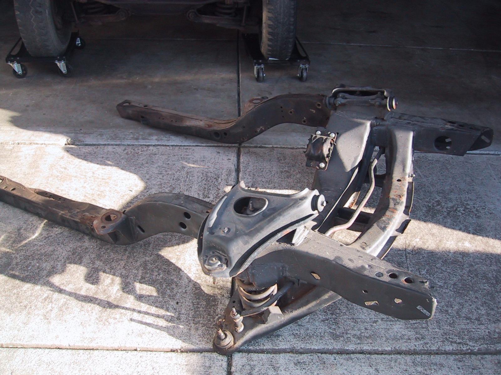

    If you don't want to do the mustang II swap either a 64-74 Nova or 74-81 Camaro would work just fine. Check you local Craigslist. I have one I'd give you for free but you'd have to figure out a way to get it from Cali. There are a ton of aftermarket parts for these. Airbags, dropped spindles and what not. I'm putting a Camaro subframe in my 49 Cadillac now. Here's a picture of the freebe.

    I used a HQ Holden which is very similar to the Comaro of the late 60's early 70's from what I can gather. here are some pics. Its not that hard and seems to work fine. Sorry about the pic its not that great.
