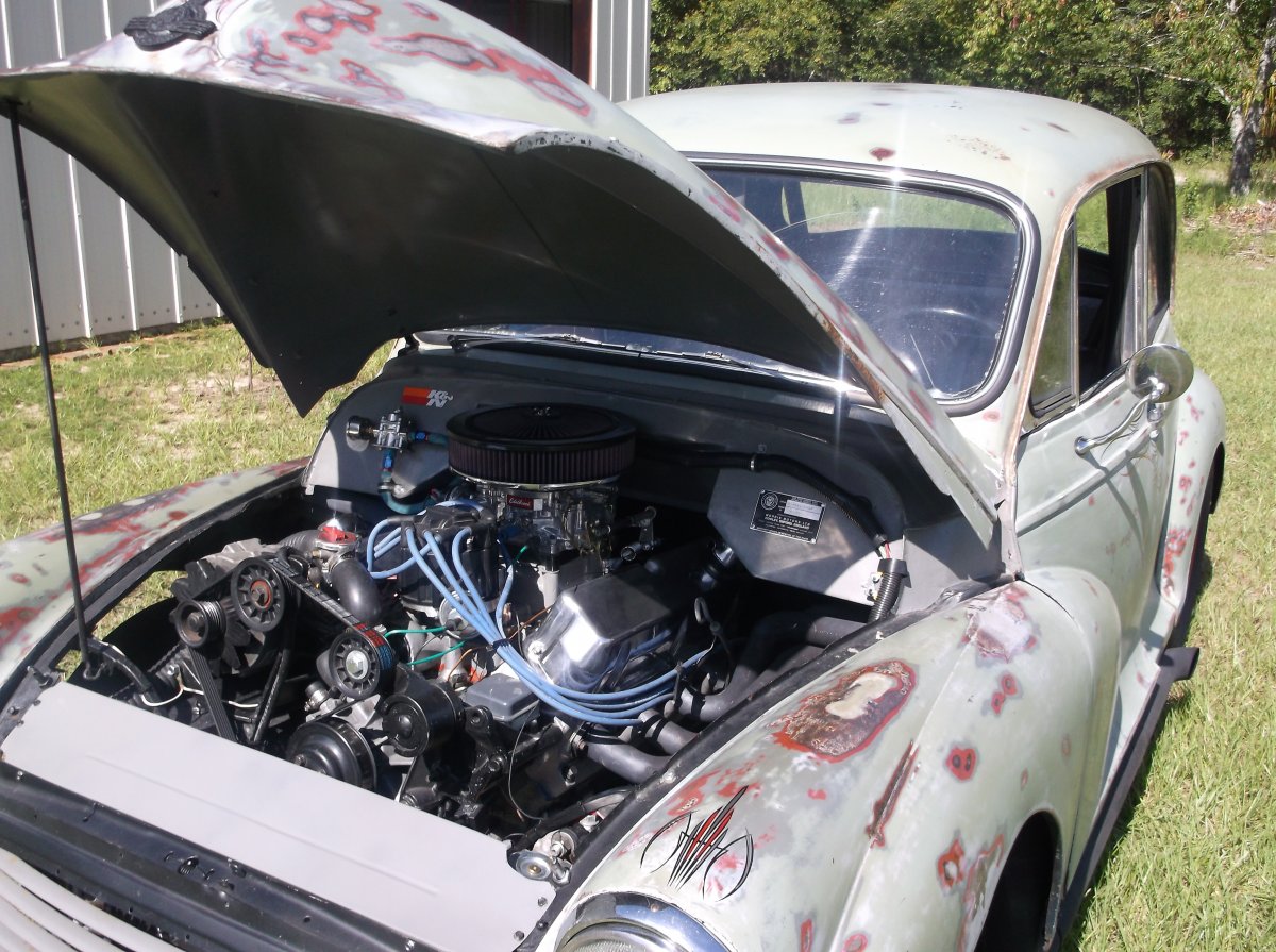

    Ran a 180 in my 5.0 powered Morris Minor with a Lincoln radiator and a electric fan on a temp sensor turned on at 140. No overheat issues in Florida in the summer in traffic. It ran around 185 all the time. Pro Comp aluminum heads , .512 Comp roller cam . flat top pistons. DSCF0938.JPG
