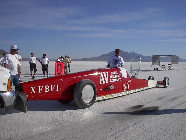

    I've seen a lot of Ford flatheads in my time, but never one quite like this. I found it at Bonneville and to say it piqued my curiosity would be a gross understatement. I know that there was a lot of machining done inside the block and valves moved but I just can wrap my head around what's going on below that deck. Does anybody know what the inside of that block looks like? I need to figure it out so I can finally get a good night's sleep.
    -Rob
    AND NO, IT'S NOT A CADILLAC!!!!!

    Yes, but it's not. It has the exhaust ports on the sides filled, the block wasn't big enough to be a caddy, and the new baron heads are only for fords. it is most definitely a ford.
    It can't be. Nostalgia classes are limited to original production blocks- you can't even run one of the french simca blocks. oh, and spots where paint had chipped had rust. :D

  8. The above is correct, it's called " Valve Reversal " .

    It looked like a ford at the front of the motor....valve reversal was my first guess, but I didn't know for sure.
    If you were there, why didn't you ask?

    I asked, but was told, "don't worry about it." lol

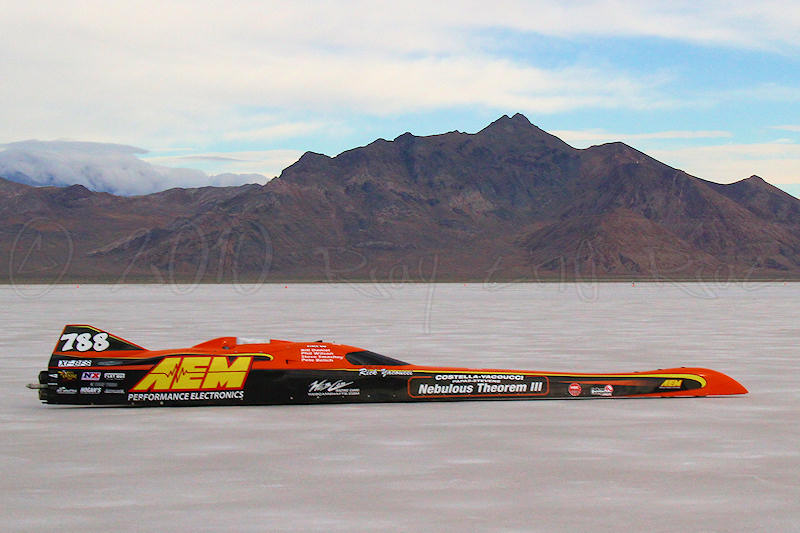

    I don't believe Jimmy Stevens engine or the engine pictured, which I think is his, is reverse flow. The engine that Dick Landy built for Ron Main is. But Jimmy's engine uses the original intake ports and has cut welded new exhaust ports. It went 309 in the 788 Costella-Yacoucci streamliner
