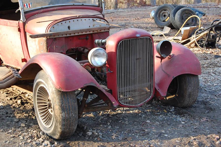

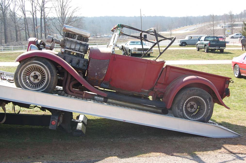

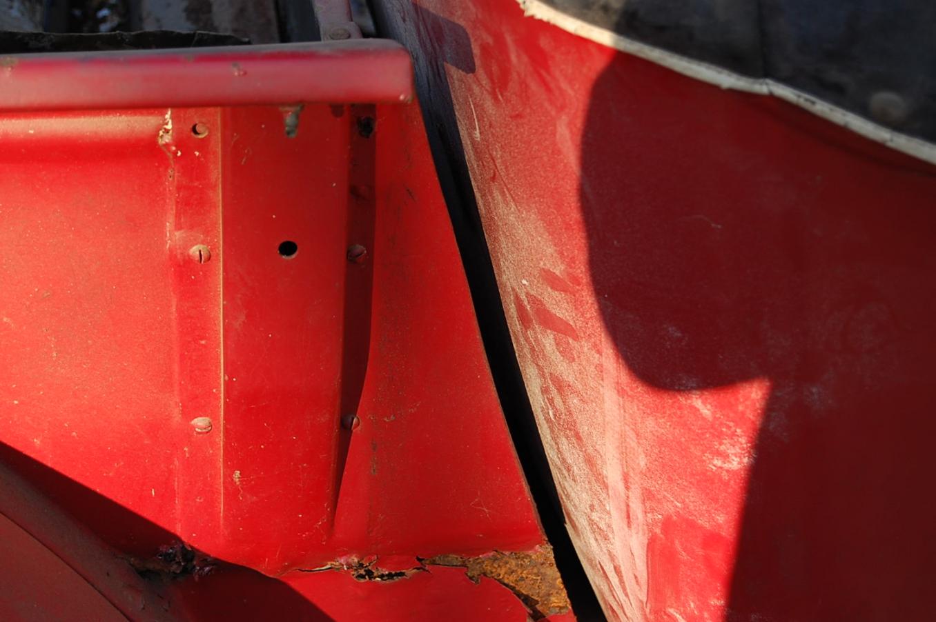

    I got this a while back. The guy said it was a 28 ass end, a 30 roadster cab and a 32 front end. Please let me know what all you think it is. Also what year is the top frame?
    Thanks for all the info.

    That is REEEEAL intresting...You might notice that you don't see too many of those engines floating around...
    Great score, do you have any details?

    the boss 429 engine is worth more than the truck but the truck is cool also

    that thing could be really cool, 32 grille/fenders, 28-9 cab (touring back section) the pics kinda show up weird but that might be a 31 wide bed on it.

    oh man...it has a boss 429 AND a blower.
    that thing is sah-weet !!!!!

  10. It is a 28/29 RPU doors and cowel with the rear section of a 28/29 touring. looks like some one did a pretty nice job on it at some point. Think real hard. You've seen this done before. Hint: Barris built it, and Brizio restored it.

    28 29 roadster cowl with doors. Suspect the back half of the cab is from a phaeton. Definately a Model A box but it has been modified. The rear fenders are Model A and look like they might be glass. The front fenders are deuce. Any pics of the frame???
    It would be great if thing was sitting on deuce rails. Can't believe anyone would use A bones with that 429.
    Pretty interesting. Does it run???

    Oddly enough, your truck is so era specific it is like a time capsule. I would, forgive me, restore it to it's former glory. I would even keep the hurricane wheel. They just fit with the top bows and the other mods. It certainly screams 1971 to me. Love it. An amazing score.

    Looks like Cragar blower with the snout and arm but on top of a 4x2 intake. Sell the blower for good money and put the funds back into the truck. Cool truck

    !932 Ford fenders, 28-29 cowl and doors, back paned may be a modified touring car rear section (bent moulding beads match) Bed may be 26-27 T, or else they made filler pieces to fit between the front of the bed and back of cab. Top bows are 28-31 Ford Standard roadster, the 28-29 RPU top never folded. Need more photos of details to be sure. Nice find.

    Now THAT'S funny... it ain't nothin' but a stock barn find Ala Kart!!

    Holly Shit!! That thing is 100% WICKED!!! The exhuast is beautiful, and of course so is the BLOWN 429!!! You've got a nice piece there, I would just restore it back to it's former glory, but I would find a better 70's Wheel, maybe Ansen Mags or Cragar SSs....or Tru Spokes...WIDE Tru Spokes!!
