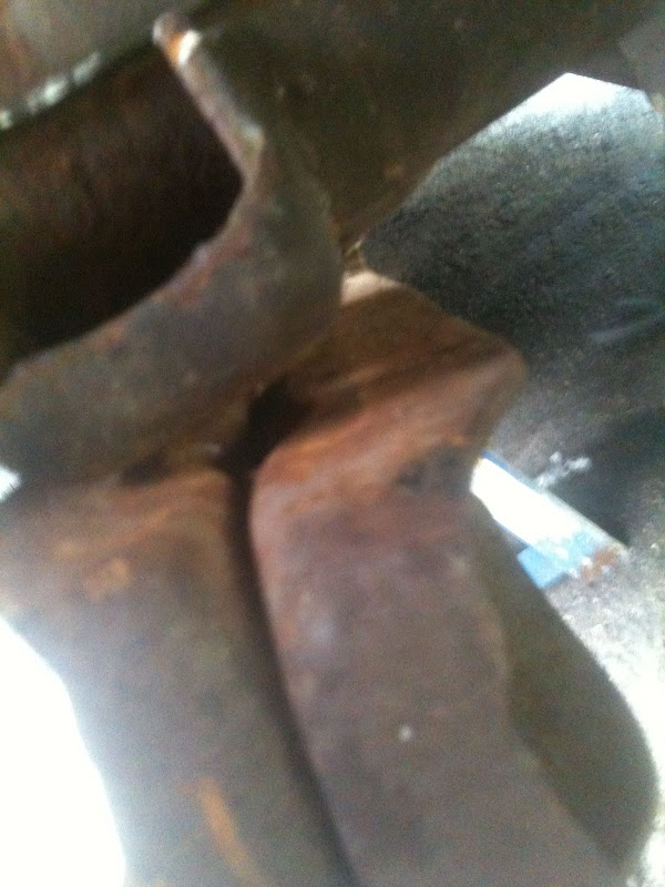

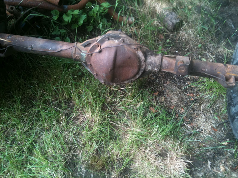

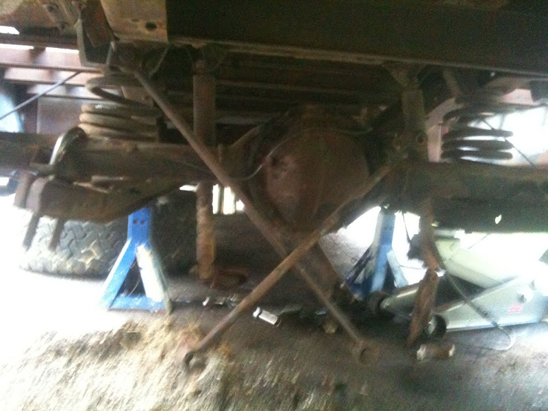

    ok so i posted some pics here: http://neverwintercycles.com/autos-1963-c10.php and ill post some here as well. note the gap in the drivers side between the trailing arm and the axle pad. obv nothing is tightened down but i am wondering if that twist is causing things to be off? i measured the axles and the stock is actually wider between the lips of the drum backs. the stock measured 571/4 between them and the 71 measured about an inch less.
    the last pic is the stock axle.

    Measure the width of rear ends where the wheels bolt on, that's the measurement that will be wider on the newer rear end. The brake drums are wider on the later model, so the inner measurement will be shorter.
    When you are swapping the rear end on these trucks, it helps to support the truck on jack stands that are placed under the frame, not the trailing arms. Then the trailing arms are free to move to where they need to go to bolt to the rear end. The way you have it supported, the trailing arms are holding up the truck, so you can't move them as needed to fit the rearend.

    yeah that dawned on me as i was taking those pics - i need to resort the jack stands. will do that tomorrow. i am really hoping its an 1d10t error (idiot on my part) by not jacking things properly. i tied to measure the spacing but couldnt get an accurate read so i am going to try that tomorrow as well. do you think pehaps loosening the bolts at the other end of the trailing arms to give them a bit of slack may allow me to get them into place to where the axle pads are in alignment? i will try to sort it again in the am. thanks for the help.

    Yes, do this. The arms might want to hang down too much, so you may need to hold those up slightly with a block on each one. That might keep them more stable if you don't have a helper.
    Those arms are designed to be twistable, so uneven jacking or a spring pushing sideways a bit, can twist the arm. If you still have the twist after trying squirrels advice, borrow a huge pipe wrench. Drop it over the top to pull down, which will twist it straight, while you get the U bolts through.

    WHOO HOO i am an idiot. what a total dolt. so all i had to do was jack the truck up by the frame and NOT the trailing arms. 5 mins i was done. now on to the next challenge: coupling the driveshaft to the 71 pumpkin. the 63 driveshaft is different so i am trying to sort what makes more sense: swap the connector pieces on each pumpkin (basically put the piece from the 63 onto the 71 so that it mates to the 63 driveshaft)). or swap the 2nd leg of the 2 pice driveshaft from the 71 onto the 63. as usual i am prob overcomplicating it but i am ahppy i discovered my own idiotic problem!
