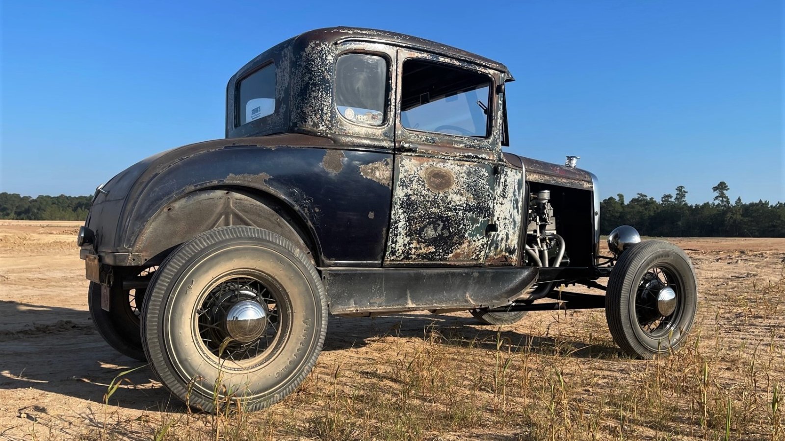

What the hell do I do with this?
Discussion in 'The Hokey Ass Message Board' started by Raddad, Apr 3, 2023.

    Don't know why you couldn't get it close to where you want it with 10K for the upgrades you want and some subtle changes. As said, be sure and keep and catalog everything you take off......in case you want to change horses mid stream. Hell, you could even brush paint it (search for threads on that on here) to finish it off.
    This one is close to having the same changes you're talking about.

    Finish what your dad started - get it running and on the road and have some fun tinkering with it and driving it around. I'll bet it won't be long before you figure out which direction you want to go in and whatever you decide to do you'll already have a great start on it.
  7. Your 4 banger is already a flathead, so that's one job done. If you stick to the 4, then you won't really need to beef up the rest of the drive train. The full fenders look nice as a wall hanging, or sell them for some cycle guards.
    The first Ford juice brakes came out in around '39, do a bit of homework as far as fitting them goes, and I reckon these will work just fine.

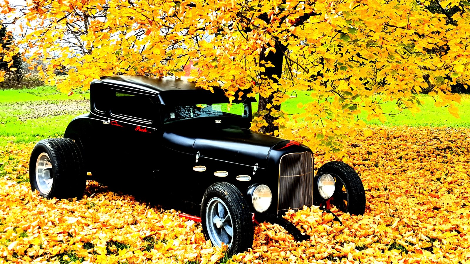

    I'd keep the banger just for kicks. The black car at the top of this page looks about perfect to me. That's exactly what I'd do with it, that's purty.

    Swapping your Mustang to a T5 is a lot different than swapping this to a T5. This has a torque tube, not an open driveshaft. As mentioned, you need to do some research (books/hamb/etc.) on what all the swap entails. Your T5 experience will give you a head start, but don't ***ume it will be the same. Far from it.
    Before you set your sights on no fenders and a chop, get it running and driving and enjoy it some. See how you fit into it unchopped, and whether you could drive it comfortably with less headroom. Some guys tape over the windshield to emulate reduced visibility of the chop to get a feel for it.
    If you're swapping to a T5, adding a Flathead V8 won't add much more work, but it will add work for sure. Do you have the time, skills, and desire to do a full build, or do you want a hopped up stocker?
    Selling a car and buying someone else's build always seems attractive, but it's often not when you do it. Since the whole reason for this car is the nostalgia of his dad owning it, that seems like a non-option from the info we have. The other side of the coin is that you don't know what the car you're buying needs. In many cases, you will spend a lot of time tidying up and improving, whether it be suspension, brakes, wiring, power train, body, wheels and tires, etc. Mostly undoing someone else's mistakes. Most cars need a bunch of work to get it to be what you want, so why not make what you have into what you want and keep the nostalgia?
