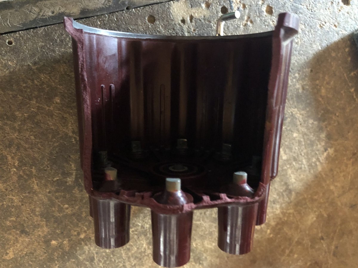

    Drove the roadster last week and ran perfectly all the way home and into the garage, no issues at all...no odd sounds, stumbling, NOTHING to rouse any su****ions of any kind.
    Decided to pull the hood off this morning to some cleaning of the engine department, and found the dizzy cap busted wide open. It was violent enough that the broken section of cap slammed up against the firewall hard enough to make some major league scratches in the paint. The broken piece was laying on top of the transmission bell housing.

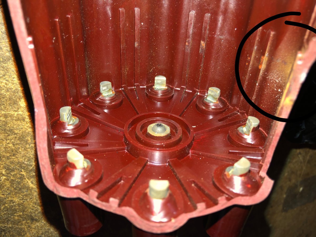

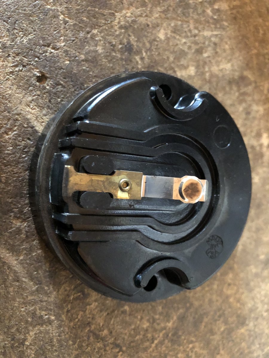

    The rotor hold down screws were both real loose and both indicating ***s were broke off and stuck in the weight ***embly. I can see no damage inside the cap and all 8 br*** ***s are flawless in shape and condition as well as the rotor as viewed from the top side. There is a burn spot inside the cap which I circled, but thats the only issue I can see. 253CEC51-C921-401F-A36D-DDBF2B70B596.jpeg D5ECD476-7FEB-4198-A27F-E3E717F47D0D.jpeg B233061D-EE69-4B5F-891B-12153445804B.jpeg 1539636A-11FB-426B-8F74-6CE3D7865662.jpeg
    Now I had a similar thing happen 30 years ago to a 318 that instantly started running real ****ty and before I could get it pulled off the road it threw a rod out the side of the block...found that the distributor had some slop in it allowing the rotor to move up and down and had caught one of the distributor ***s which broke the plastic that held the rotor pointer allowing it to spin about 45 degrees retarded, but the distributor cap was damaged at one of the ***s and it was painfully obvious what had happened.
    But, back to my current issue, I can see no damage that may have caused this on this engine. I replaced the cap and rotor and it fired right up as usual and runs flawlessly. This engine has less than 5000 miles and the distributor was brand new. There is no noticeable up and down movement in the dizzy shaft...
    I am a little perplexed as to what happened here. Ran perfectly before and after so this had to happen right as I turned the engine off last time....any ideas?
    68 4 bolt main 350 sbc.

    The leading edge of the rotor looks like may have been contacting the poles, possibly from the loose screws, and also perhaps hard enough to break the cap. asdf.JPG

    was there more than one piece broken off? my guess is a small piece broke, from age, defect or mishandling, and got between the rotor and cap and popped the big section off. I bet it was running like that for a little while. put it back on and video it running.

    Blowby my experience in a situation like your's was that when the rotor contacted the contacts in the cap it broke one of the plastic holders that hold br*** contact in place. Your's does not seem to indicate that, it could really just be a defective cap that was cracked in that are all along. It would run fine with a crack there as opposed to between contacts. It is certainly a mystery.

    Ron, from the pictures I can see the marks at the inner cap points were the rotor hit them. This happens a lot on later model gm products especially vans. the screws come loose and wipe out the cap, rotor and some times take the top plate right of the distributor. Why it ran till it was parked is a unknown....

    Are there any witness marks on the edge of the rotor?
    There appears to be a few witness marks on the inside of the cap at the same level.
    Does that rusty orange mark, that is inside the cap and on the edge of the broken section, also show up on the edge of the broken piece?
    When installing a cap rotor they should be of the same brand/type. Tolerances can get sloppy or tight if mix/matching brands.
    Had an OT HEI MSD rotor that wouldn't work with an HEI ACCEL cap, or vice versa. Rotor was physically smacking the inside towers. Could hear it on cranking. Was being super lazy and didn't want to change the cap(wire/coil/ground strap/blah blah blah).

    well...i suspect the loose rotor was in fact the problem and if the cap was cracked, it wouldn't take much...I only found 1 piece that had broke...the piece with the access window is gone...it did damage the firewall, i think the metal window actually dug into the firewall. that section of the firewall has a small layer of bodyfiller and it dug thru the paint, bodyfiller and down to the metal. ive touched up the firewall, replaced everything and seems all is well....takin it out tonite, so may find out...hopefully not
