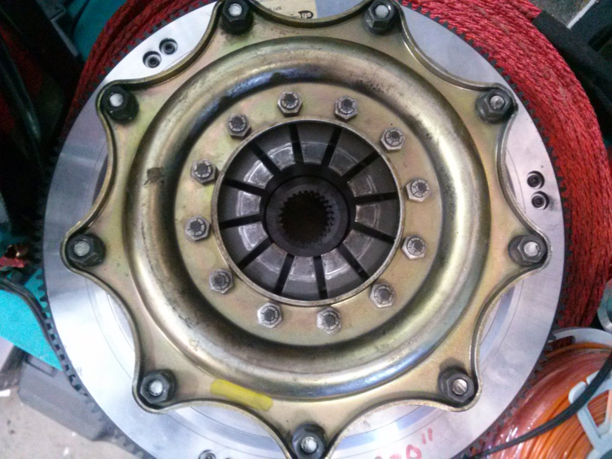

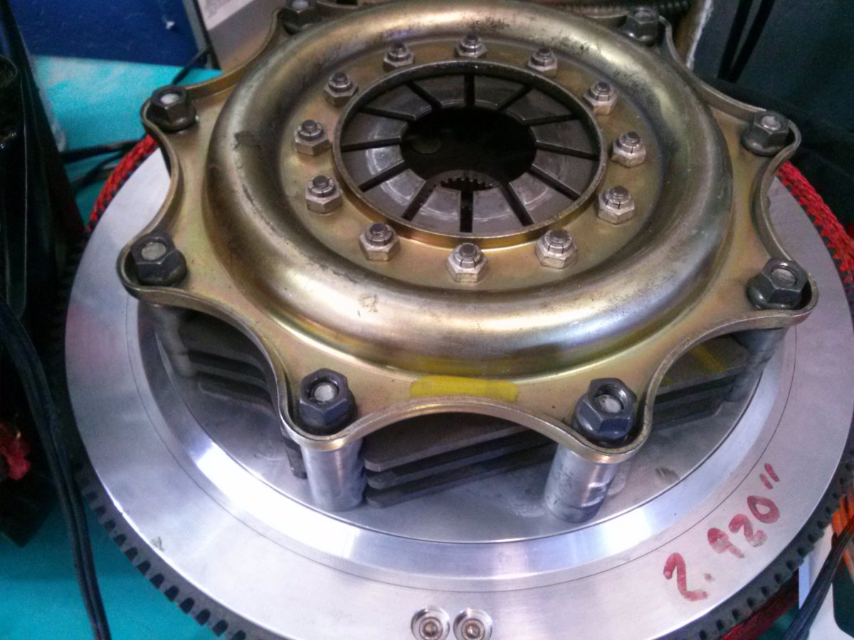

    clutch 2.jpg clutch 3.jpg clutch 4.jpg corvette clutch.jpg clutch 2.jpg clutch 3.jpg clutch 4.jpg corvette clutch.jpg I have this clutch in my 1962 corvette. I was told it was suppose to be a rear quick and hard grabbing clutch. It is the hardest clutch I have ever pushed on. The pedal is so hard, that it feels like I am pushing the thrust bearing through the block. Yes it disengages and hooks up, BUT why so hard to push. I have never heard of a clutch being this hard to push. what the hell.

    It may be your t/o bearing is pushing too far away from the tips of the fingers. Less leverage.

    From the marks on the fingers, Panheadguy may be correct. Looks like the diameter of the TO bearing is too big and pushing in the middle of the pressure plate fingers, instead of toward the outer ends. If a smaller diameter TO bearing was used it would drastically change the leverage on the PP fingers and reduce the pedal pressure.

    Both guys are right, you might have a t.bearing for a B&B clutch rather than the diaphragm unit you have now.

    And make sure the TO bearing has a radiused face, not a flat face.

  11. Multi disc race clutch and probably better suited for hydraulic throw out bearing. I got to say to must have a lot of motor in that plastic wonder car.

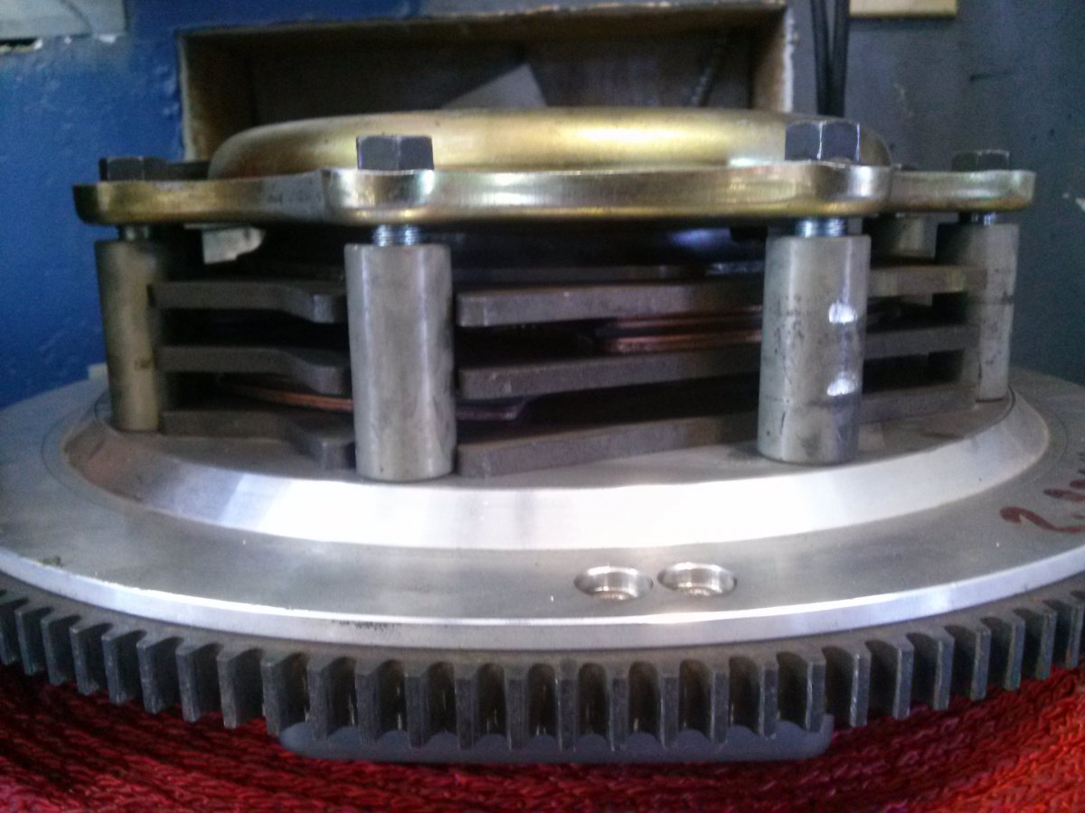

    A multi-disc clutch actually can get by with *less* pressure. Because the friction surface is so much greater area with the multiple discs. On regular single clutch, and high power, the way to get more power transferred without slip is to use a high force pressure plate. But a multi-disc clutch does not require that.
    Agree that it seems your throwout bearing is pressing on the diaphragm fingers too far out from the center. That makes the pedal force higher than it has to be.

    Ask who gave you the info on the clutch in the first place? Ask which TOB and how much movement is required at the bearing and you can adjust your linkage to get the needed amount..Multi-disc clutches don't have to have lots of pressure plate pressure because of the multiple discs; more surface area..
