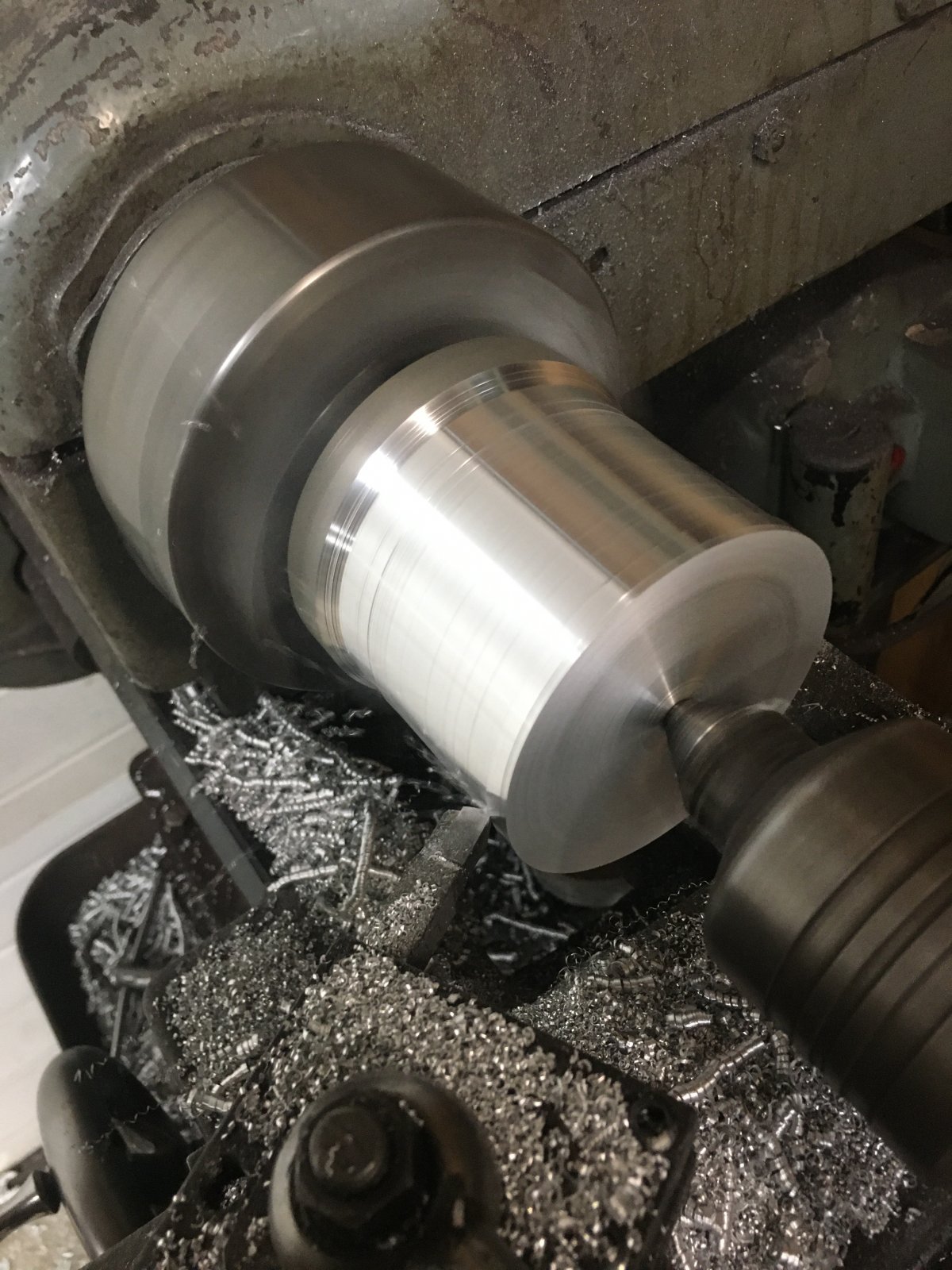

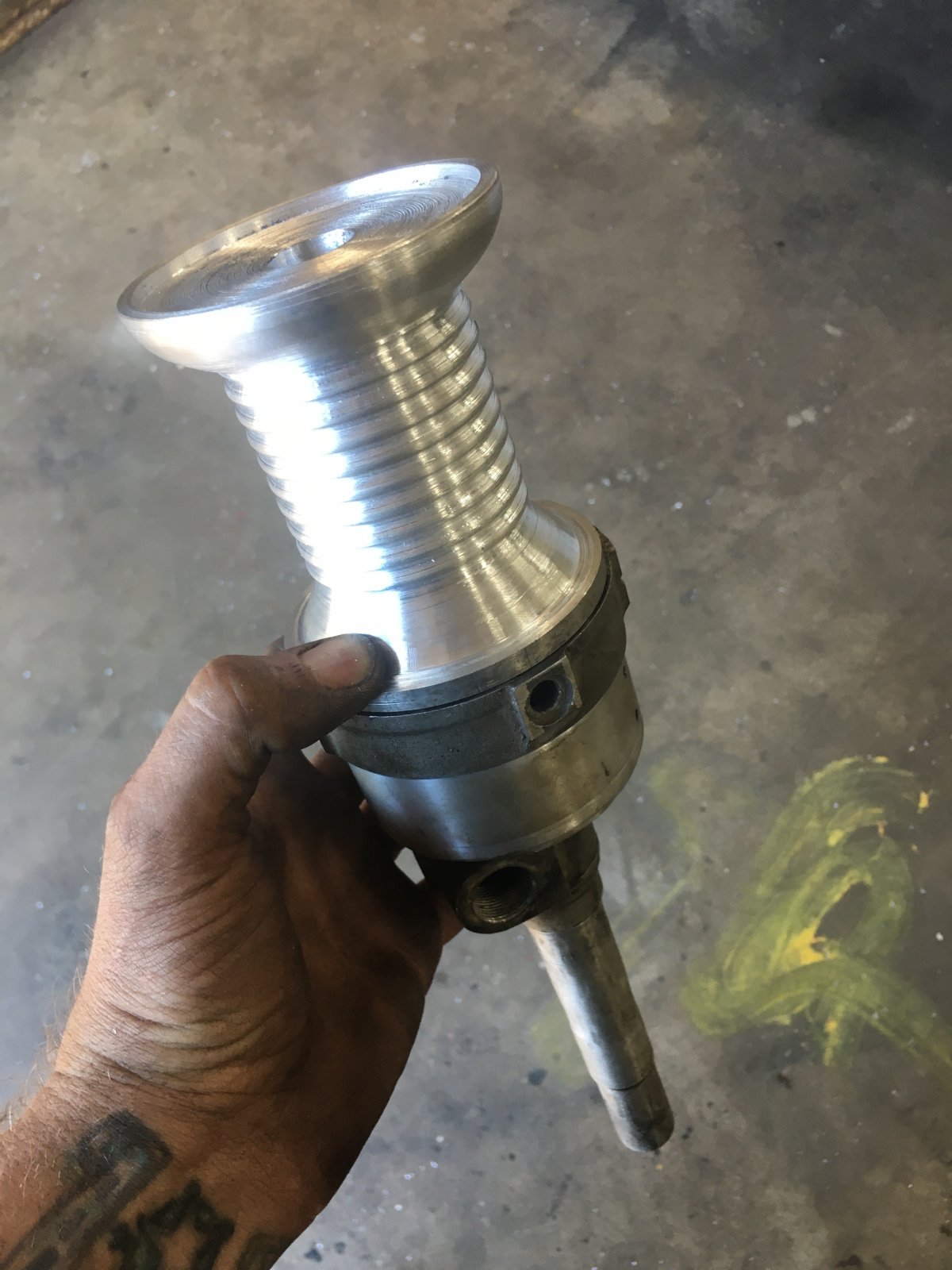

    thunderbirdesq
    Funny you mention that, I’m using a Mallory base with a four lobe cam to build a one-off dual cap/dual coil ignition system with mechanical tach drive for my injected ardun engine. Kind of a poor mans rotofaze…
