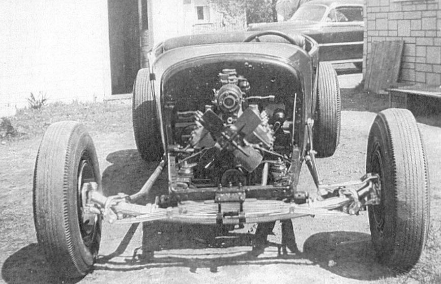

    Anyone got info on this gem

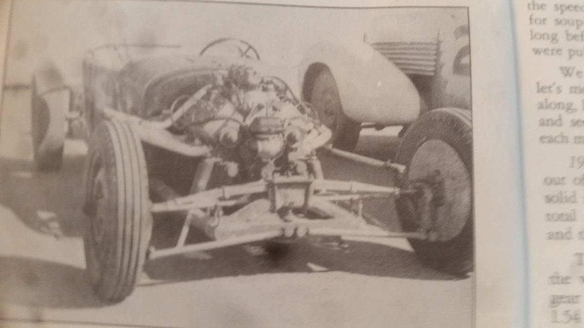

    the picture came from a hop up book by Clymer . 51 or 53 . tube ch***is too.

    I would like to see more pictures......

    tube shocks, IFS, underslung, no front brakes that I can see, flatty powered, air cooled,
    I'd paint "blasphemy" and the number 666 on the door. Probably has cup holders :cool:

    The front suspension makes my head hurt, have to look away.o_O

    Same car??? Sure looks like it.

    Looks like a "T" frame swapped end to end to achieve the under-slung effect, transverse leaf spring on top of cross-member.

    :eek: ......Yeah!! We got No Tolerance for independent thinkers here!! or.....errr 'there' either.......:D
    (Looks like inspired by Studebaker 'Planar' suspension design...from late '30s, only with the spring on top)

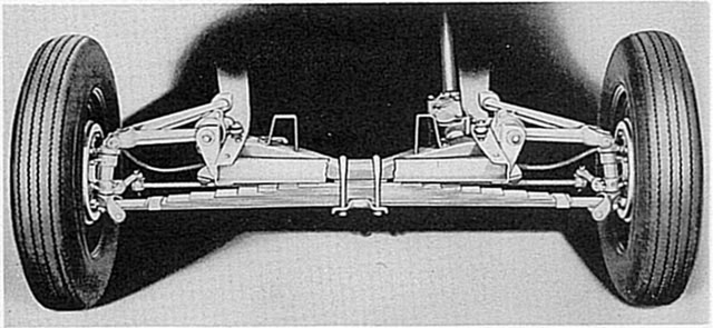

    PlanarSuspension3.jpg might be some Studebaker bits in that front suspension there.

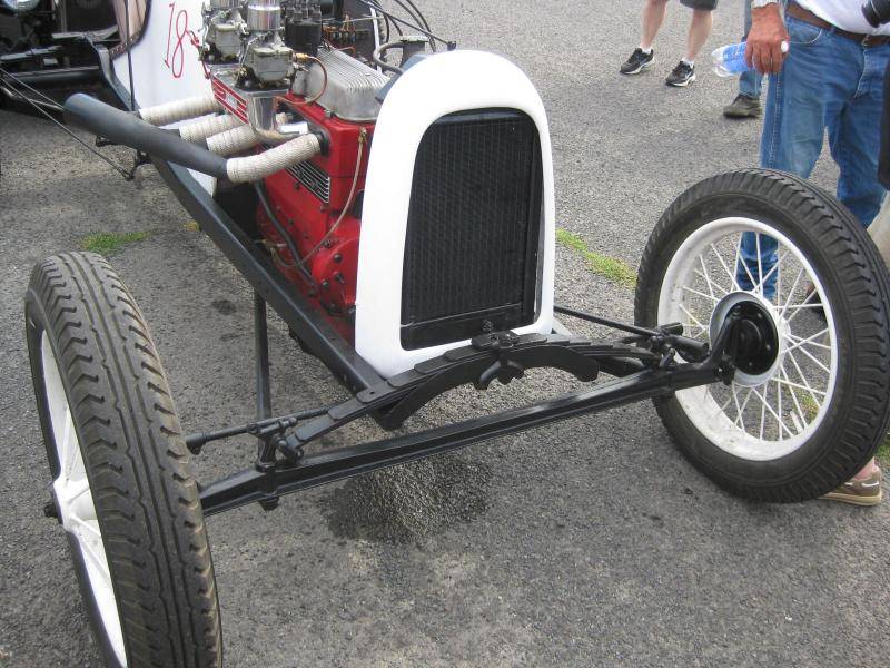

    Looks like a T frame with the front cross member flipped over...thats what I did with mine..and the rear of the frame is z'd and I used a piece of another T frame for the step so that it all flowed together ...and and I know about the steering ...it will be on the back side when finished....and no the frame is not flipped or swapped end for end ...springs are T axles are A.... 20160427_171102.jpeg IMG_20161113_095558.jpeg IMG_20161113_095121.jpeg

    Spring over IFS was common in brit sports cars in the 50s. In fact even the 60s Cobras used it. I suspect the builder of that car had a subscription to Road and Track as well as Hot Rod.

    studebakerjoe's post shows a Planar front suspension, it was also used by Jeep, and probably others as well. A friend had a '49 Willys Jeepster that used that front end.
    The lakes roadster has what looks to be a home brewed variation of the Planar concept, but the Planar has a leaf spring on bottom and upper control arms. The roadster setup looks pretty sketchy but hey, in the 1940's there was a lot of experimentation going on. I'd call it traditional. Heck, it ran at the lakes 70 some years ago on a hot rod, so why not?

    Fordors, im thinking the builder may have flipped the knuckles over to use that spring up top instead of the bottom as Studebaker and Willys did.

    That top photo gives new meaning to the term " SUICIDE FRONTEND!

    Looks like the stude front end above flipped upside down and custom lower arms instead of the original arms. Exchanging stamped arms for tube arms and tie rod end pivots.

    " a successful experiment in sprint car design, this rig has turned well over 120 mph in 1/4 mile, from a standing start. A tubular frame and unique IFS system are featured. Engine is an over - bored Mercury , uses nitro methane as fuel. note the lack of radiator"
    caption
    how to hop up ford and mercury engines

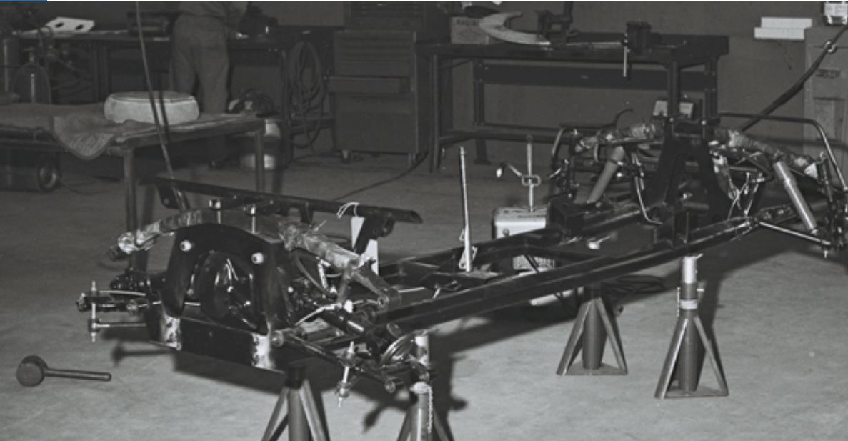

    I posted this in the Friday Art show due to the humorous nose-art on cardboard and while studying it I noticed the front suspension looked independent and being a T it would have normally been a beam transverse sprung front end. This was identified as a Blair Speed Shop entry with Dyno Don Nicholson involved in its construction.
    I would suspect it would have been rare to see this on a Hotrod racer of this type much like Ak's Hotrod above...
    but the pictures elude a pretty innovative entry.
    Perhaps @loudbang and @296ardun
    or anyone else who has knowledge of this particular racer
    may be able to shed some light on what is under that cardboard...

    Rootie you got me snooping with your suggestion of an offshore connection which by the early to mid 1950s when this image is likely period correct to...may have been an option
    My first hit was an Alvis...which had a very similar suspension with origins around 1934...
    I thought despite looking like a possible winner it seemed a little heavier than what we're looking for...and there wasn't any frontal pics to see the lower struts and where they mounted...
    I searched on and came across this...
    https://www.oldcl***iccar.co.uk/speedex.htm
    This is a page of Speedex aftermarket parts for British application to a pretty sizable road racing market which still flourishes even today...
    I suspect in the 50's it was probably available in some manner to North America just as the cars themselves were...
    So perhaps in land speed, racing and even good Ole Hotrod this stuff was in the mix...and Don Blair being around the culture of Racing perhaps saw this suspension and applied it to his own purposes...is it a Speedex unit...I'm thinking it is...they had 2 types one wider than the other...
    There is a chance it's not but it sure as heck looks like it...
    @rudestude and the others suggesting a flipped crossmember are also correct in identifying how this went together...
