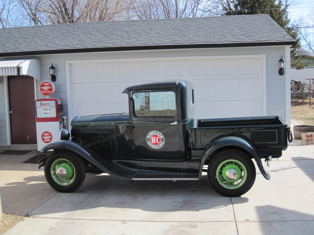

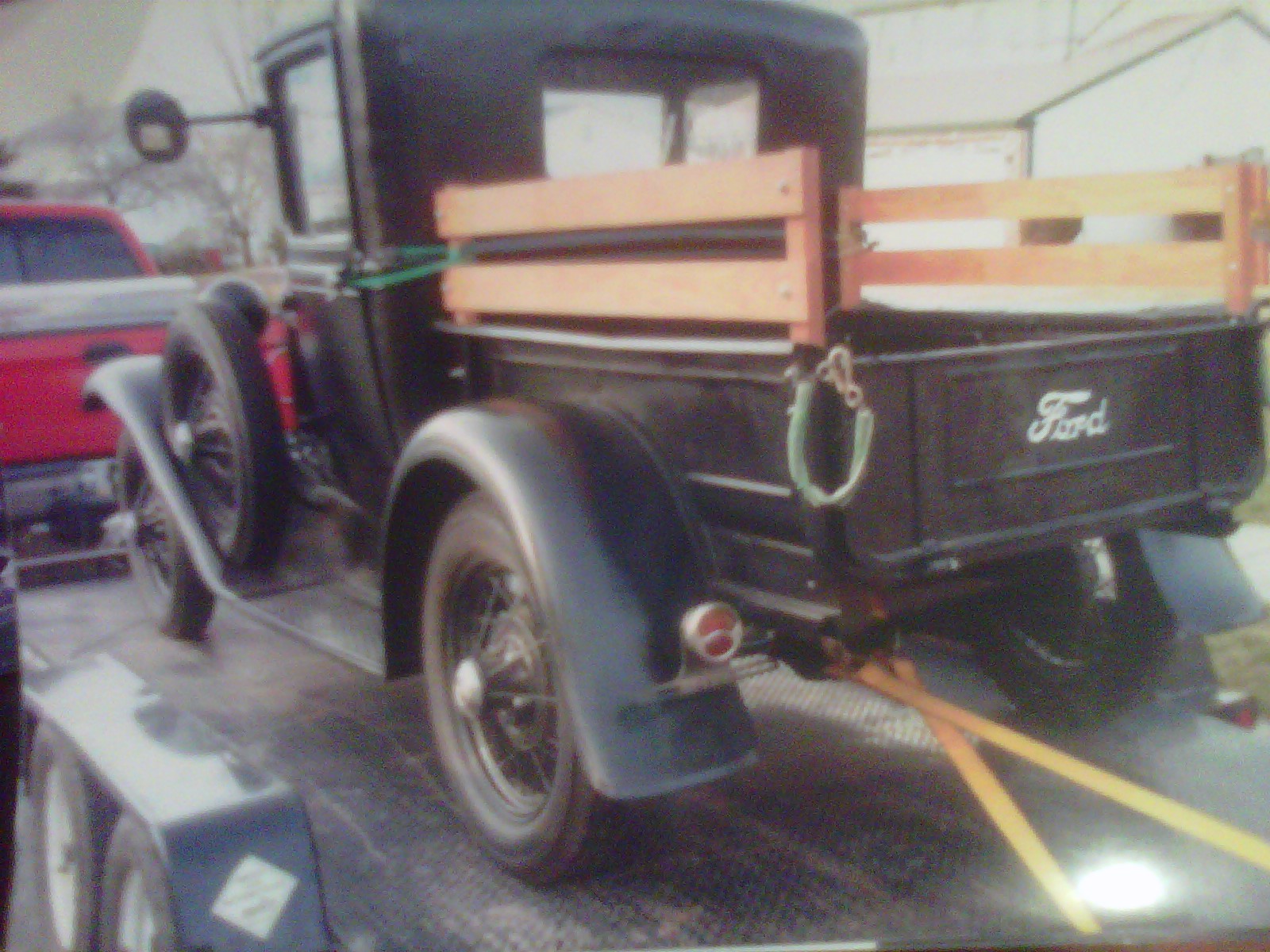

    Nice little truck you have there and it would be hard to hotrod it. There is an Model A Woodie in our group with a 4 banger, a few goodies to add to the punch, a Mitchell Overdrive with 16" tires and he can run down the road 60 mph without any problem. Without knowing what the bottom end of your engine looks like it may not work for your engine. I have a 30 pickup but it was rough when I got it so didn't have to make the decesion you are facing. People in the know swear by the mechanical brakes IF they are in good shape and adjusted right. You have a hard choise to make, feel for you. Below is mine when I got it and after. The before picture doesn't show the rust, dents and tears in the fenders, couldn't use any of them in the build.
  18. 2935ford
    Joined: Jan 6, 2006
    Posts: 3,859
    2935ford
    I have had both stock and hopped up A 4 bangers. To me stock is stock and 40 - 45mph is to slow for me even on back roads. I like the ability when and if I need it to "go around" or just keep up with traffic and not worry about hills.
    The hopped up 4 banger was better but.....nothin like the sound of that V8 flatty out of dual Smithy's!
    The A rear axle treated properly will take a warmed up Flatty. I know several that have them.
    Either way....enjoy what your going to do and have fun with it.
  19. 2935ford
    Joined: Jan 6, 2006
    Posts: 3,859
    2935ford
    Nice work!
