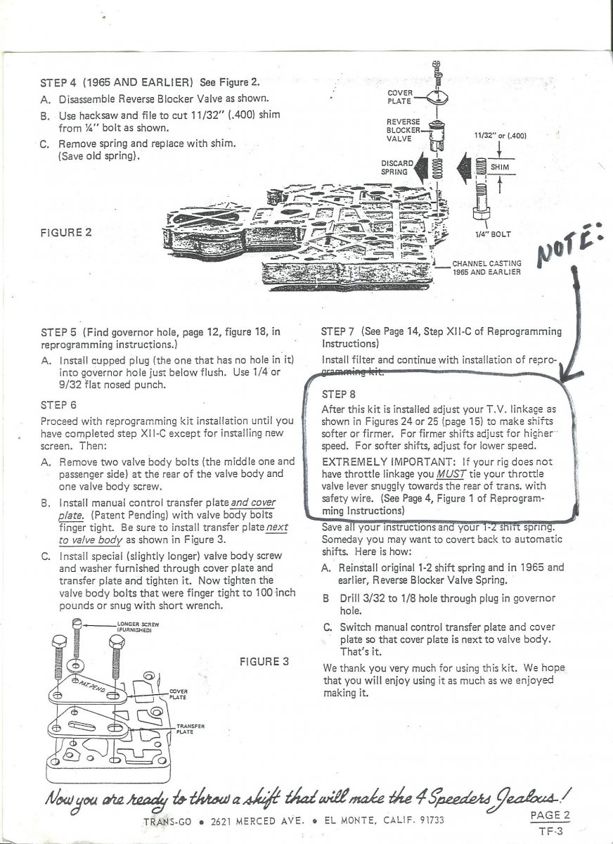

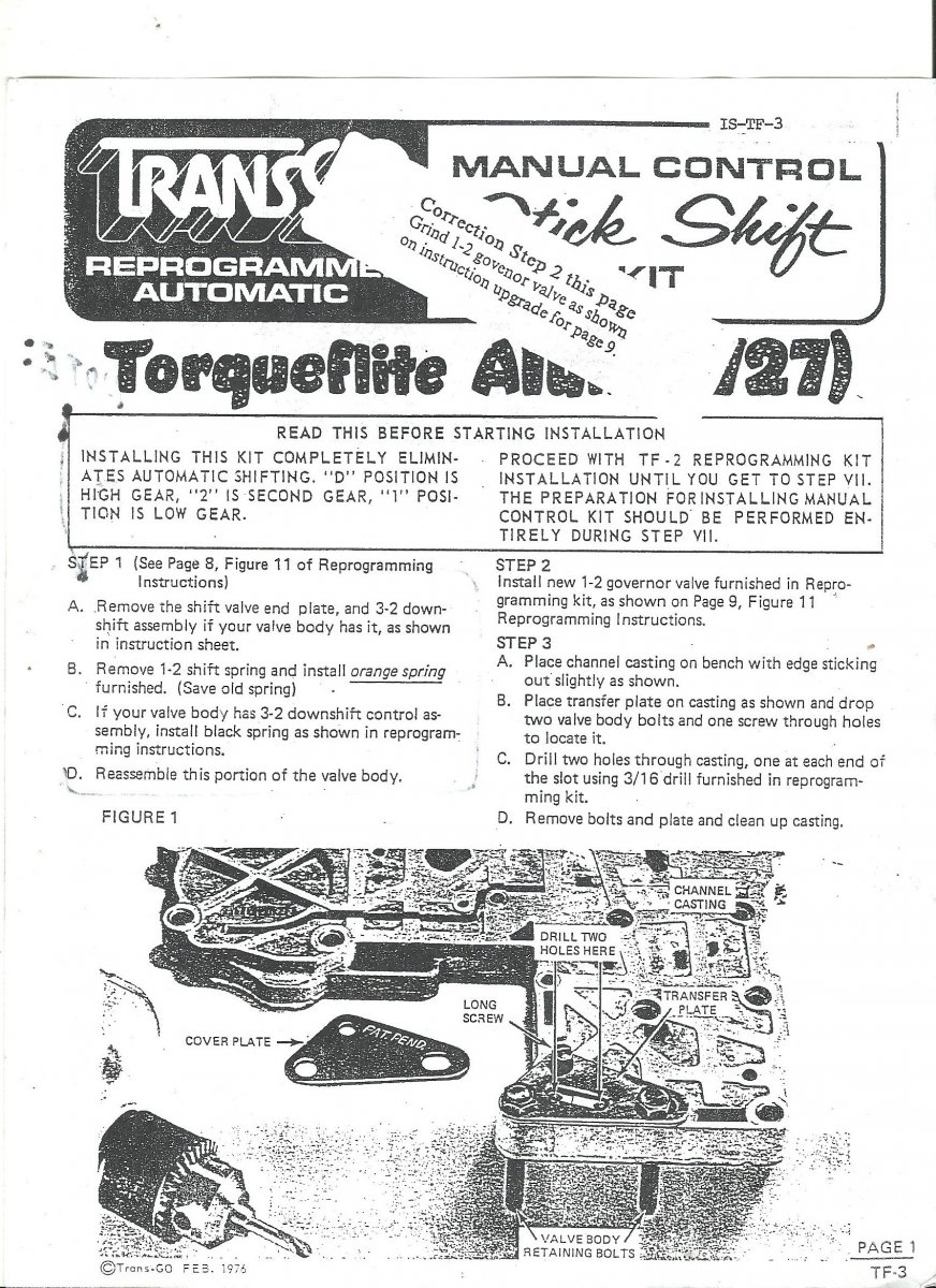

    You claim the builder replaced the valve body with another one. Just what did he replace it with?
    Did he replace it with another bona fied manual valve body, like from TCI, Cheetah etc. or did he install a Transgo "Stick Shift" TF-3 manual valve body shift kit in another stock valvebody?
    YOU HAVE TO KNOW WHAT IS IN THERE!!!!!!!
    We have used the Transgo TF-3 kit many times without issues, that kit is available to trans shops at a discounted price, through trans parts suppliers. Its also a hell of a lot cheeper than a bona fied manual valve body, but there is additional labor time to install.
    Attached are two pages of earlier Transgo instructions for the TF-3 kit, clearly states either the T.V. LINKAGE HAS TO BE HOOKED UP OR WIRED BACK TO FULL THROTTLE POSITION IF NOT HOOKED UP.
    One thing I ran into is Transgo revamped their instructions at a later date and make no mention of the TV issue at all.
    I questioned this and called Transgo, and they said it has to be hooked up or wired back like the old instructions said.
    If this is what the valve body is you are best to call Transgo at (626) 443-7451
    Bill
