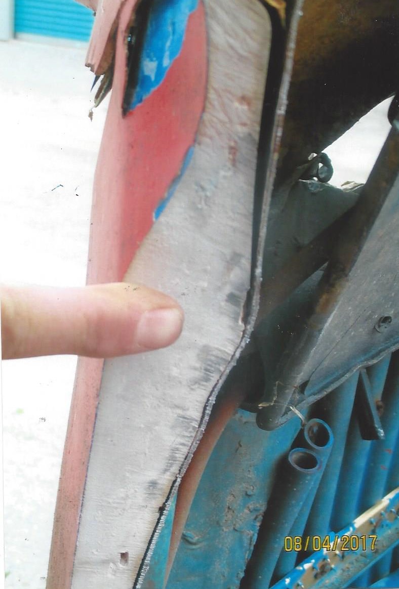

    I'd start by using a grinder to grind off a channel in the filler starting at the cut, and working it up until you know where it ends. Then you'll have an idea at least of how much you've got to deal with. Since there are no doors, or door skins for a '41 Chevy, you're going to have to deal with the lower patch panels, and if they don't go up far enough, you'll likely need to patch in sheet metal to make up the difference. This is going to make the repair even trickier, as you'll have two joints to weld, so twice the chance of warping those big flat door skins!
    I had to do this on one of my '39 Chevy doors, as the patch panel was shy of getting to god steel. I cut more than I needed off, as I wanted a wider filler to control warping. I'm a beginner to major sheet metal repair also, so it was a learning process for me also. I had to tack it all together, and tack in my patch panel too. Then use a long straight edge to check for warping, and had to cut things loose occasionally to adjust the metal and get out issues.
    I've still got some filler in my doors once I finished, which a skilled metal worker would not have what mine has. But at least it's 1/8" or less and I'm OK with that. But I've got so many hours in my two doors replacing lowers that I lost track of how many days, let alone hours to fix them! A pro could have done the same in 10% of the time I took to do it!
